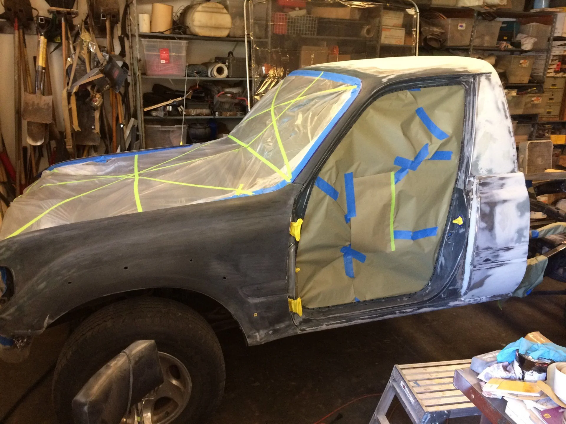

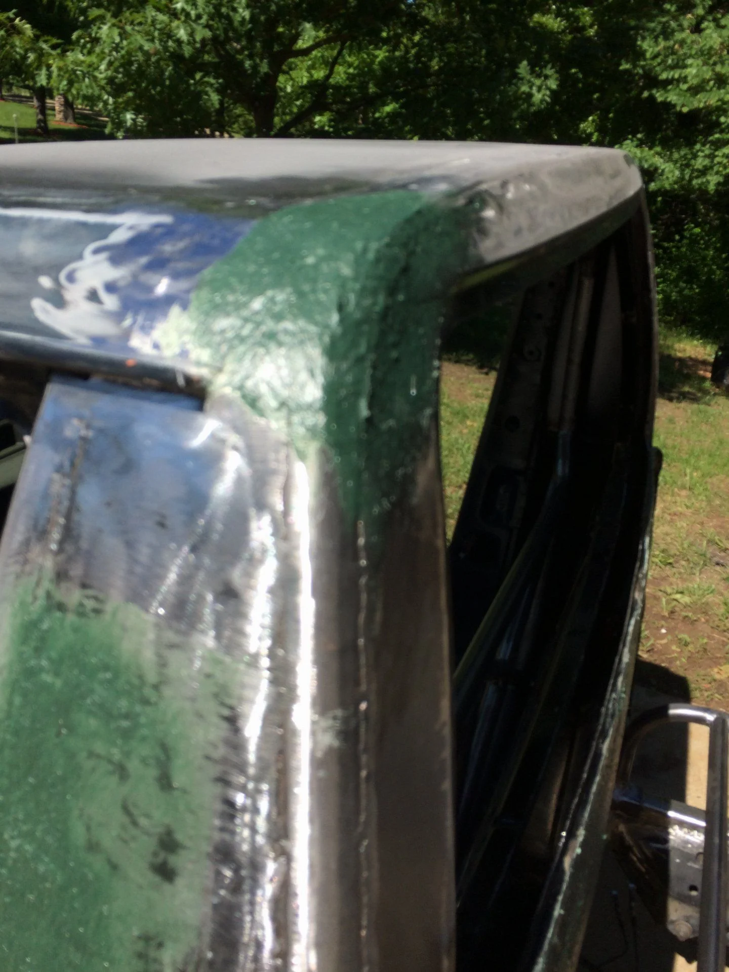

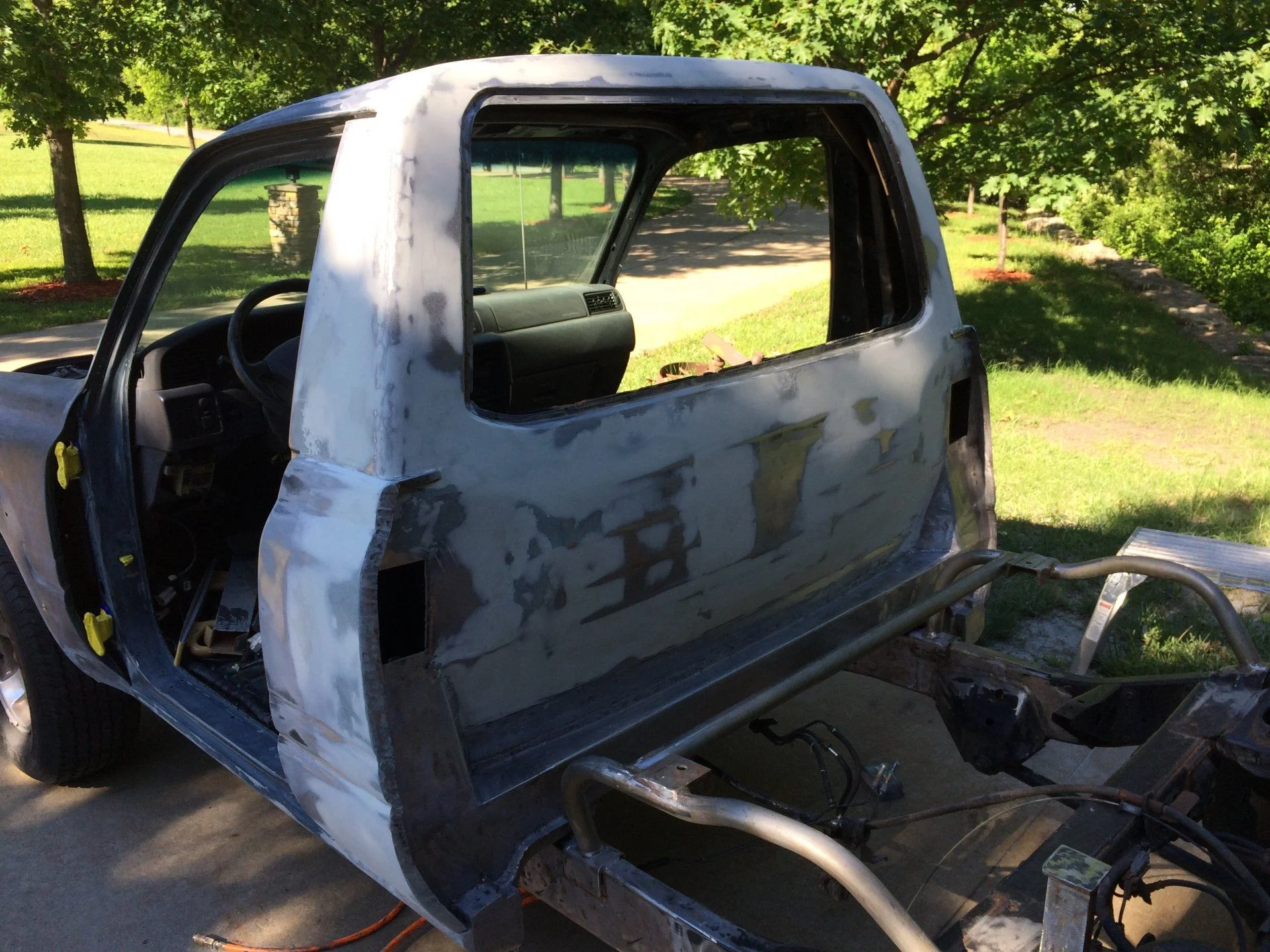

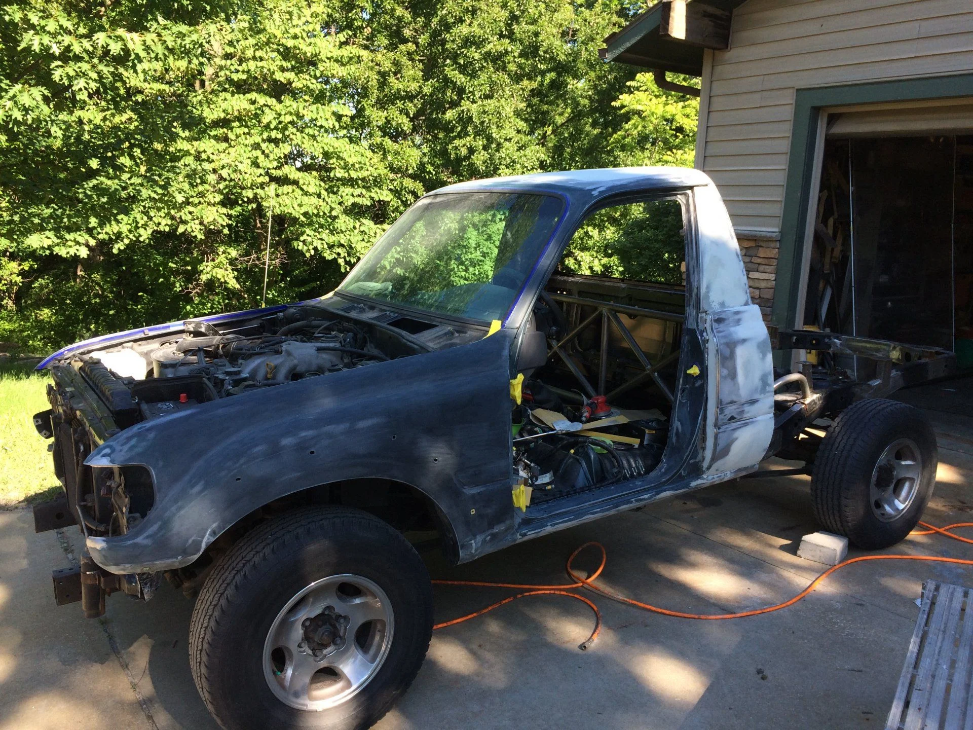

So the great news is that we finished all the metal fabrication and started on the Body work. Used acid to get down to metal and then used cats hair on the big filler areas. Still using the same piece of Volkswagen beetle glass that I did when I started doing this 20 years ago
Then comes the light weight filler
Body work done, getting ready to prime.
More pics
note to self. I called southern poly and they recommended priming first, then wait the 24 hours, then put on seam sealer.

Looking great! This is an epic amount of work, can't believe you quick you guys knocked it out.
Thanks so much Jose. Been tons of work the last month, and at time seems like it is crawling. Appreciate the kind words -- they motivate me to keep pushing forward.

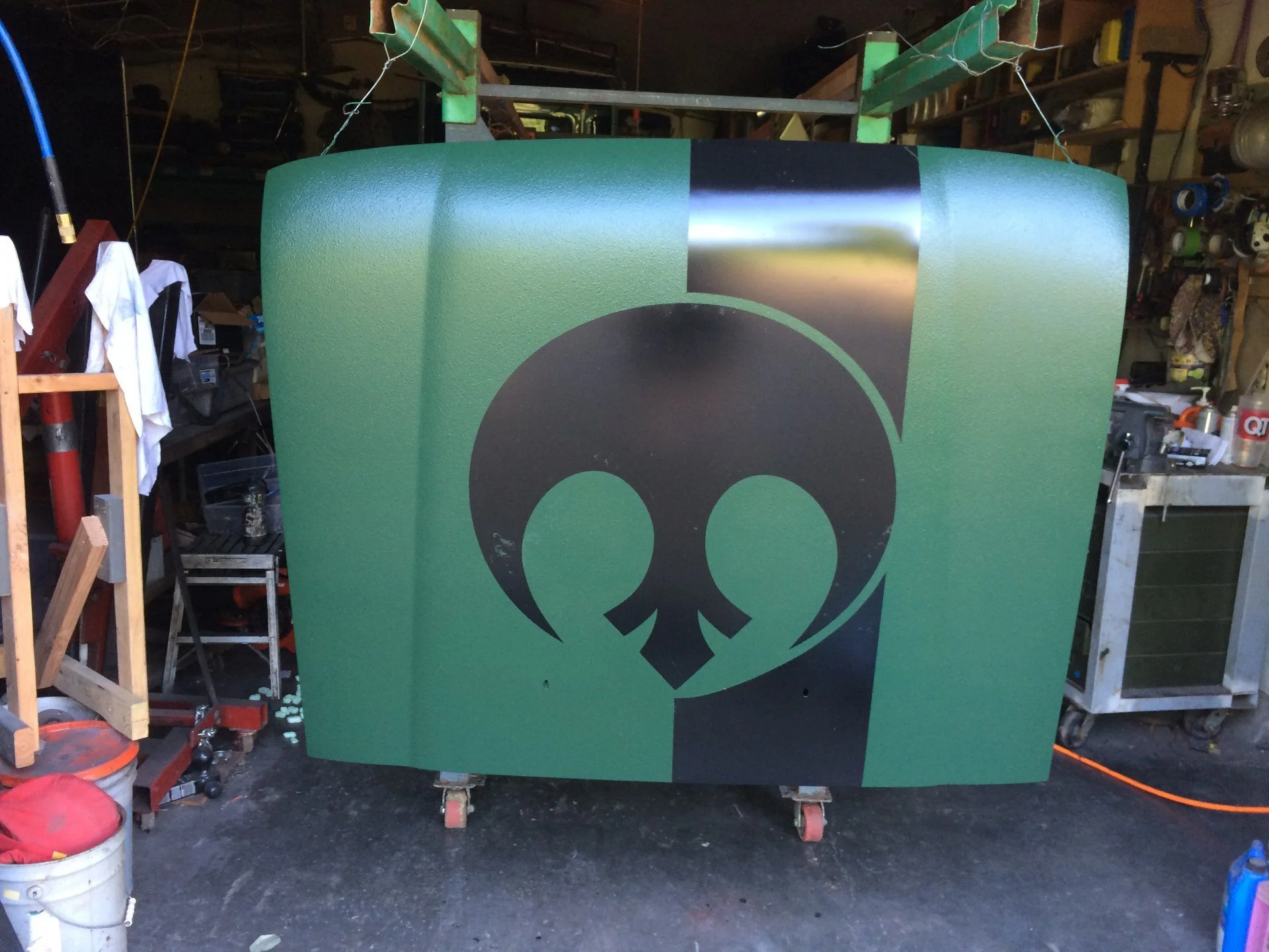

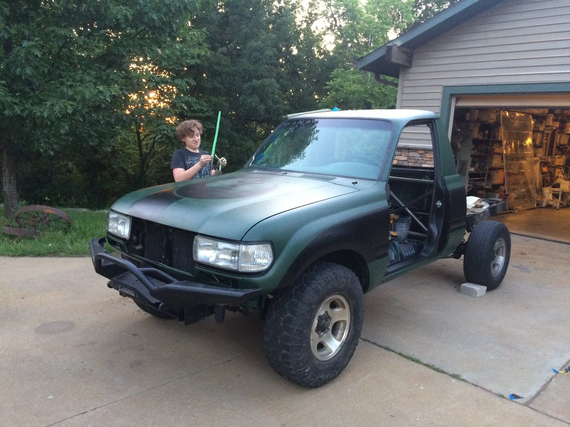

Josh, Mike and I got the car prepped and painted the jungle love green on today, and realized that we have the wrong color for black mix. Anyone have any black???
we need enough to do maybe 1/4 or 1/3 of a gallon, so not much needed.
On a timeline, so need it ASAP.
Thanks,
Kelly
Pics of the jungle love on, the black is currently primer but it will be black Monstaliner....,hopefully

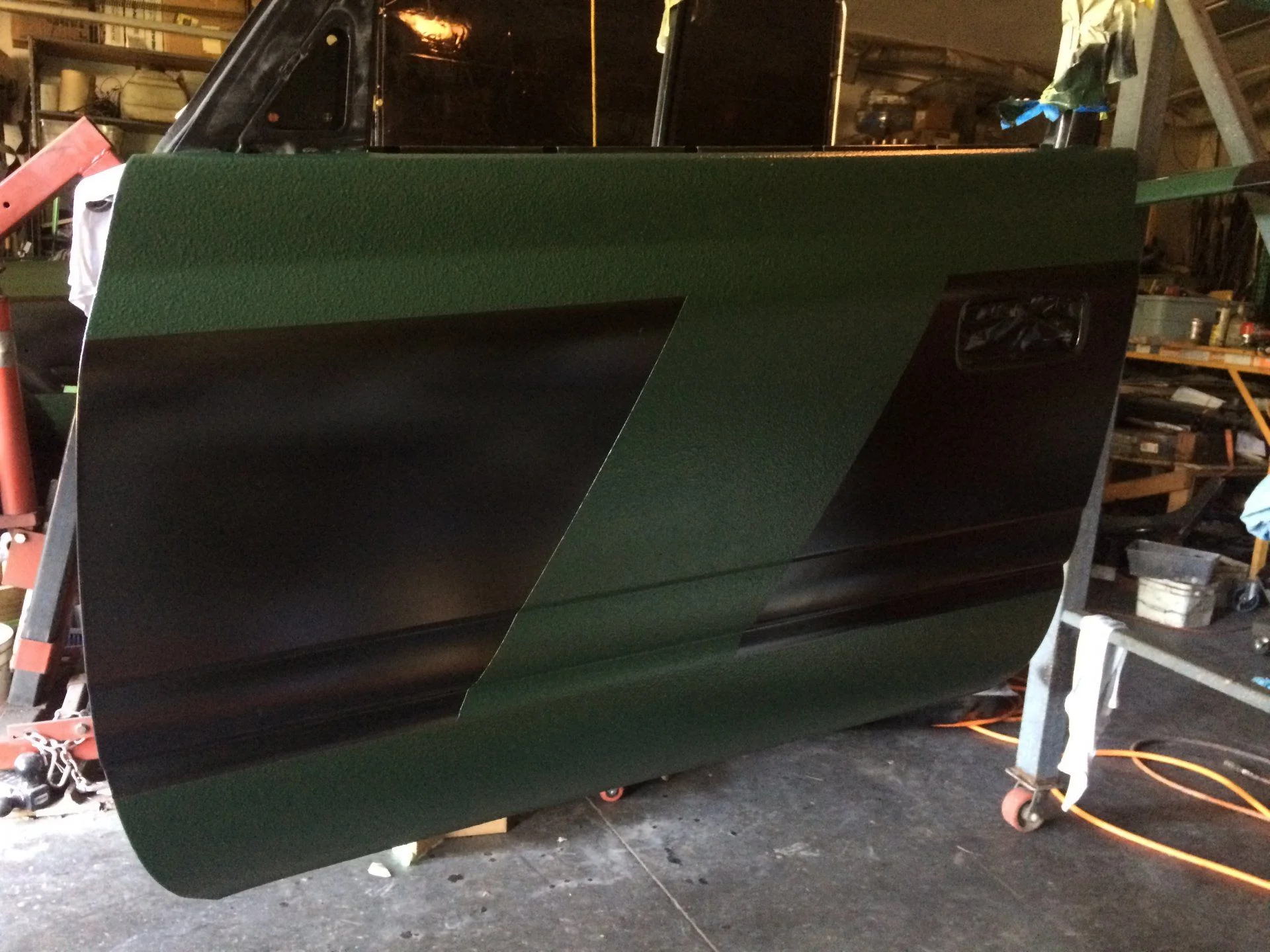

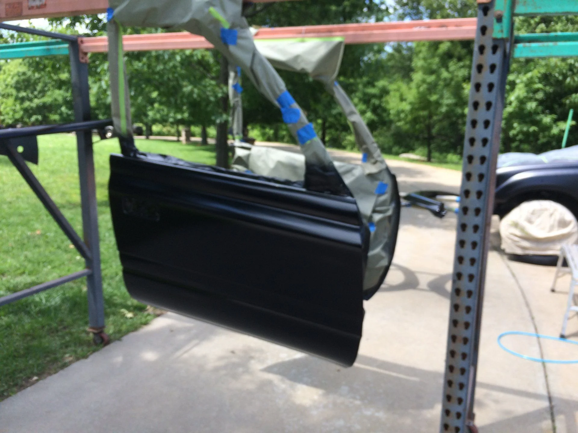

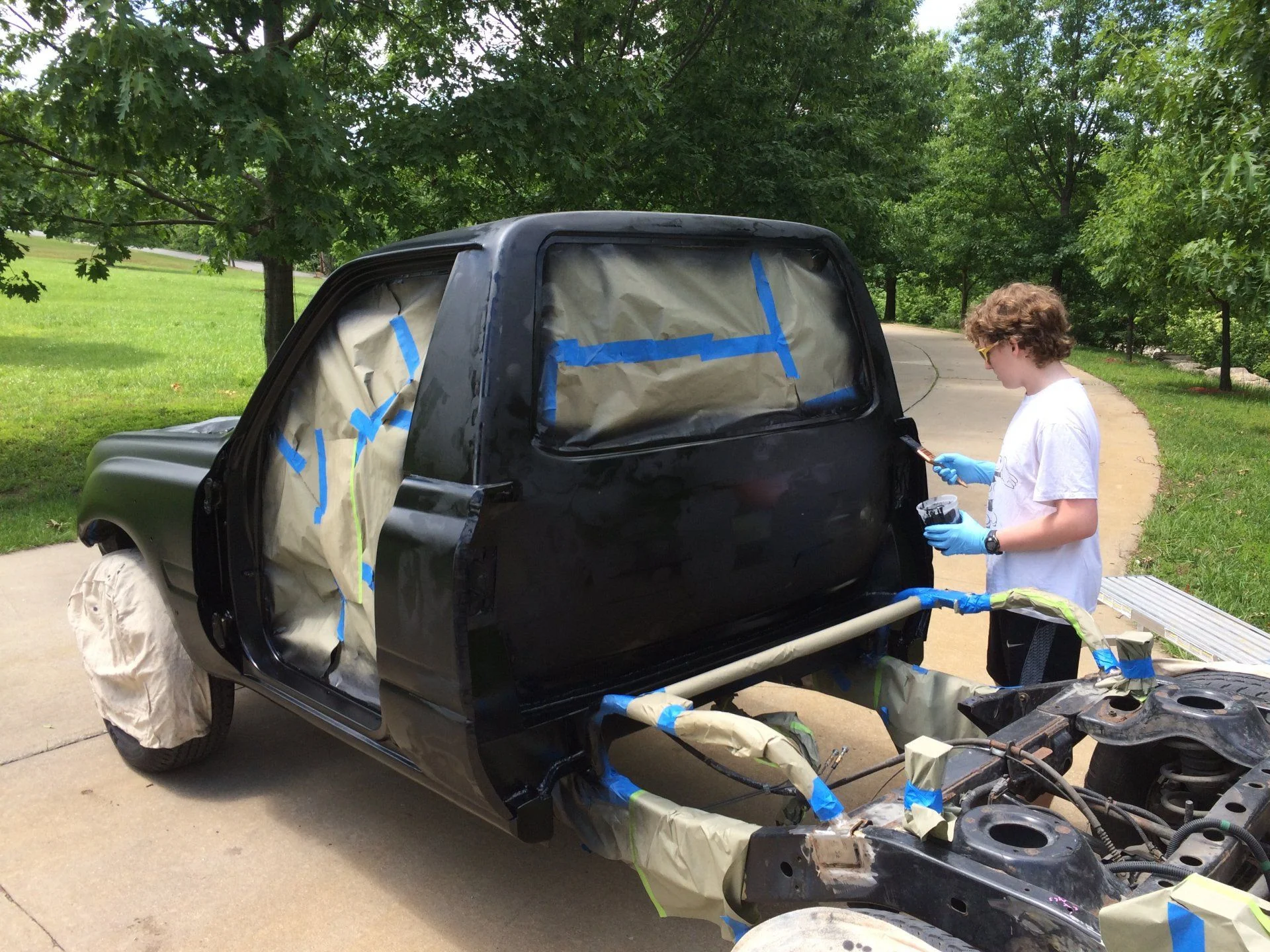

This morning was a good morning. I'm proud to say the Montaliner is COMPLETE! Oh my gosh that feels so good to say let alone type up. Here are the photos. Some are turned around to show correct orientation so the ground is not where it normally is. Tripped me up for a bit. It looks great and the next paint step is to just spray around the door wells. Then the pieces come together! Here are some pics:
Like Josh said, we got the monstaliner done. I bought colorant from Orielly's. Mason brand, universal black color, no binder. Dried much faster than usual; however, looks great and the DONE word was used.
Then we sprayed the john deere blitz black on the door jambs. Next up is to put chassis saver or por15 on the interior roll cage and bare metal, sandblast the rear frame a little bit and POR15 that.
