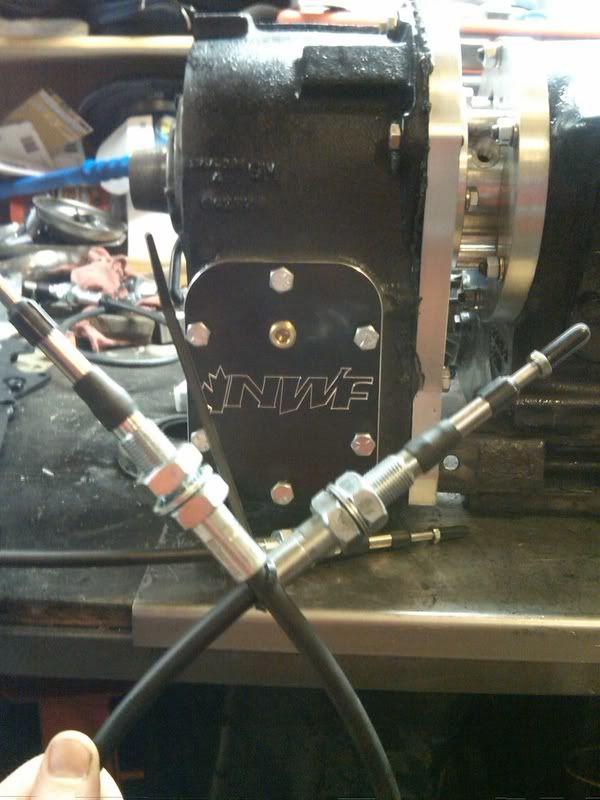

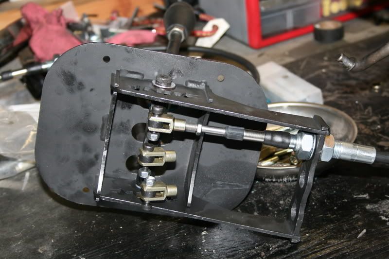

On a side note, if budget weren't a concern I'd be interested in setting up a cable setup to see the difference. Brokenparts has a slick cable system but it's not setup yet so once he gets his complete I hope to get a chance to feel the difference between the rod linkage vs the cable linkage.
True, I should have been more specific. Besides, it'll handle a little differently under the truck than on the bench. ;p
Quick question, does it allow you to choose which side of the shifter pivot you can hook up your cable?
what are you talking about? It's set up....
Just happens to be on my work bench. :)
your work bench has lower gears than my truck....
:D

I like the heim joints though. That seems like it would allow for more adjustability.
Ill post up too as I go!
Thanks, that does answer my question. The cable ends can only attach to one spot on the shift lever. For me this means if I were to use that exact setup my H/L shifters would be thrown back and my 2/4wd would be thrown forward during normal driving (H-H-2wd). Since I'd rather have all the levers forward when normal driving I'd have to modify where the cable end connects to the shifter to be above the pivot point of the shifter for my two H/L shifters.
