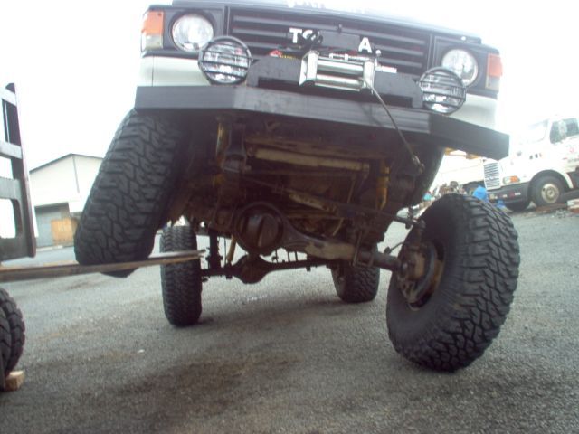

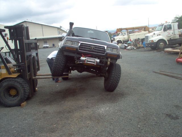

Let see some real world flex ..
and for comparision I get 2" more inches of travel compared to my buddy 80 series 6" Slee lift kit .. ( same 37" MTR tires )
