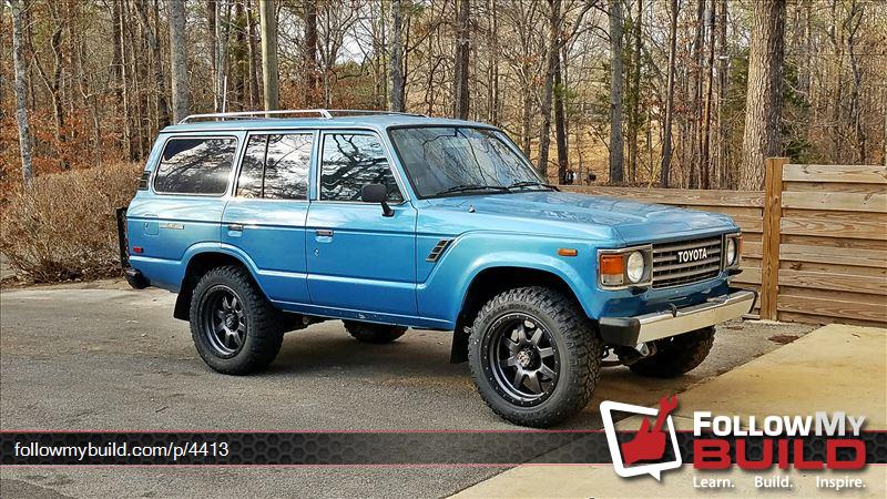

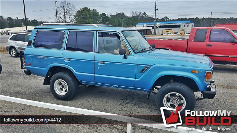

This '84 FJ60 is going to be our "family adventure machine". It will be built out in somewhat of an overlanding setup with good street manners and driveability in mind. It will probably be my daily driver if I'm able to get all of the kinks ironed out.
It will also be towed behind our motorhome (on a trailer) along with a 4 seat Polaris General.
After searching online for a few months, I finally found one within a couple hours of home and picked it up about a month ago.
It will get the chassis and drivetrain (axles, suspension, transfer case, etc.) from a 1996 FJ80.
It will also get a L92 (Gen IV truck version of the 6.2L LS3) and a 6L80 transmission.
I would like to keep the paint the way it is, with few little rust-fix repairs.
I'll do my best to update this thread along the way.
Day 1 (worst wheel/tire combo possible)
View High Resolution Photo
Day 1 plus about 30 minutes

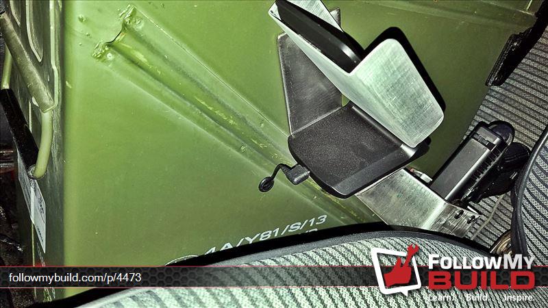

Ammo can console with 3D printed hinge.

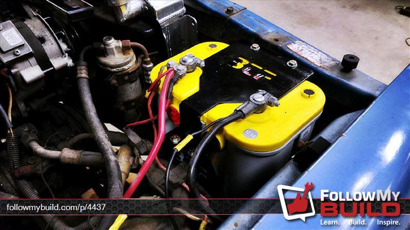

New Battery and BTF battery box

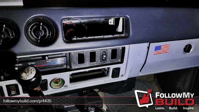

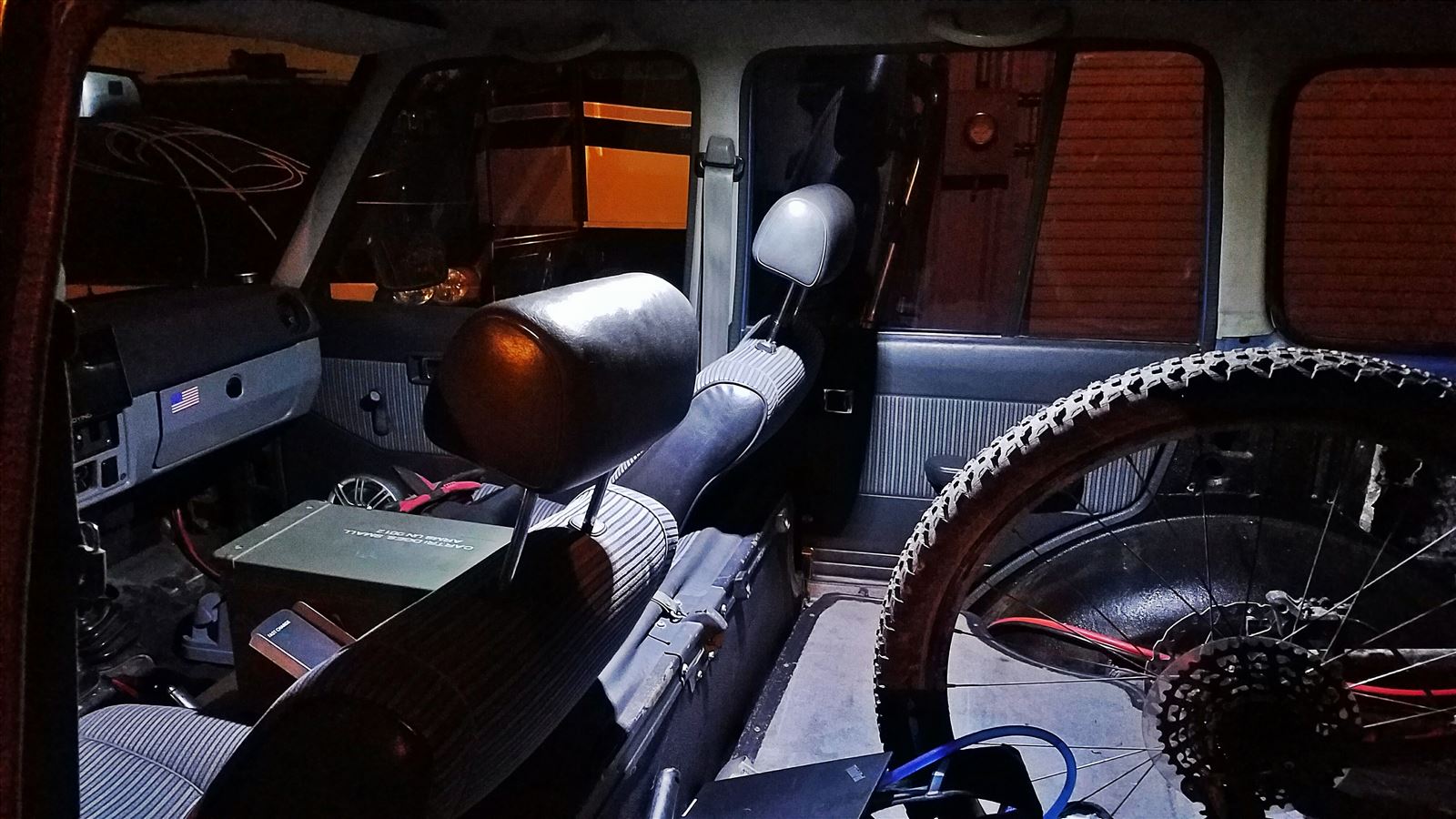

Made a little progress on the audio and wiring.

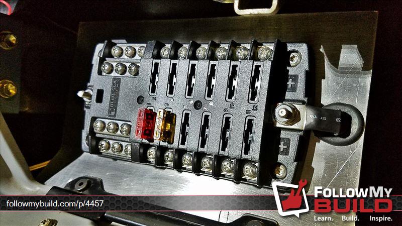

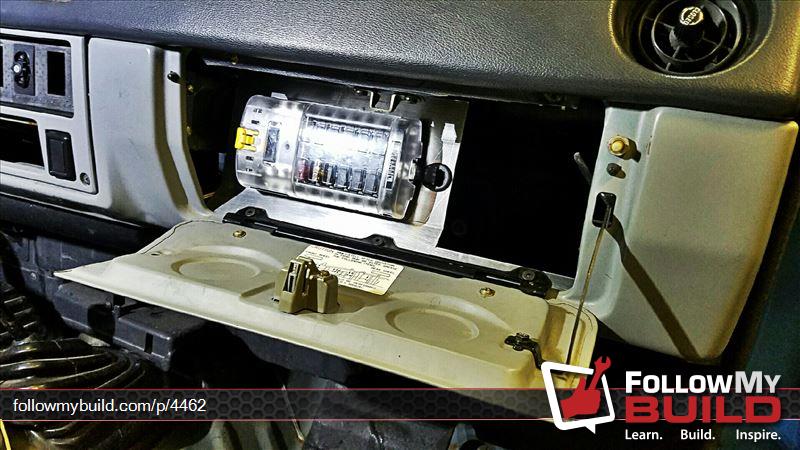

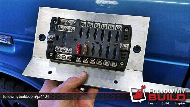

Blue Sea fuse panel mounted in the glove box. At some point, I'll build a pocket to the right of the panel. That's why I left the big hole.

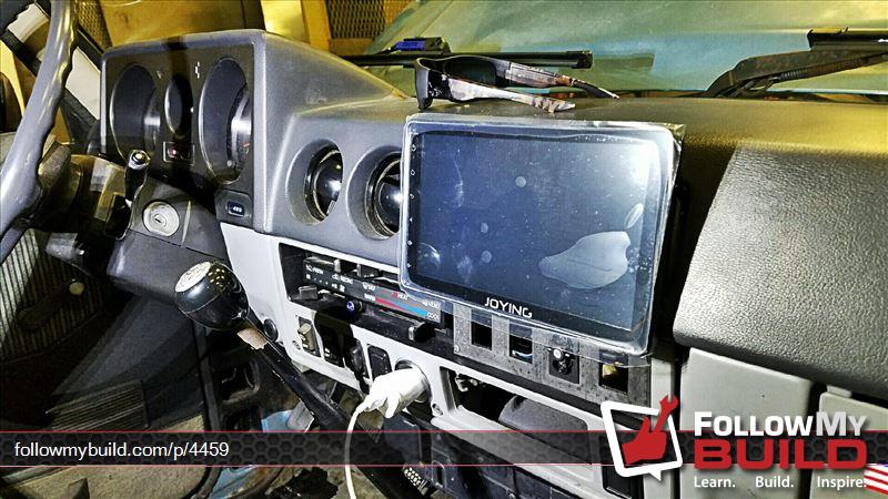

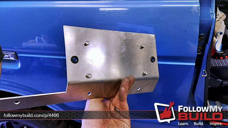

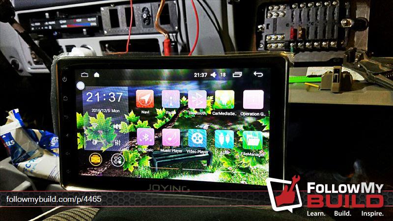

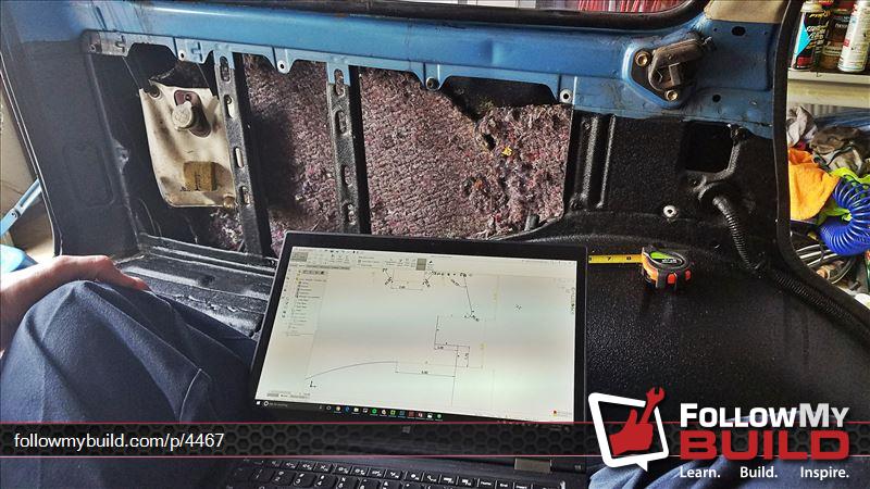

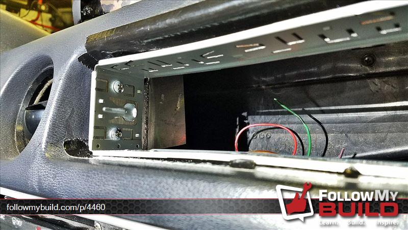

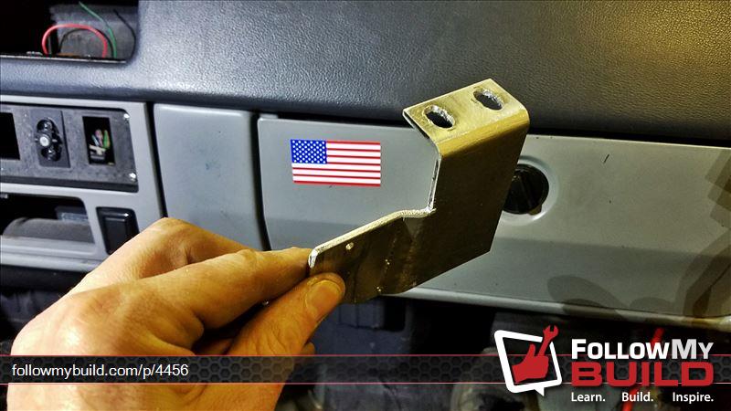

The OEM deck mount brackets are not sufficient to hold the Android Auto head unit in place. I wanted it to be super firm so pressing on the touchscreen wouldn't cause it to move. The Android Auto system will provide navigation, systems monitoring, etc., as well as engine and transmission data for the L92 through a Bluetooth OBDII dongle.
New mount brackets.

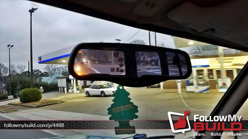

I also went to the local Pull-A-Part and picked up a rear view mirror ($30 w/ temp sender). The OEM mirror in mine had already given up the fight.
I picked up a Gentex 177 (GNTX-177) from a 2000'ish Chevrolet Tahoe. I chose this one because it has auto darkening, compass, and temperature. Plus, on Tahoe's, it's easy to locate the temperature sensor (center of radiator, below hood latch). The sensor is easy to remove and wire back (two wires).
I have not run power to it yet, but should be pretty straightforward. The compass is internal to the mirror assembly.

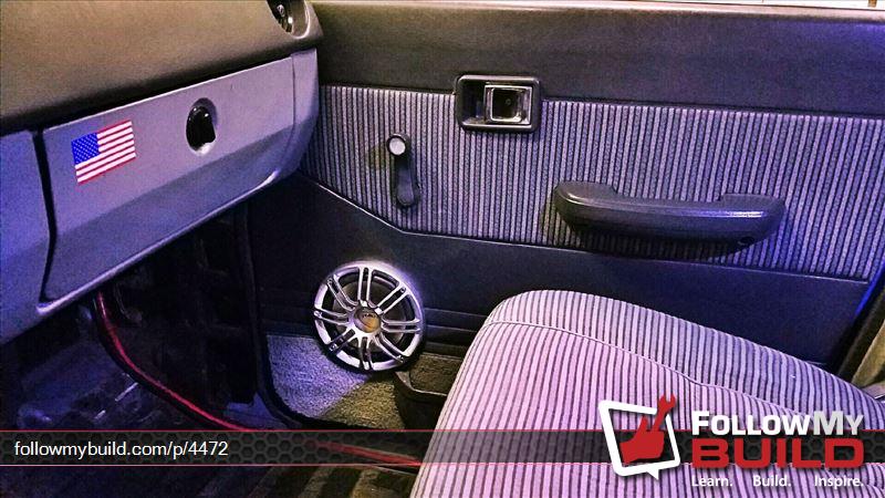

Finished up the front component speaker installation. I used components so I could separate the highs and put them on the dash to bring the sound up a little.

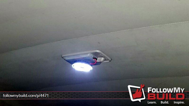

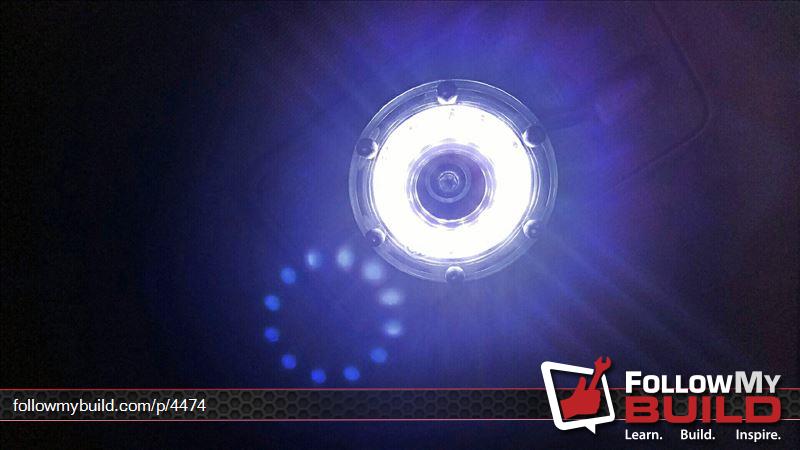

Swapped out the main dome light with a Cyclone light from KC HiLites. I use things all over my builds. They're very versatile and durable.
The dome light swap is pretty much just a concept at this point. However, if it works well, I will probably design and 3D print a proper housing for it and maybe a second Cyclone to add more light. Doing two lights would also allow me to run a red light on one side and a white on the other, with a switch to change from white to red for nighttime use.
New mount brackets.
So this mount bracket? Is it taking place of the stock ones that were originally connected to the underside of the dash? If so, are they compatible with a standard single din deck? May be interested in having you make me a set if so (and you are up to it).

Definitely need more details on this one you wire everything up. I know that there are some guys that have purchased the aftermarket Gentex mirrors for the compass or temp usage but I always thought that the autodarkening required a certain type of windshield (has the dot matrix over where the mirror mounts to the glass. Anyways, definitely do a write-up on this when you get some time as my mirror is about ready to give up the ghost as well.
Yes, that's it. The deck I used is actually a single DIN deck. It just has a large display that snaps to the single DIN housing. As for making more, I would need to put them in CAD and have them produced. There's a jog bend in there that is tough to do by hand, especially repeatably. I am actually returning the deck that I'm using now. The capacitive touch buttons don't work. So, when I pull that deck out, I'll pull the brackets and draw them in Solidworks. Do you think anyone else would want some? They should be pretty inexpensive.
The autodarkening is built directly into the mirror. All you need is power and ground for that part. The same goes for the compass; it is internal as well. The temp sender is the only external component. I am also going to put some LED lights on the bottom of the mirror housing that will open with the door circuit. The center mount dome light doesn't cover very well. There are some mirrors out there (Subaru) that have autodarkening, compass, temp, and lights, but they're huge. I like the simplicity of the 177. I'll try to snap some photos during the wiring.
Thanks dude... For the deck mounting brackets I am sure that there are others that would be interested. Once you get it drawn up in solidworks put up a feeler thread and see what people think. Mine have been missing since day one for me, my deck is not really held in there or mounted securely to it would be nice to have some brackets.
If my laser shop can do the jog bend, I'll do that. Either way, I'll share out a flat file for the part. That will allow anyone to print it out (to scale) and transpose it onto some aluminum. These bends are small enough that you can do them in a bench vise.
