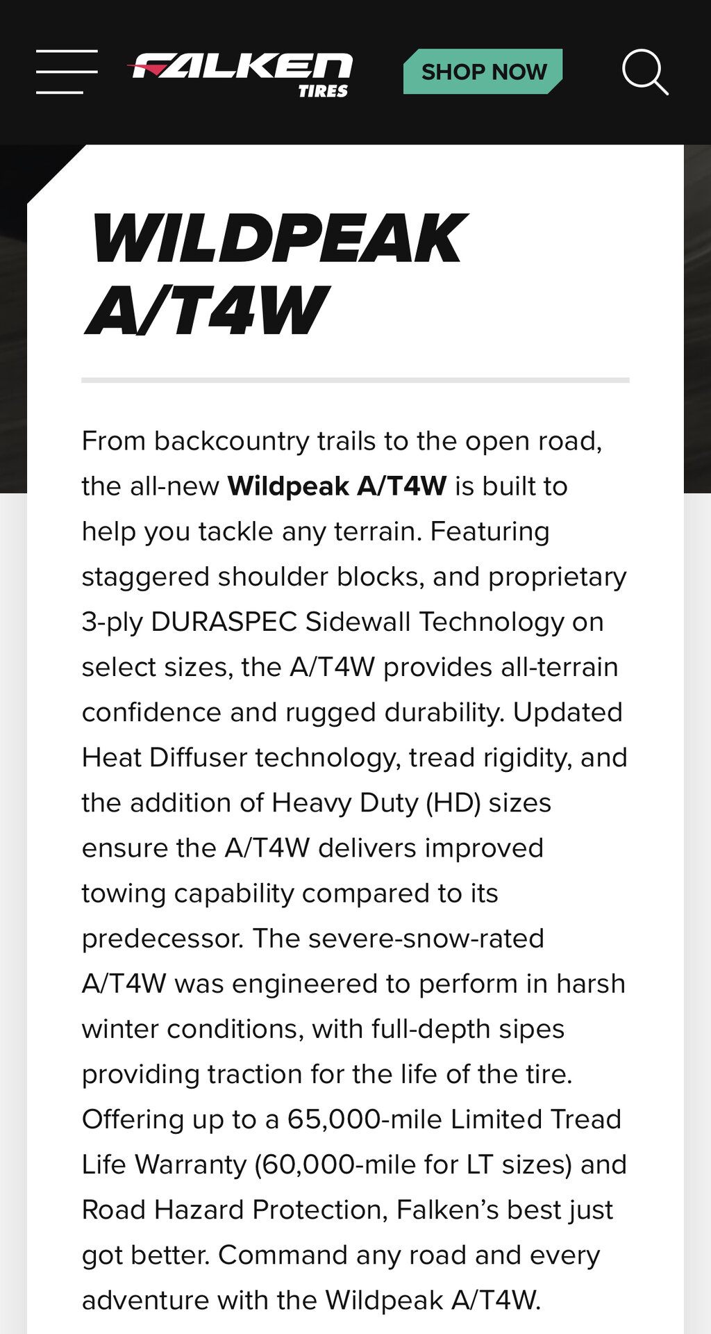

These tires from Falken are brand new. Has anybody installed these on their 60series?
I may want to consider the 255/85r16 but they a rated C… 😕
Would like to see them rated E
