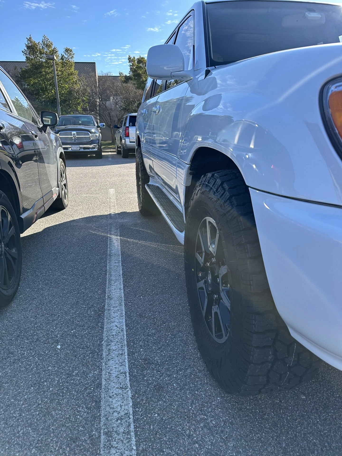

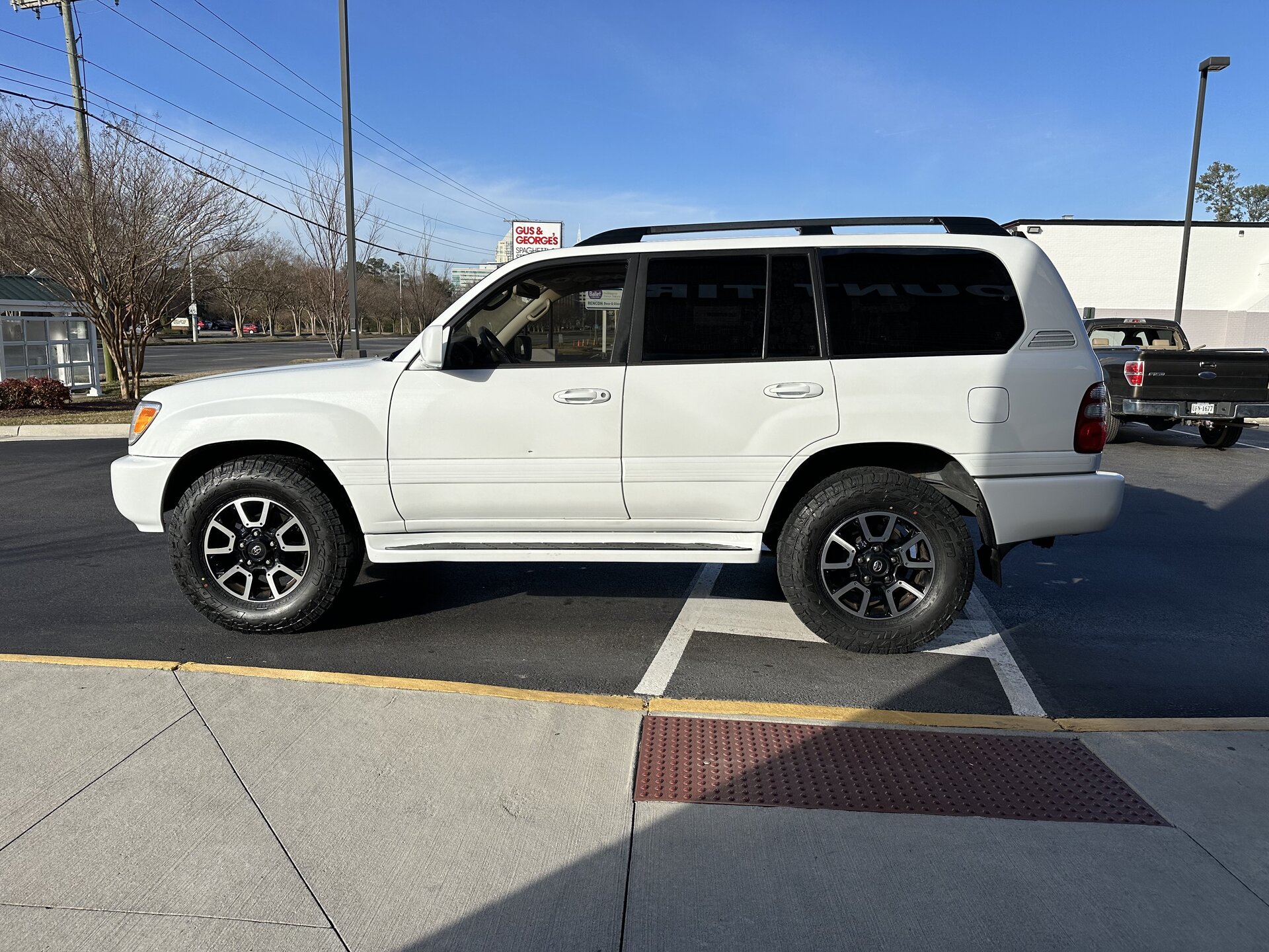

Just picked these up. Wildpeak AT4W LT285/70R18 LR-C.
Tundra off road rims, 1.25” spacers. Clears pinch weld *barely* and had to cut a little of the fender liner in front of it.
Initial thoughts are good, just a lot heavier than the P rated Tundra tires they replaced.
@CruisingTheLand Do you think they would fit just fine w/o the spacers?
I run 35" AT3W on my van for 2 years now. 20-25k miles now and at least the same life left. zero noise over regular street tires.
A friend of mine used to work on the Ineos Grenadier and they worked with BFG on a new tire. BFGs target: get better than AT3W again as it's gaining more and more market share ;-)
Yes very likely. Spacers have been on so I can run these wheels with the front caps
Thanks! Do you notice the weight difference compared to stock? They are 68 lbs ea, quite heavy for C rated as E rated tires in 295 are only 2 lbs more.
Definitely notice the weight coming from P275/65. Still on first tank of gas so we’ll see how bad the hit is
Did you get a spare as well? Does it have enough clearance underneath the truck?
Thanks for being the first to try it out on a hundy.
View attachment 3553914View attachment 3553915
I’m foaming big time. I got the Amazon 1.5 spacers ready to throw on my 275’s/70/18 but these look soooo good
