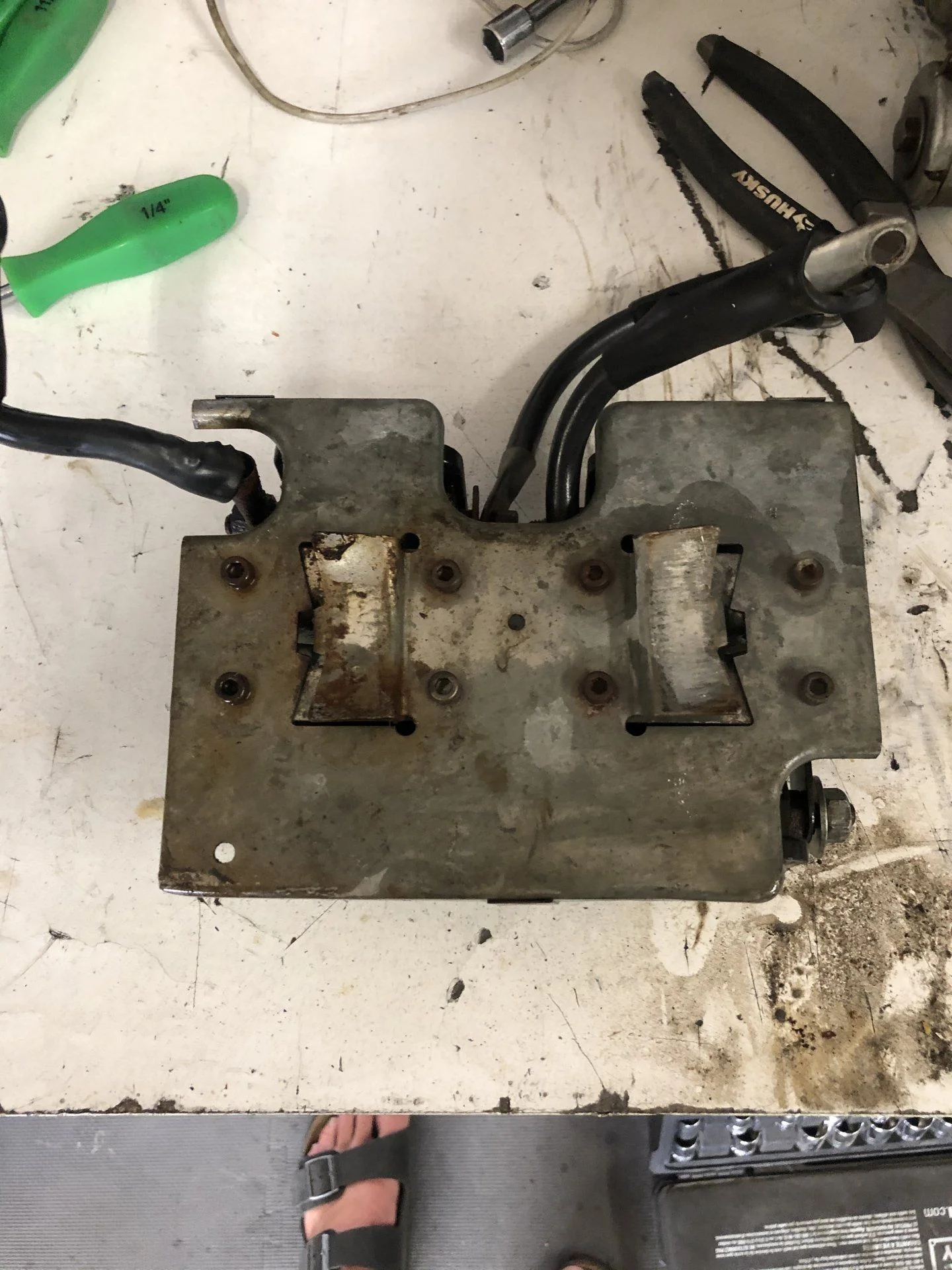

Flint, so I started dismantling this one and there was some serious rust on one of these and of course it cracked:-(. Do you know if they sale these pieces?
Yes, parts are available individually or the entire solenoid pack....but if it were me....I'd ditch that and go with an Albright.
Got it. Do you know which ones I would purchase? Do they bolt up the same way to the plate??
This is what I used for my 3 pin controller on my 8274: Warn # 83665. Amazon for $60.
If it has 3 wire, yes.
