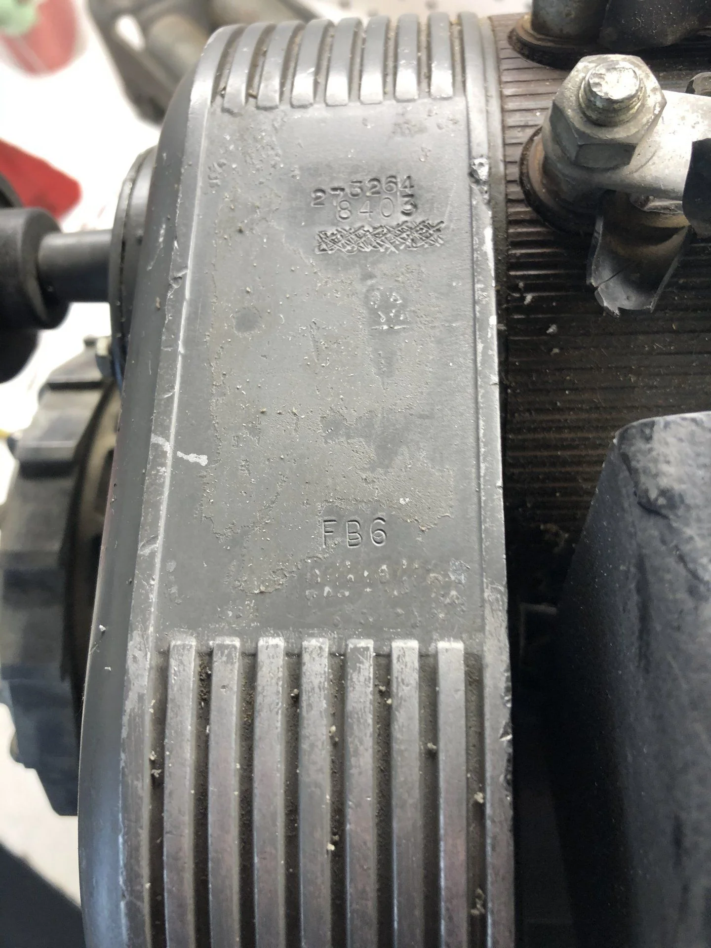

So I ended up buying it sight unseen for $300. Had a friend of a friend pick it up who was headed home from mesquite, NV to Draper UT today. So, the sticker was definitely fake. The code to determine year built is FB6 with a metal socket. So June 76 model. The only thing that is strange is why would someone delete the original serial number? Should I be concerned?
Glad you got it. My understanding of the date code indicates this was made in June...in a year that ends in 6.
my WAG is ‘86, 2nd guess would be ‘96.
It wouldn't bother me; the internals are all the same, and all that matters. Makes you wonder if it was stolen at some point in its life - can't think of any legitimate reason to alter the serial number, but maybe I just have a suspicious mind.
Glad you got it. My understanding of the date code indicates this was made in June...in a year that ends is 6.
John, the old metal 4-pin controller socket makes it 1980 or earlier, so '76.
That’s exactly what I thought, it was stolen, refinished and they slapped a new sticker on it. For the price, I’m a happy camper.

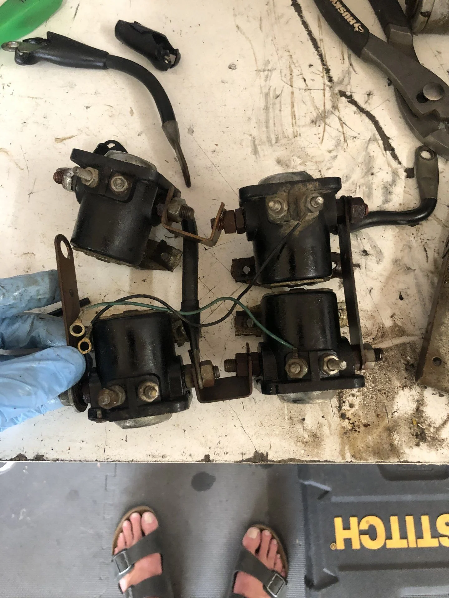

And to the OP of this thread...like @1911 said, age is not all that significant with these 8274’s. I’ve used mine on many long and hard pulls...many. I’ve replaced one solenoid over the years. I also have a 8274 on my 60 that I have upgraded the solenoids to an Albright controller. You might want to consider doing this also. Much more reliable.
I agree; replacing the four solenoids with a single contactor was a good move for me also.

For $70 you can add a Albright to a used/rebuilt 8274 and now you’ve got a very good (some would argue the best) winch for cheap.

Flint, so I started dismantling this one and there was some serious rust on one of these and of course it cracked:-(. Do you know if they sale these pieces?
