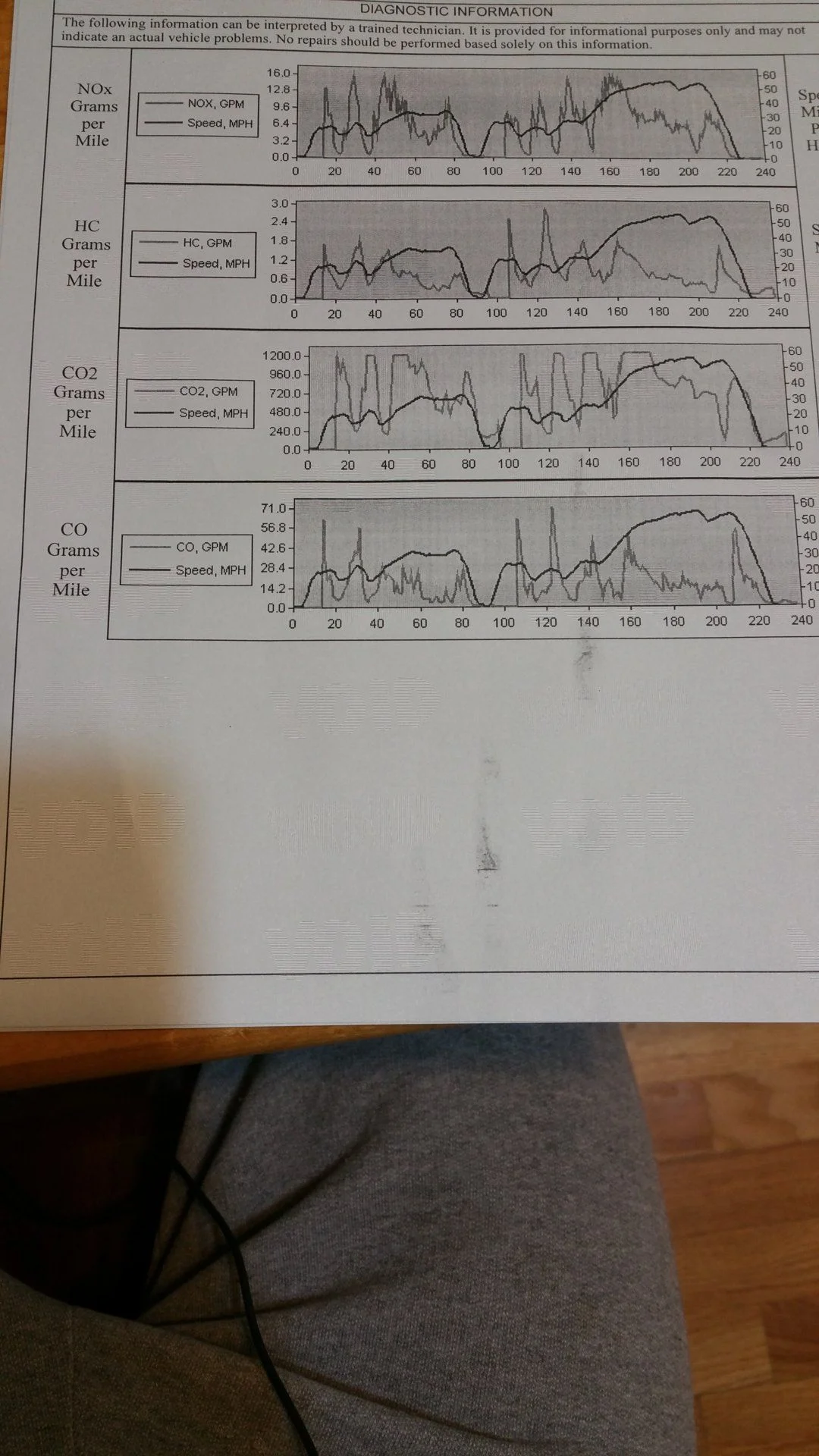

My temp tags were set to expire, so I took a gamble and got it emissions tested despite all the work I wanted to do. It failed for high NOx (6.4 average). Just wonder where people think I should go first.
My understanding from all the lurking is that elevated NOx is from high cylinder temps. Any reason to believe that the cooling system overhaul would make a major dent in NOx? Wouldn't that be a treat?
