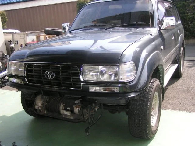

Most that I've seen here are Mechanical .. 80ft of cable. Few ones are electrical with a termo control switch. Let me search for pics of the factory winch in a 75 series ( thought the same as 80 series ).
Here are ..

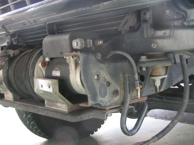

Here are ..
main.php
Based on that label I'd say it's a 2,200 lb winch single line and an 8,000 lb winch with a tripple snatchblock......
Hardly a workhorse.
thats how i read it too :crybaby: bugger mite have to rethink my plans for the factory winch.

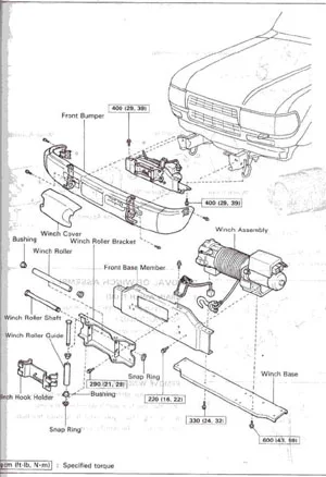

Here are a few pictures. There is a post here someplace that provides the specs for the 80 series OEM.
