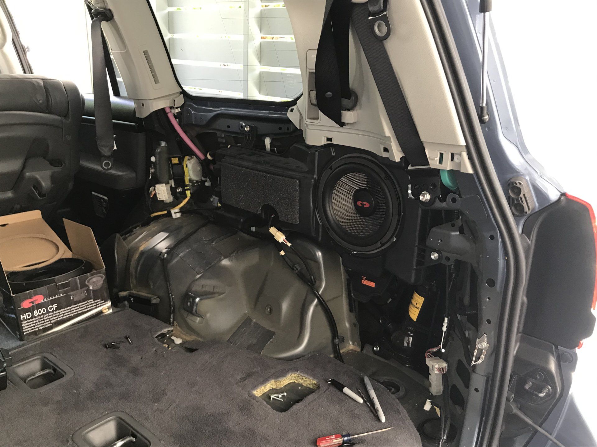

Removing the rear panel is actually not that bad. Just did it this morning and installing the same CDT sub murckman mentioned. Will do sound deadening also. The factory sub enclosure actually looks decent and well made. While its a lot of steps, it sounds more intimidating than it is in practice... hardest part for me was freeing some seatbelt bolts... all in all a good social distancing project. Feel free to pm me for any questions also
@Murckman - thanks for sharing. So how is the sound and low frequency output compared to stock sub? I am considering this mod.

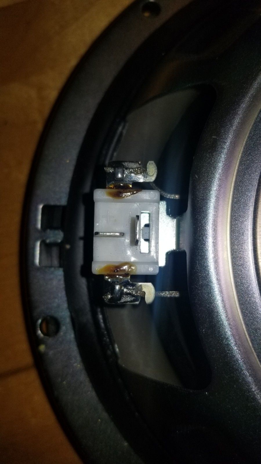

For all those venturing down the LC subwoofer replacement path, sharing an interesting discovery that may help you out...
When I took out the stock sub (2ohm DVC), I noticed the polarity was labeled on the connectors which is generally pretty helpful info... unless of course its wrong.
For some reason, I decided to test the speaker anyway and found that the terminals are mislabeled (see pictures).
I think the correct wiring should be the following, VC1: Green = Positive, Black = Negative and for VC2: Red = Positive, Yellow = Negative
In my tests, which involve wiring a battery's +/- to each VC and seeing what direction the cone moves, show the opposite of how the terminals are labeled.
When you wire a sub incorrectly, while it should not harm the speaker, I think this puts the speaker "out of phase" which could impact output. I've been chatting with @Murckman throughout this install and he concurs. After he fixed the polarity on his install, he mentioned better output at lower volume levels.

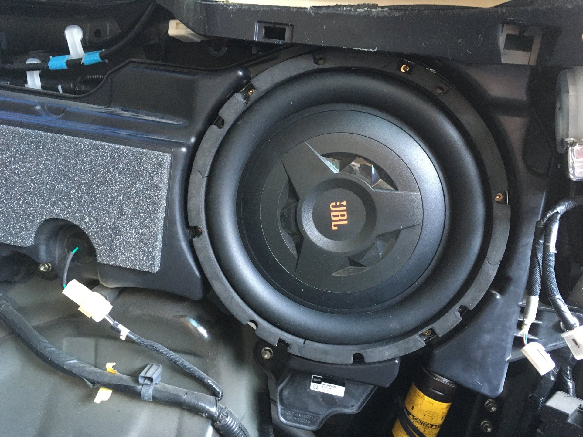

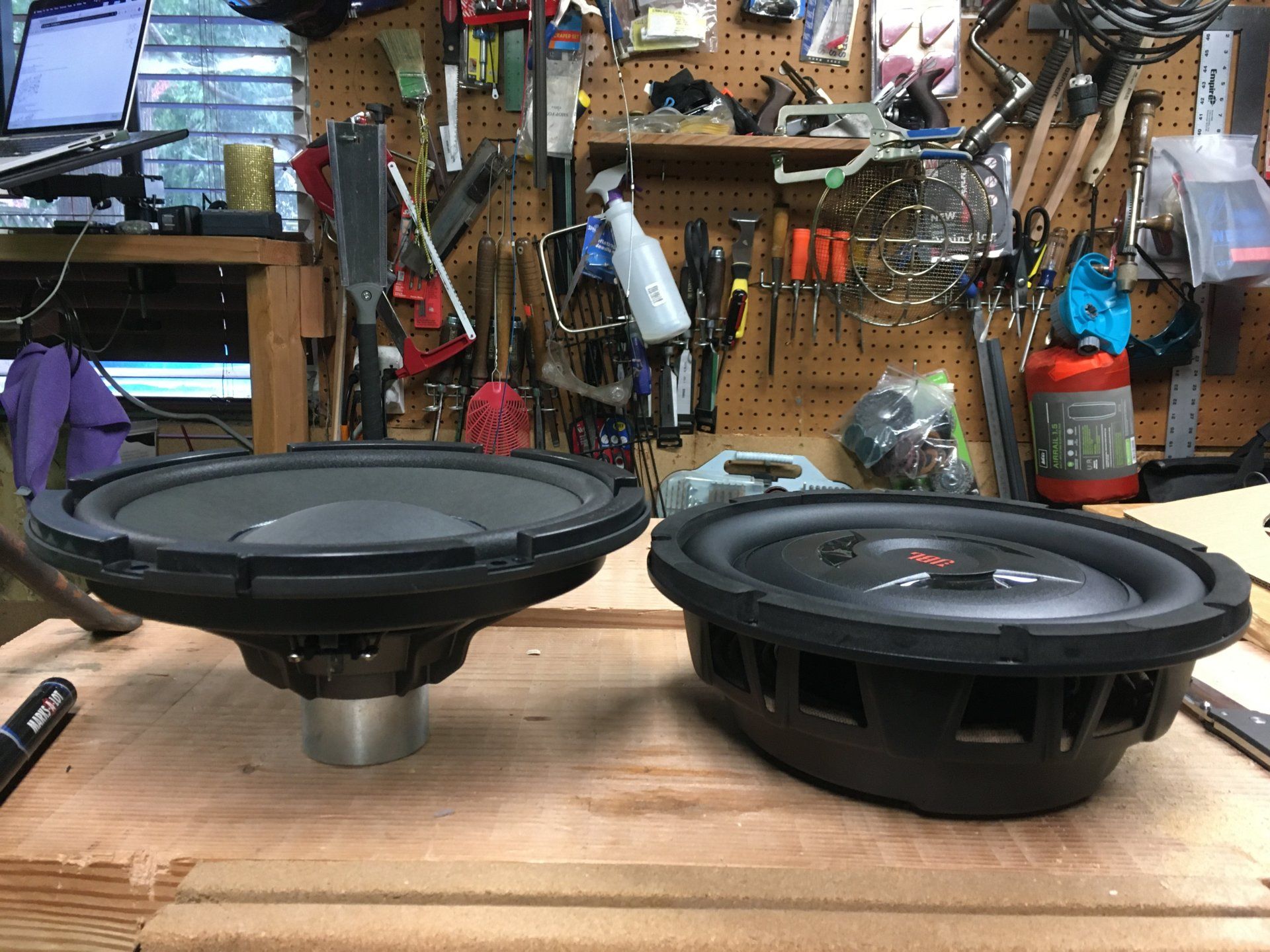

Well I’ve replaced the LX570 subwoofer 2009 year. It is indeed a single voice coil 10”. It is pretty deep, but has a traditional conical shape.

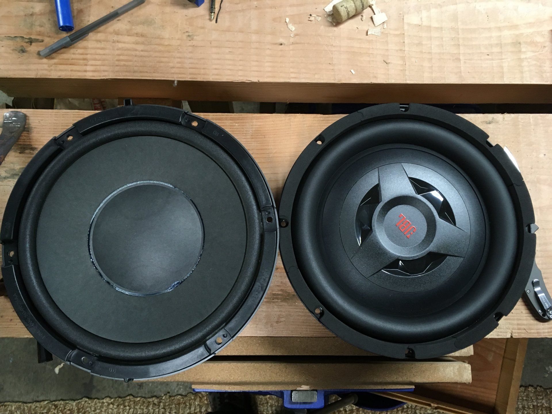

I had some significant headwinds getting the new sub to fit. The diameter of the frame was about 3/8” wider, and the chamber while pretty deep for most of it, is only about 1 1/2” deep close to the top shoulder. My chosen sub, a JBL Club 1000, has a new style stamped frame that is almost vertical walled, and it didn’t clear the shallow part of the box.
Additionally the stock sub is drilled out for six holes to mount and mine had eight. So lots of differences.
I also broke off the new sub fancy impedance switch during test fit.
So, I wired the sub in parallel, it is around 3 ohm, two five ohm coils.
I cut the box mounting ring to the screw holes, but was still too narrow and sub still hitting the shallow part of the box. I cannibalized the panel spacer to use as a mounting spacer to get 1/2” more depth. Drilled four new holes in the frame to accommodate six hole mount, weatherstripped everything and dropped it in.
Haven’t pulled the seat to reset the gain, but it definitely goes deeper. Toying with buying a sub amp and dropping that in to the Jack well where the first aid kit is. Priced out around $150, going to play with the DSP and see what I can get out of the current amp first.
