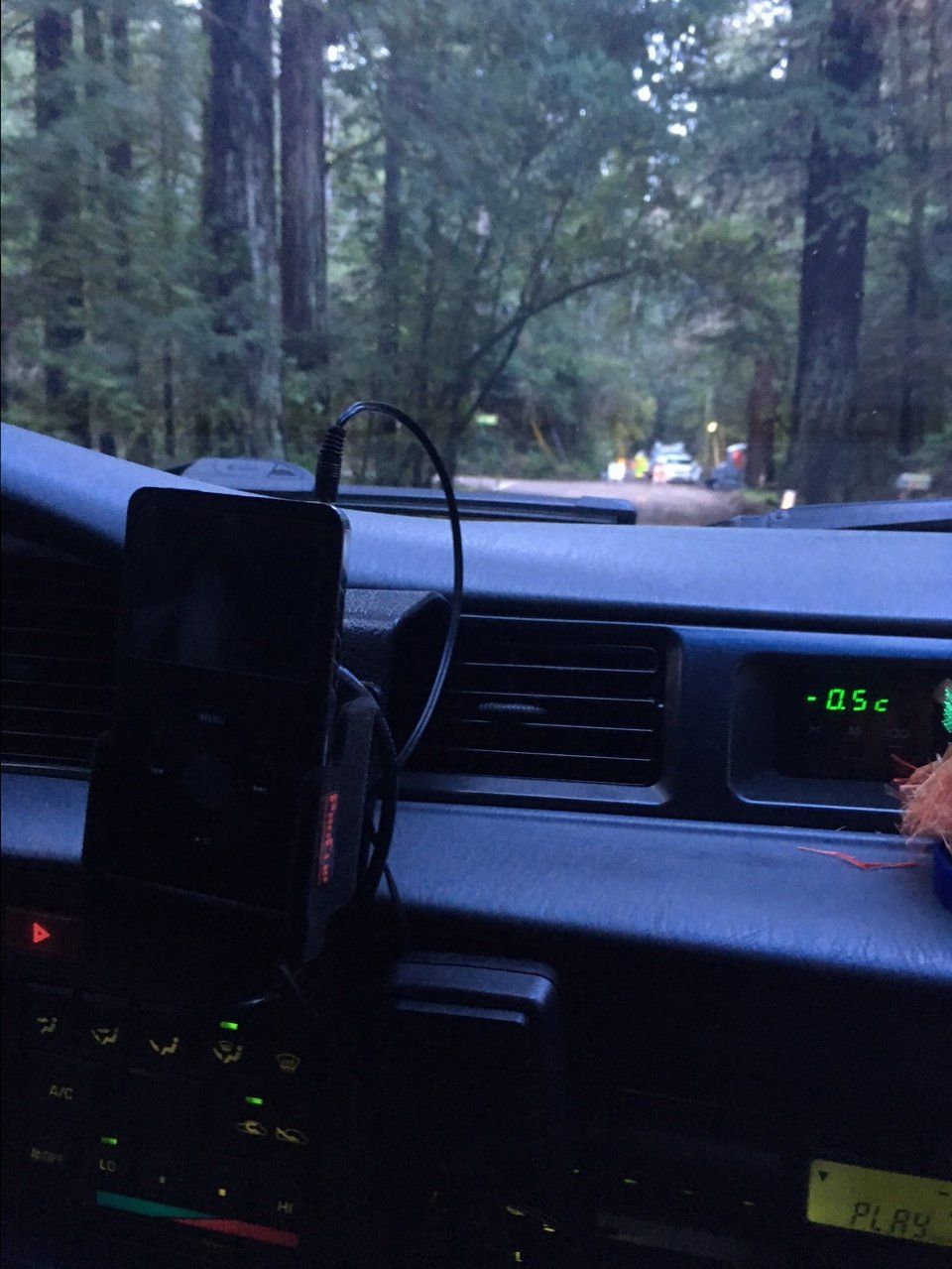

Bringing the thread back from the dead, and newly improved! Well, my original LCD temp gauge went with the ATM console when I converted to the Diesel and 5 Speed. So, I was looking on what to do to have an improved gauge. The conclusion, was a green LED combo 12v, clock, temp gauge replacement for the factory clock. It was a cheap one on Amazon, and I needed to add an extended sensor, but in the end it looks and works great. Modified the clock housing to make it all work. If folks are interested, I can post up more info.
Today the skies cleared from the storms, and my son was amazed that it read negative! Thank goodness for heated seats and a good heater.

Would love to get some more detail on what you did here!
