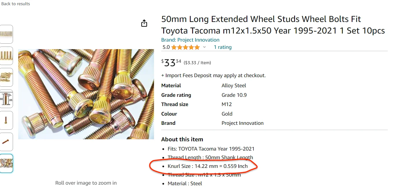

Any thoughts on if these will fit? (I have to extend my studs to accommodate 1/4" spacers for my wheels). Knurl diameter isn't listed and this is my primary concern.
Thinking I may as well order them since I am better at getting parts than actually getting anything done on the pig lately...

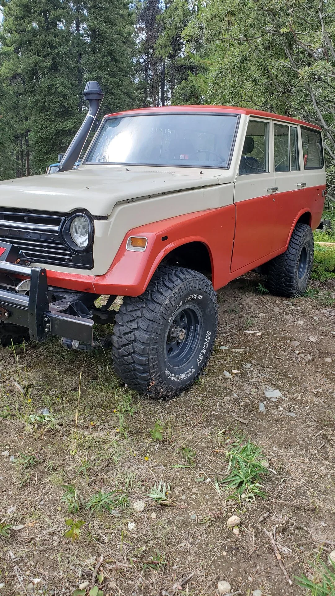

Alloy wheels, fronts are held on with barely a turn at the moment. I had assumed close tolerances on discs/pads and surface rust from sitting the last time i moved it, then the other day when bleeding brakes and TOB i saw the rub on DS..
We haven’t been seeing enough of this baby!
@RUSH55 I am so buried in projects I can never seem to get to it - so frustrating - at least my tools are now set up in the sea can and I now have the smallest of unheated shelters beside it so maybe, just maybe I can pick off of few bits through the winter.
@hoser took that as length not dia... makes sense that it could be diameter. Scraps is probably right, I should get quality studs though, even though the spacer is thin, there is a fair bit of power behind this rig.
