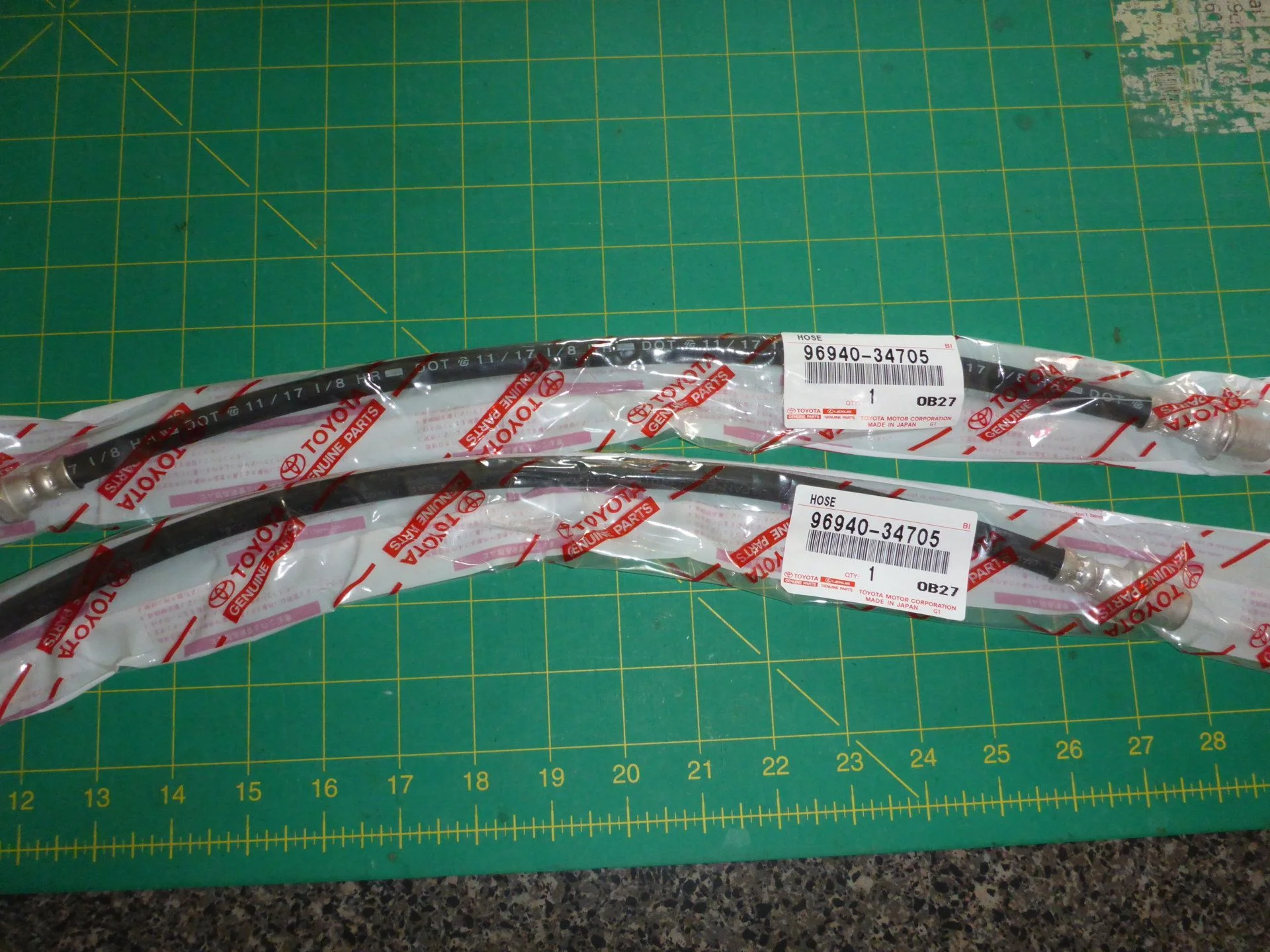

This is what I would use if you wanted to stay Toyota: 96940-34705 (x2) Will work on front or rear. Works for about a 2.5-3" lift.

Just thought I'd bring this back up to see if what lomoski ended up doing. I checked with my local Toyota dealer and got a price of $72 + US each for these (Toyota: 96940-34705 (x2)) Looking for something a little less spendy if possible. Also Lomoski, we need pics or it didn't happen..;)

Got mine from Amayama today!
