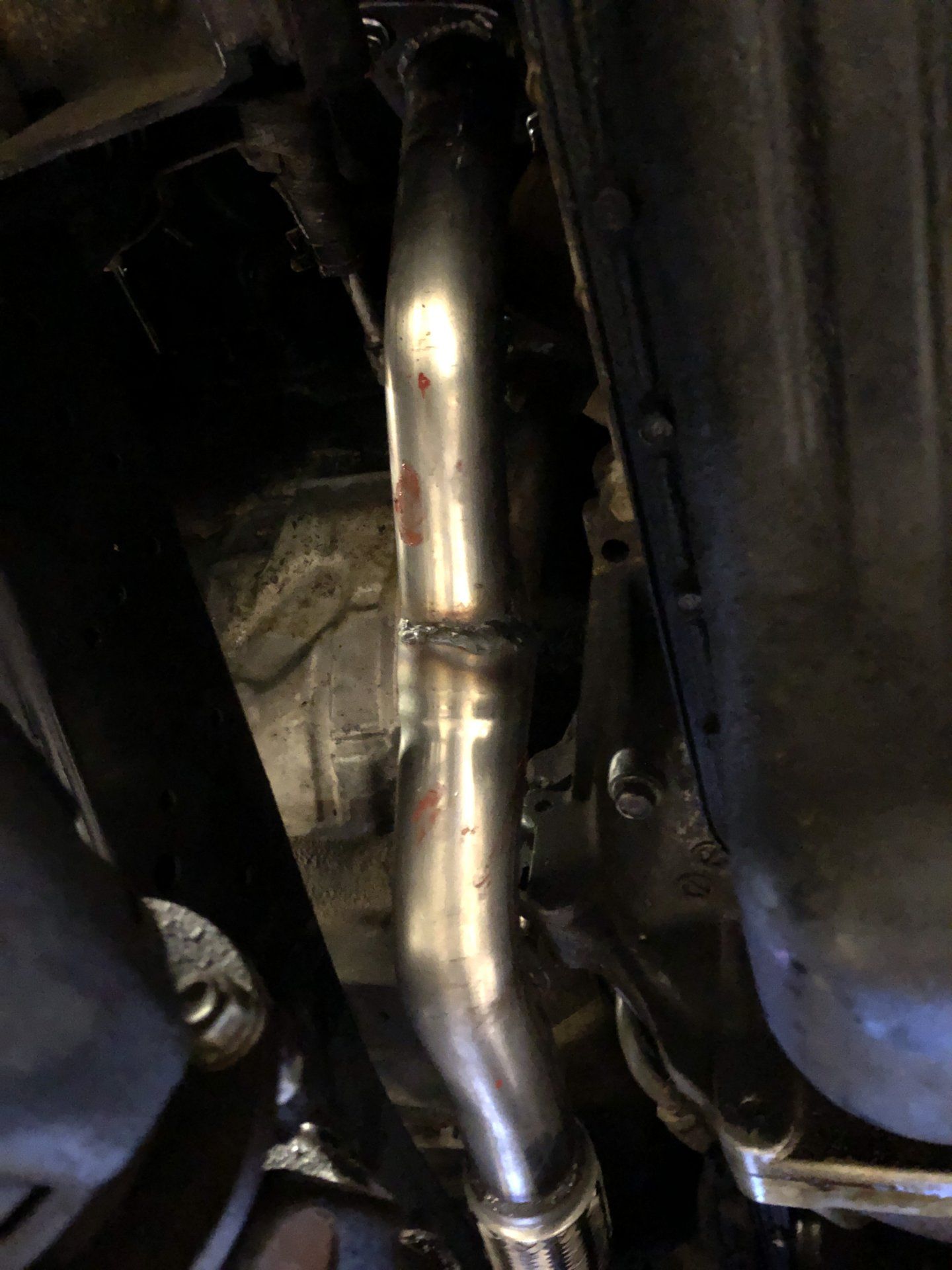

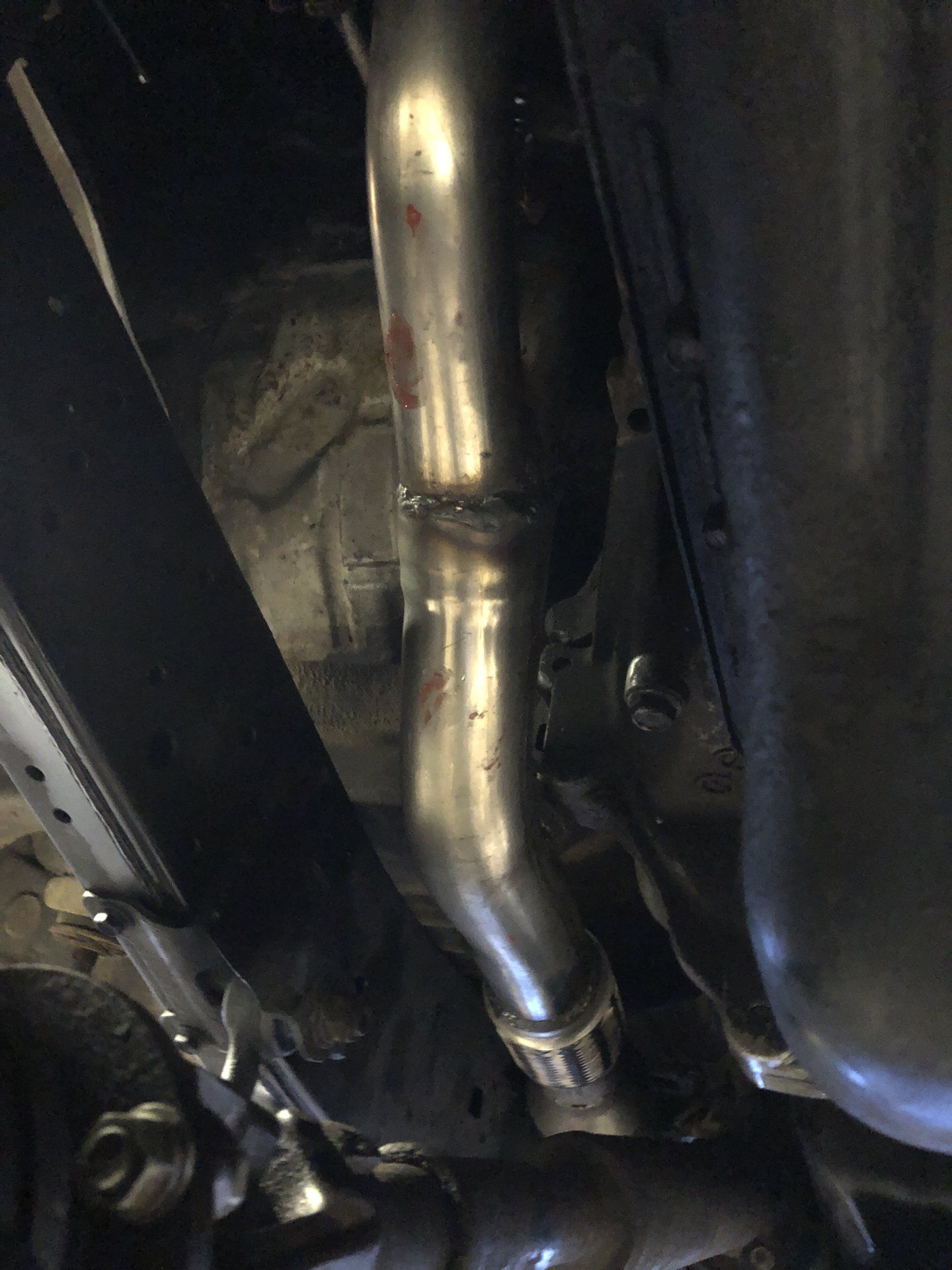

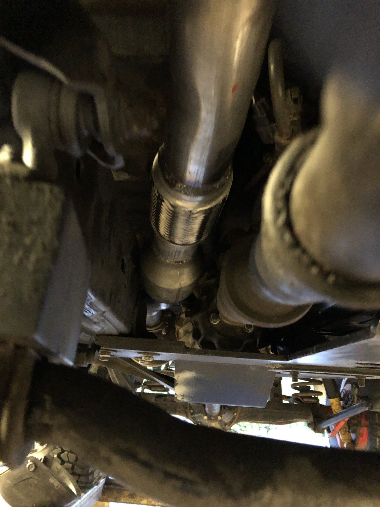

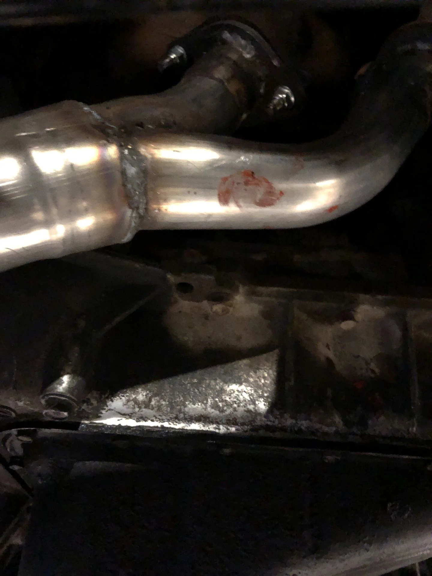

Bring your truck to A1 Muffler in Everett. Wayne, the owner will make you a complete exhaust system from exhaust manifold back for a reasonable affordable price. Stop by at my house if you like to see his work on my truck. I can introduce you to him if you like. I brought him the cat converter and muffler of my choice and he did the rest for only $350 out of the door.
