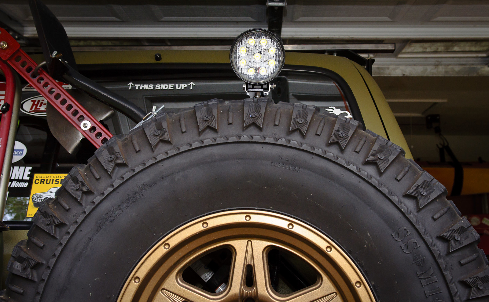

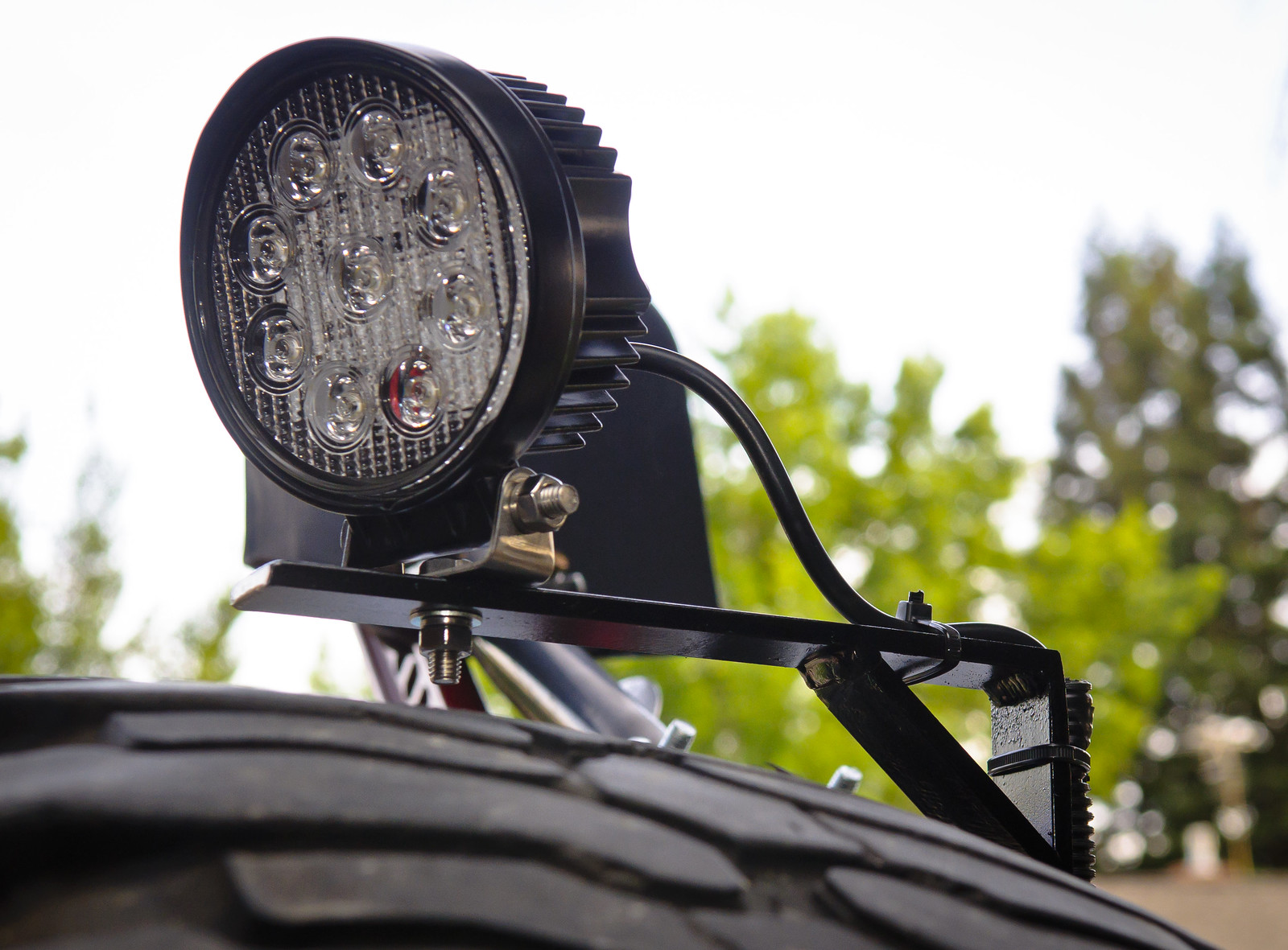

BACKUP / CAMP LIGHTS

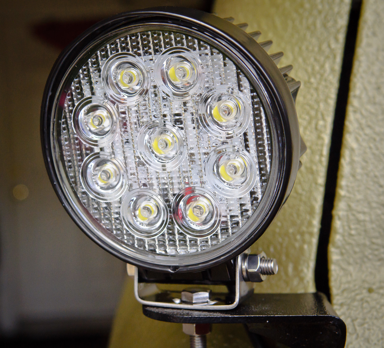

Well since I moved LED pods up to the front to serve as ditch lights, I needed something for the rear. Decided to get something a little different for the backup instead of another set of 4 LED pods. They were nice, but the light output wasn't what I was looking for. I wanted to throw a good amount of light behind the truck for backing up since most of my rear window is blocked (and tinted dark).
Searched Amazon and found some 9 LED 27w 4.3" round work lights at 2150 lumens. These are all over eBay and have been for a while. Amazon had these at $36 shipped for a pair. And 2 day shipping? SOLD! http://www.amazon.com/dp/B00F4SO446/?tag=ihco-20

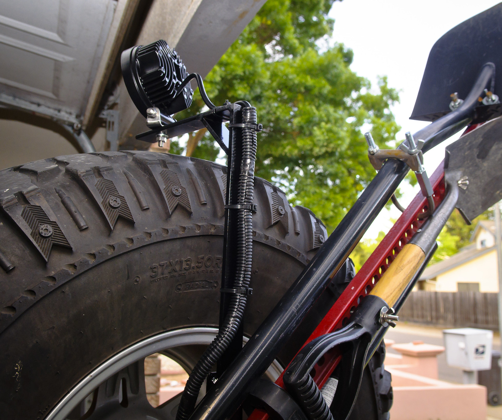

Started by ghetto fabbing a light mount out of 1/4" flat bar, welded to my tire carrier.
The lights are stout! Aluminum housing, thick glass lens, heck - they're built better than the fancy pods I have up front.
Big ol' hefer
And BRIGHT!
Can't remember if I posted this before - but I had also added a ground cut-off switch. Comes in handy when at the campsite. Turn the lights on from the inside, then I can quickly turn them off from the outside without having to go back in the truck :)

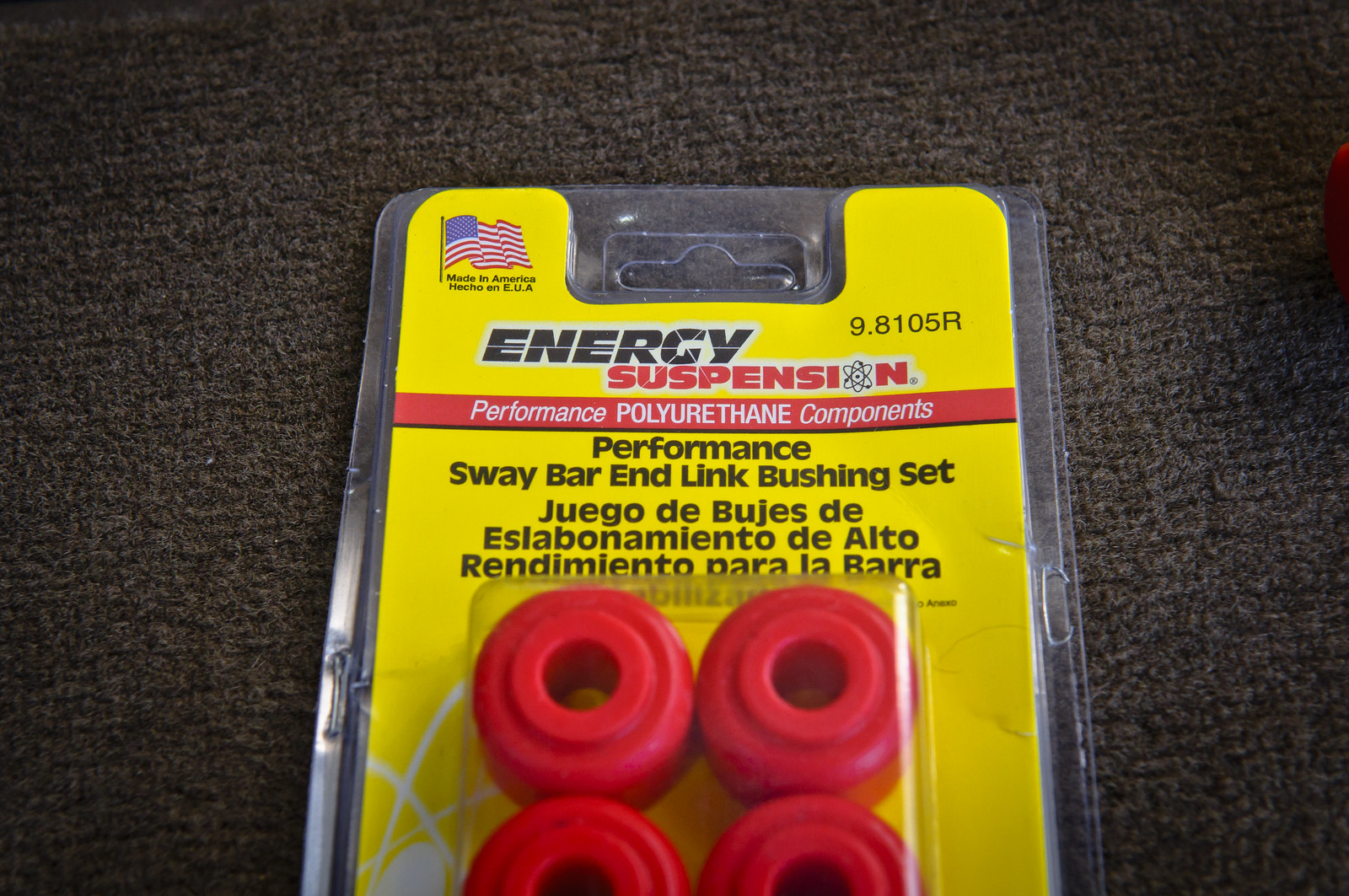

REAR SWAY BAR BUSHINGS

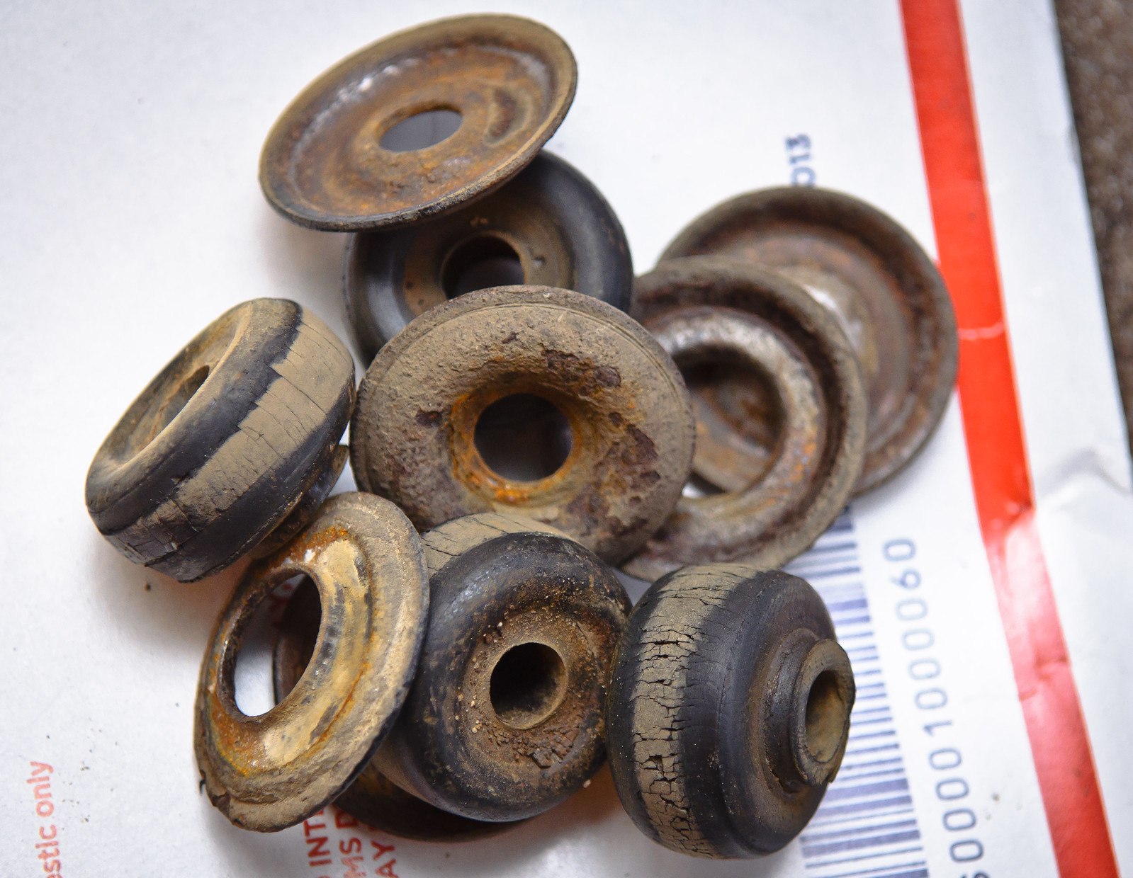

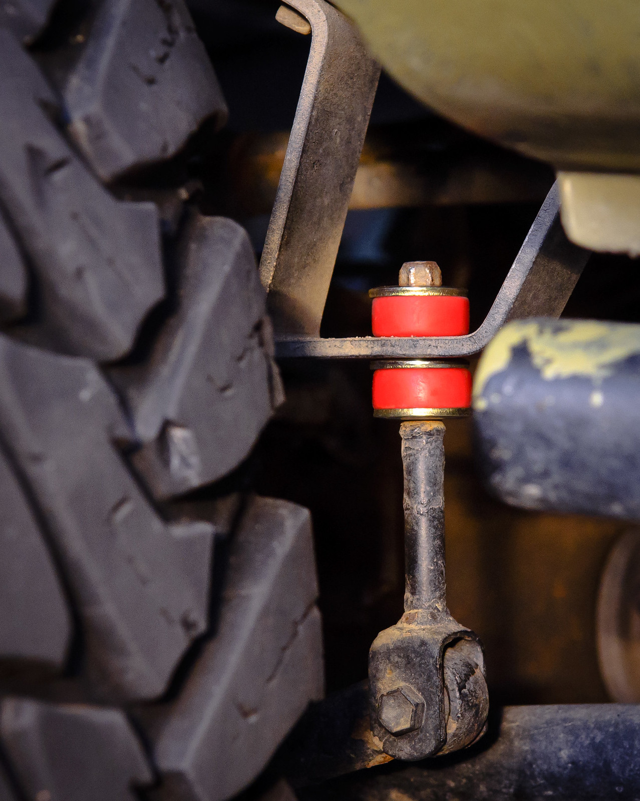

Rear sway bar bushings were shot - most likely original. The bushings in the ends of the sway bars are also shot. Ordered these from Toyota and they should be here soon. Couldn't find any aftermarket poly bushings for these. Anyway, did some searching and it looked like these would work. $14 on Amazon and 2 days later (can you tell I'm an Amazon whore?)
But wait, there's more! These come in a pack of 8. You only need 4 for the sway bar, so you'll have an extra set for when these go out.
Out with the OLD. Not bad for 18 years of service.
10 minutes later

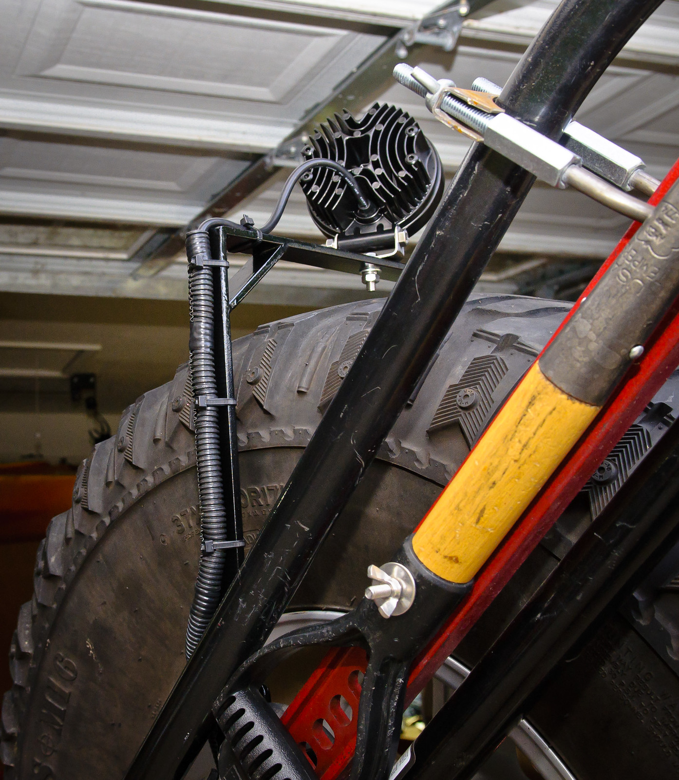

Do you have a write up on the internal wiring set up for rear lights. What did you tap into, where is switch on dash, how did you run concealed wire from front to back?
Never did a write-up on the wiring but it's just like wiring any other light setup; fused line to the battery/lights, relay for switch wiring, etc). I decided to run the wire under the truck along the frame in wire loom. The wiring for the switch comes in through the firewall. Switch is on the console near the shifter where the 4 blanks are.
thanks. so you don't have it tapped into the back up lights so you can turn them on/off if you put truck in reverse?
Not when I had these lights, they were manually activated via a switch. However that whole setup has changed. These lights I just installed on my tailgate are wired directly to the reverse lights without a switch.
