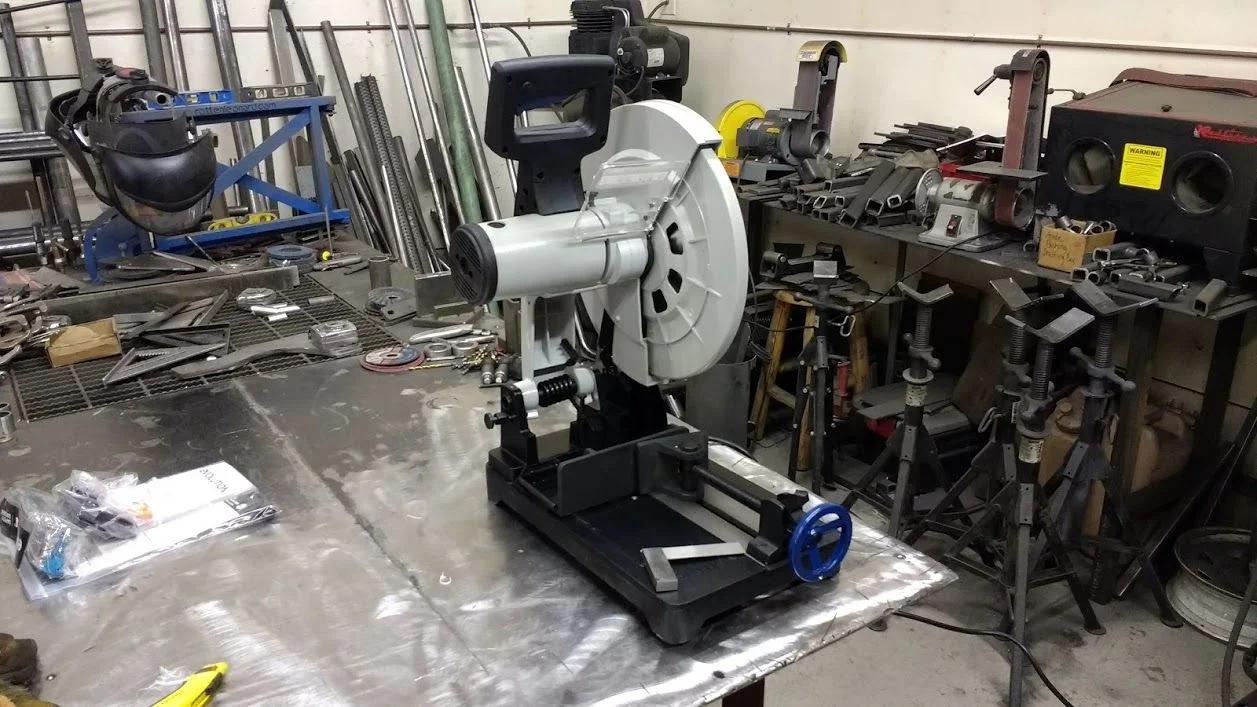

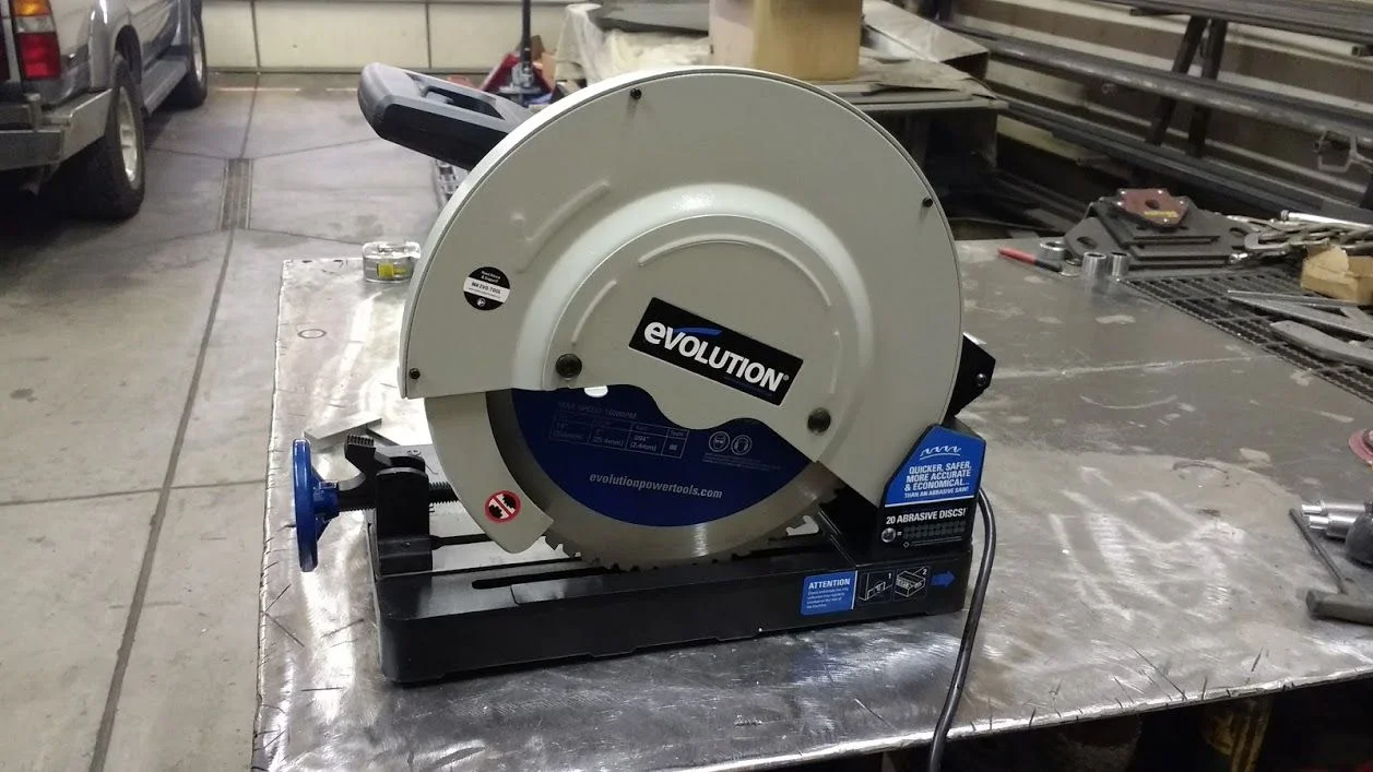

My old Dewalt abrasive saw finally started giving me issues so I bought a Evolution 380 cold saw. With as much as I use these saws I probably should have bought a Kalamazoo, Scotchman or Baileigh. But didn't feel like shelling out 850-3000$ for one.
I figure if the Dewalt served me well for 3 years the Evolution should go a little longer.
I love the no spark cutting of this saw compared to the firework show of the abrasive saws. Plus the cut is "cold" right after the cut. Yes, you can grab the cut end as soon as its done and it is "cold", bare handed.
It has a chip collection tray which collects about 50% of the cut. The remaining is around the saw.
Saw is HEAVY DUTY and the angle adjustment is far superior to the entry level saws (Dewalt, Milwaukee, etc..) The blade key acts as a ZERO angle stop for the guide fence.
This is a 15" saw with a 1450 rpm/ 15 amp motor with a weight of 62#
The degree finder to blade is off approx. .4 degrees (not bad for a mass produced saw) need to get that adjusted.
Just thought I'd share a little.

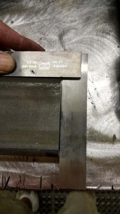

That looks pretty sweet. It is pretty hard to get a cut that square with an abrasive blade.
Correct! I usually use an abrasive for only non critical/rapid cuts. I've always used the band saw for tighter tolerance cuts. But, now this may be my go to choice. It 5x faster than my band saw with just as good of a cut. I have the gate adjusted now and the cuts are within .15 degrees now. I can live with that. I cut several shapes and thicknesses today and all were in that tolerance range.
.750" x .065" HREW to 2.25" x .250" DOM round tube
.125" to .500" x 4" strap
2" x .188" to 4" x.375" square tube
3" x 2" x .188" rect tube
All smooth cuts and no lugging this motor down. Steady pressure and it slices through the metal with ease.

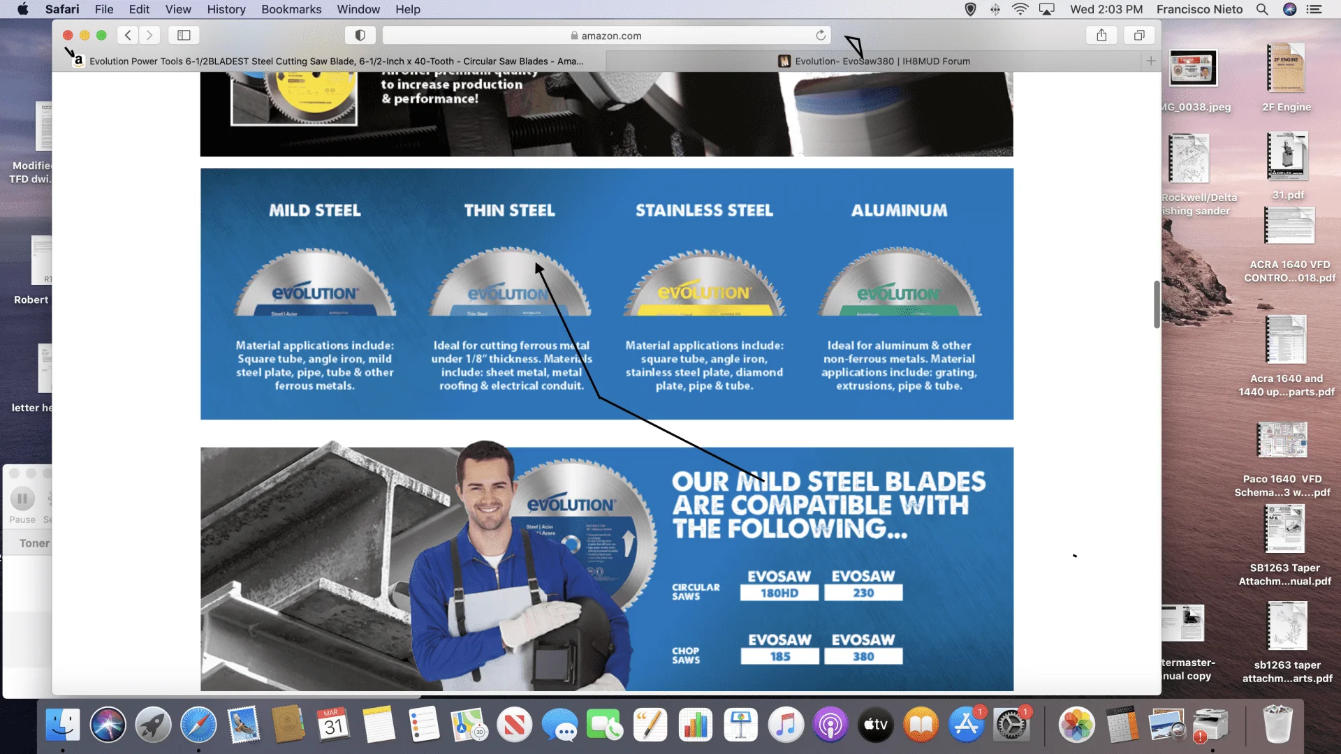

Would this saw work well for sheet metal, like steel 2x4" framing for example?
Evolution offers four kinds of blades. They do offer one for thin steel under 1/8" that would work for metal studs. I would assume one would have to introduce it slightly slower to prevent "catching" but should work very well .
Thanks Paco.
