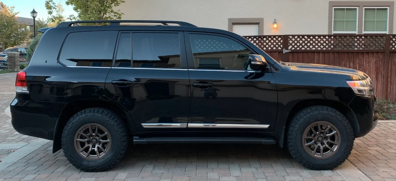

I agree on the fake bolts, but that's why i like the vectors, since they don't have those. The Evo Corse are my favorite as well, but lead times and double the price, i would probably end up with either the Vector or one of the +35mm AlphaEqupt in either the Foxtrot or the Command (pictured above).
Here's a filtered search on TireRack. Not sure if it will work Tire Rack Alpha Equipt Models with +35mm Offset

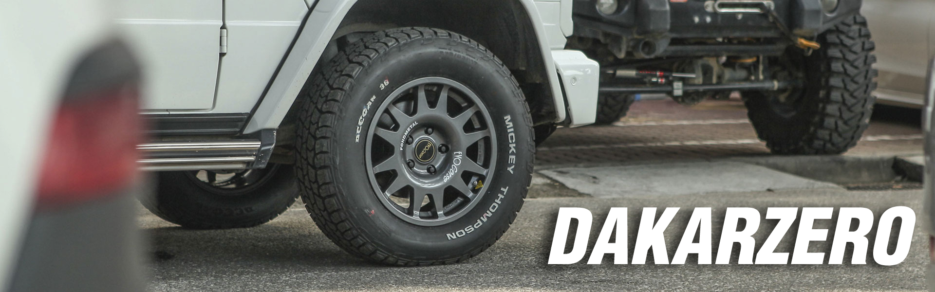

Evo DakarZero
"DakarZero is the low offset version of the DakarCorse: a wheel dedicated to off-road, cross-country rally, and rally raid.​
The spokes internal to the tire edge protect the mechanical parts from stone chippings and sand, while the wide hump profile allows the use of tires with a low inflation pressure that increases the car stability even in the most demanding conditions. Moreover, the powder coating in three layers provides wear resistance higher than the average and assures the good appearance of the alloy wheels, even after a probing race.
DakarZero is available in 14, 15, 16, 17, and 18 inches and can be machined for any application."

Thanks, @bloc - they have some extra DakarZero (not the Dakar SuperZero) on a container coming in Dec or early in the year. I put an order in for a set of five 17x8 ET40 in Anthracite.

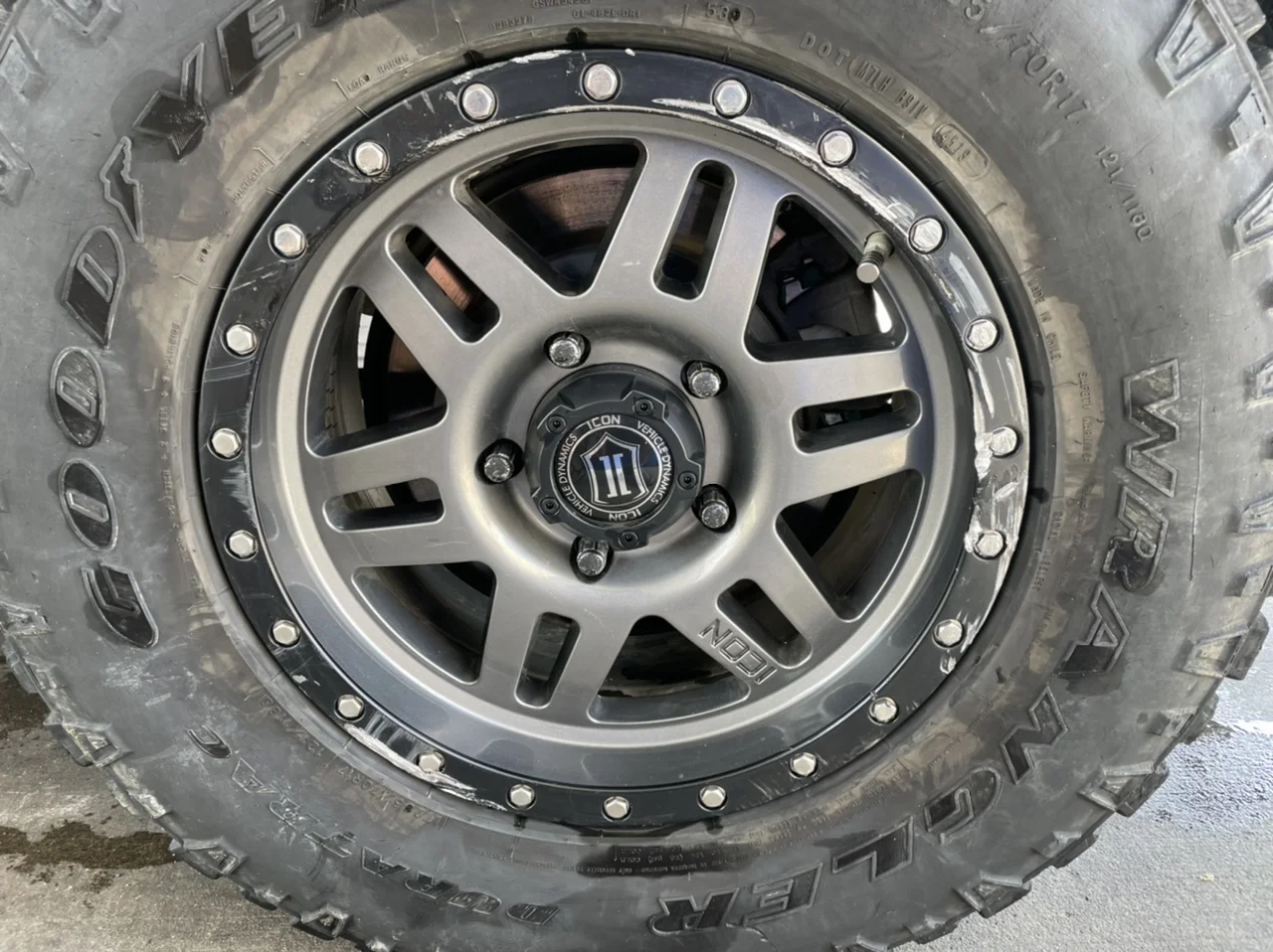

Don’t worry about the fake bolts on the Icons, they will eventually just rub off on the rocks…

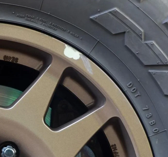

This is one of my old wheels after one of my first trips. Another wheel had similar damage but didn't chunk the powder coat. The chip never got worse to my knowledge, which is a plus. All this to say, if you use your truck in the rocks, don't be shocked if yours end up looking the same. Or just place your wheels better than me. Wheels, and similarly tires, just get beat up with use; but when they cost a little more, it also hurts slightly more. At least to me.
Yeah, I expect them to get torn up. Part of the cost of doing business. My current tundra trd rims have gouges out of them. These are still cheaper than new bbs trd rims and I got 17" rims, so I can have more rubber.

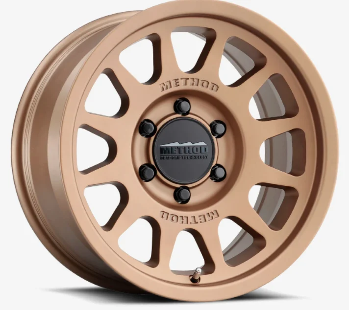

Anyone consider Methods? The 703's come in 17" and are 35mm offset. Method's are doing their Black Friday once yearly sale at 15% off and I am seriously considering pulling the trigger. On the fence between the Methods and the Icon Vectors... Need to make a decision fast, would hate to miss the 15% sale. Anyone have a 200 with Methods? (Would love to see a black with bronze wheel picture)

I reached out to Method asking about non zero offset 17" wheels, and they told me: We carry the MR703 and 705 series wheel which comes with the +35mm offset.
Methods are definitely a more economical choice, even more so with the current sale.
