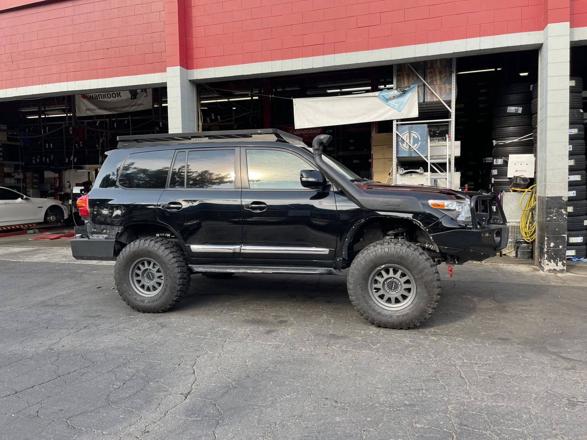

IMHO 34's just don't look big enough for these fat bottom girls. 35's seem to be the perfect size but they do introduce other possible issues for us LC guys. I go back and forth between +25mm offset and 34's to avoid issues and extra steps or +/-0mm offset and 35's with a KDSS relocate kit to get the look that I'll stay happy with.
The Cruiser below is on 35's with 0mm offset Method 704 wheels and IMHO it's the perfect look for these trucks. Decisions, decisions, everything is a trade-off.
I agree it looks great but I have to wonder how much rubbing there is.. aka trade-off.
