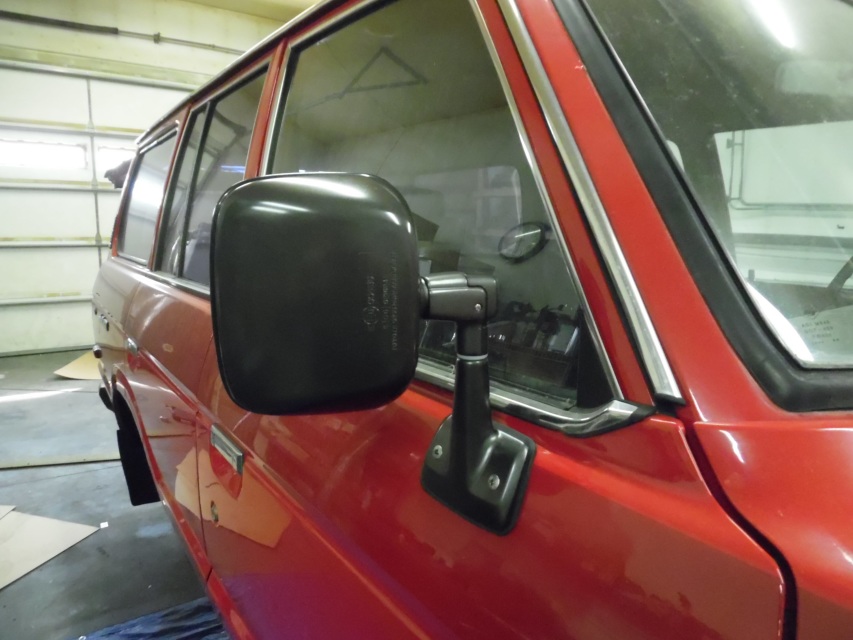

I am in search of some OEM replacement mirrors for my FJ60 and really like the looks of the OEM Euro mirrors. I feel like they would be a upgrade to my factory mirrors that are currently on my 60. So far I have been doing some searching and the only ones I am finding are eBay. I would rather not use eBay. Does anyone know where I might be able to find a set? I am also open to other recommendations/options.

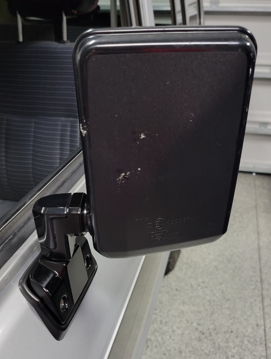

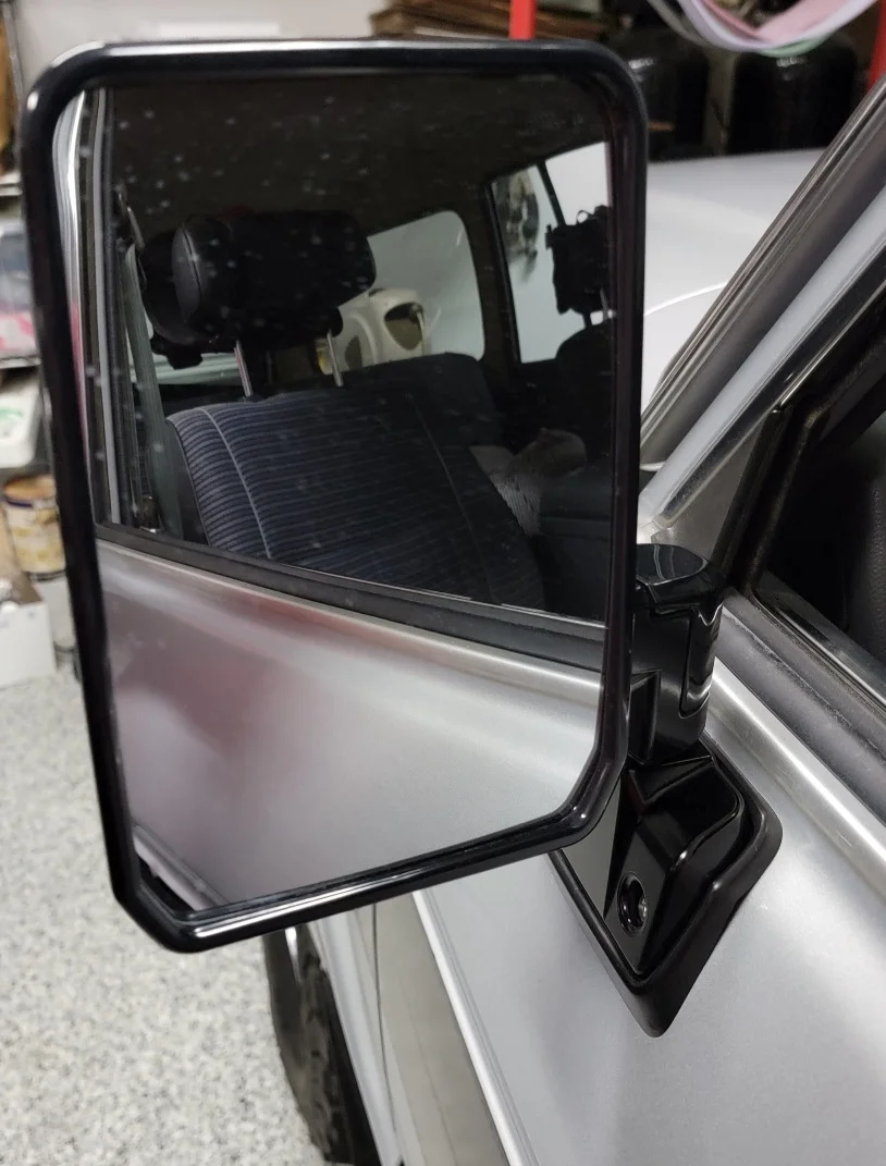

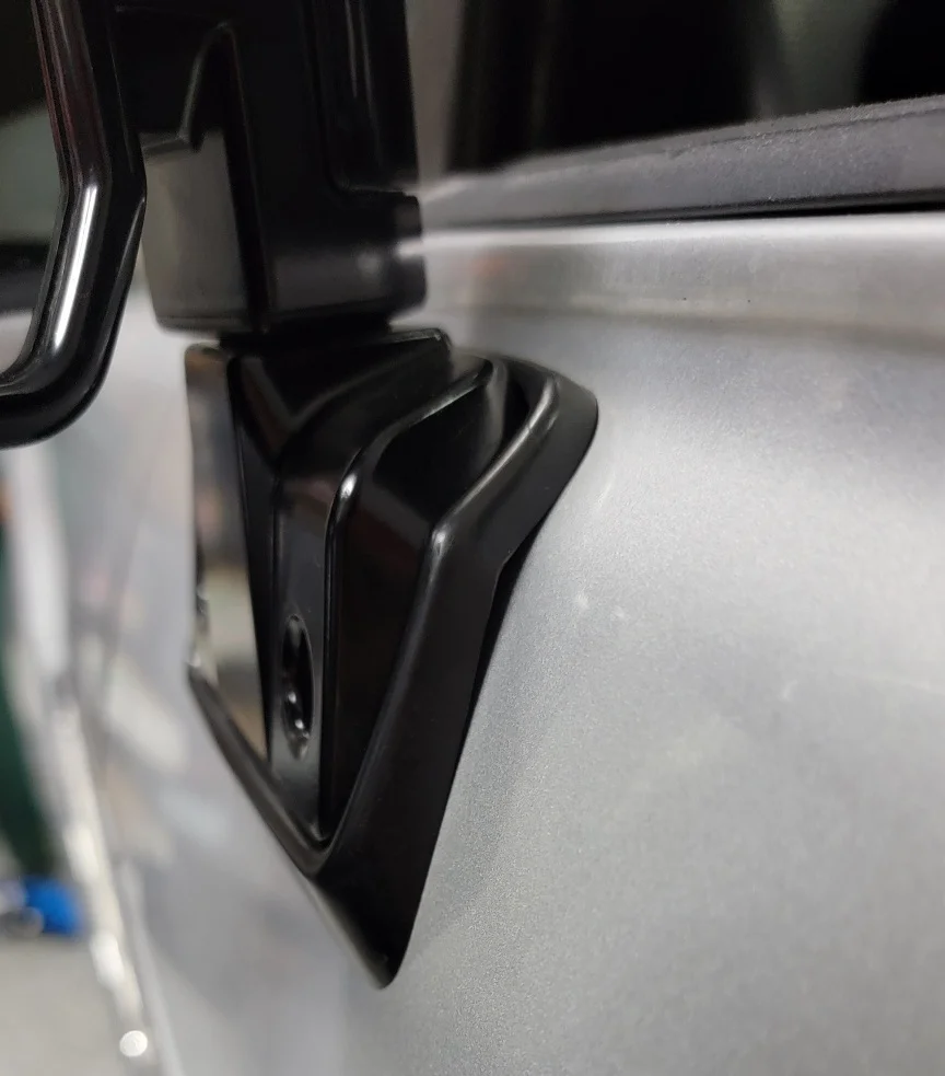

Both of those show out of stock. I ended up buying the 70s series mirror from eBay. The gasket is not a perfect fit. Water can get behind it, but the only thing behind the door of the mirror is the 2 holes the screws go in. Gasket does a fine job of protecting the paint.

I'm betting a bead of FIPG on the body side of that gasket will help prevent water ingress and corrosion on the screws.
Question though: are those on a 62? If yes, how shaky are those mirrors compared to the 62 electric mirrors?

I bought mine on eBay, but if the 62 has electric mirrors, you might not want mirrors for a 70. The gasket/mirror do not perfectly match the contours of the door, thereby letting water get behind, and if there is an electrical tail penetration in the door, it could let water inside the door through that opening. Link below for the mirrors I bought, pictures on the door in an earlier post of mine in this thread.
it is possible to design and 3d print a TPU gasket that mates between the 60 series door and the 70 series mirror. I'm not the right person to do that but it's definitely an option
Honestly that'd be the best approach. @CruiserTrash what's your thought on this?
