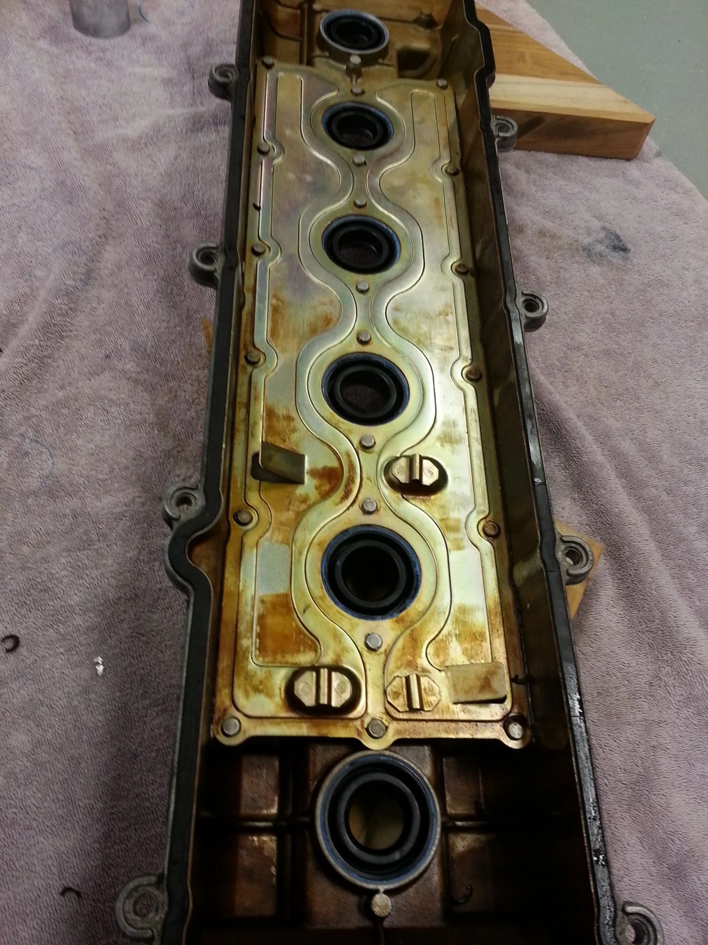

As I have sat here reading your entire thread, I can understand why you are beyond frustrated!
Something that I started thinking about that MAY tend to be a bit erratic are the spark plug tube seals / valve cover gasket. If these are failing (or loose) they could move around or have leaky areas in them that will allow unmetered air into the system (through the PCV system).
I have noticed how horrible they run/idle when you remove the oil filler cap and was wondering if by chance it was a similar effect.
Change the spark plug tube seals, valve cover gasket, PCV grommet, and the oil filler cap and see what happens?

I appreciate your patience to read through the thread and that you have brought something to the table not yet proffered.
While I will not discount this new direction out of hand I will say that of the new items to address only the filler cap has not yet been replaced. One of the things I did after getting this 80 was begin addressing the oil leaks and a full tune up.
So part of that process was new tube seals, PCV grommet, cover gasket and a little sprucing up of the cover itself.
I will have to eyeball those areas again and see if something has changed since I did that work.

Damn! That's PURTY!
Well,.......It was worth a shot and I didn't see it mentioned........
If'n I thinks of anything else.....I'll leave the light on for ya!
Damn that is good looking. Never would have thought about those seals. I heart MUD. Even if MUD does not love me back I still love you.

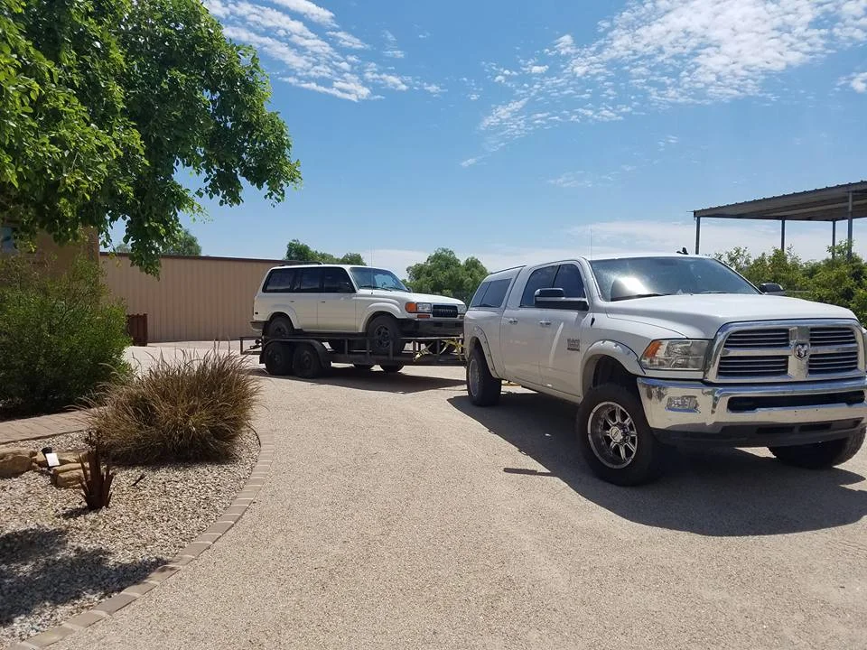

Well I have exhausted my efforts, "OSO" has been generously accepted Home to CBT for some professional help.
Loaded and ready.
I went through the sme pains with my 93. After 10 minutes out came wd40 to look for intake leaks. Quick sprays around accordion folds on intake tube and idle smoothed. Duct tape was the quick fix. Toyota wanted like 180$ So I made my own. The leak only affected idle. You couldn't see the split but the o2 sensor noticed. Idles so well you can't feel it. Different mechanic different diagnosis.
Dropped "OSO" off with Murf this morning.
Go figure, yesterday it would not run and was a chore loading. This morning She started right up, ran beautifully for unloading and relocating to the designated parking spot at CBT.
Siknut, you have your work cut out for you. Treat her well and send her home good as new if you please.

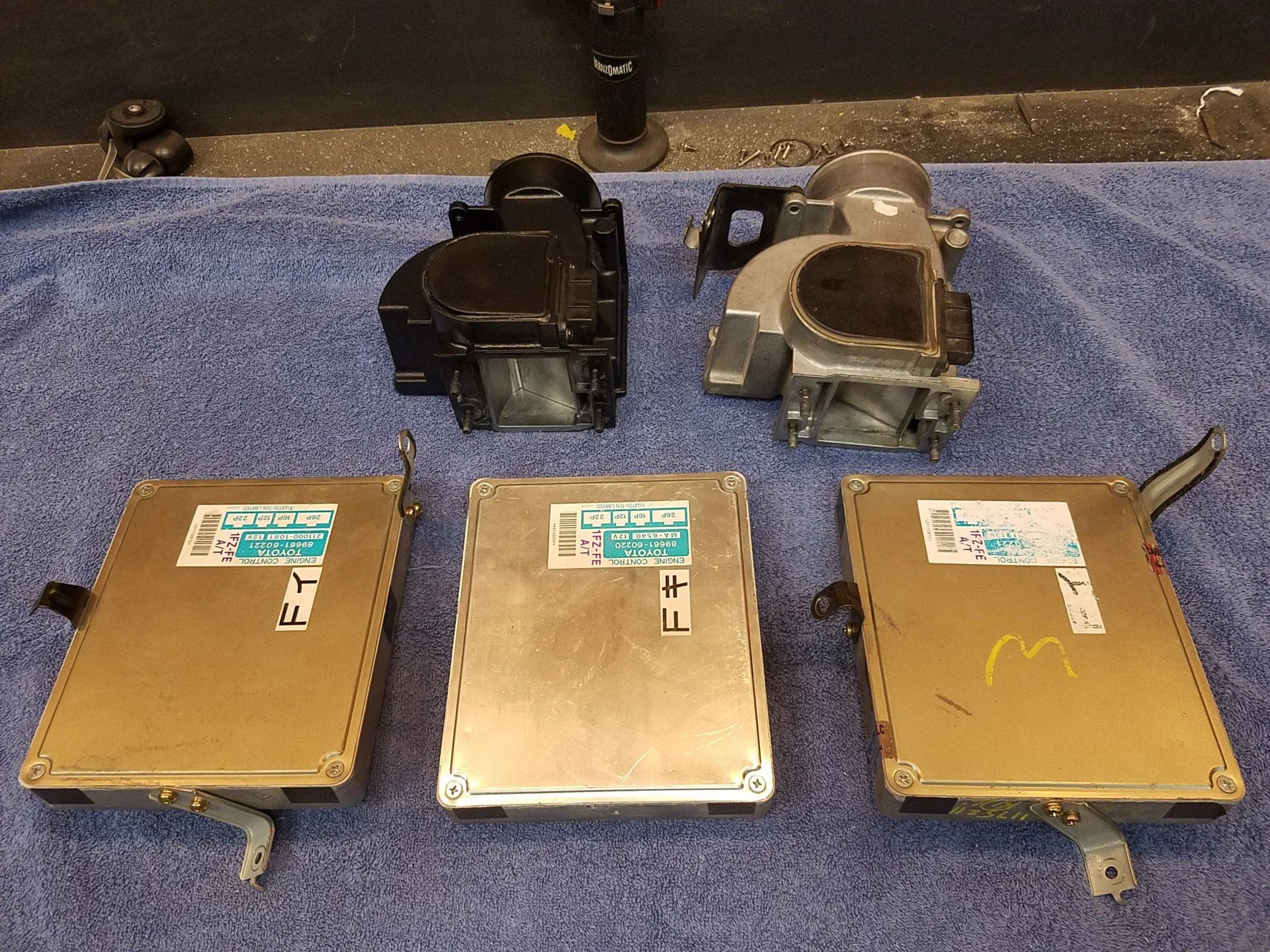

Wanted to add a follow up to this so that others reading/following this know what has transpired.
"OSO" spent about 3 weeks at CBT under the care of Murf and Tom. The conclusion was that the symptoms were the result of a bad/intermittent VAFM. The unit on "OSO" was a "re-manufactured" unit from Cardone that I installed just slightly over a year ago. I tracked down another unit and delivered it for Tom to continue his testing.
During this time, the alternator blew up on one of Tom's test drives:steer:...yea, when it goes down hill it goes down hill.:bang:
Tom replaced the alternator and continued testing. The stutter/stalling was now gone, apparently thanks to the newest VAFM, but now the EGR was throwing CEL 71 again. This had been resolved for a while but now it has returned. Tom went over all the parts already replaced and went back to the VSV and installed a new one. No Joy. Tom had a conversation with the engineers at Toyota and they said it was a bad ECM. The reasoning is that in the '93 the EGR temp sensor that the ECM is looking at for the 71 code does not exist. It does exist on '94 and newer but not '93 and earlier. So if the sensor doesn't exist yet the ECM see's it as bad it must be something wrong with the ECM.
The ECM is yet another Cardone re-manufactured unit I installed about a year ago. So I took the original unit, another "Known Good" unit I bought from a fellow "Mud" member and a California spec ECM a Mud Member sent me. No difference, so I bought yet another ECM "Known Good" from a fellow "Mud Member" and installed it. No change.
So as it stands currently, "OSO" is running really well (apparently due to the latest VAFM) but showing a continuous CEL 71. Tom is going to have more discussions with Toyota and see where things can go from here on the "71" issue and it looks like I am starting a ECM VAFM collection;)
