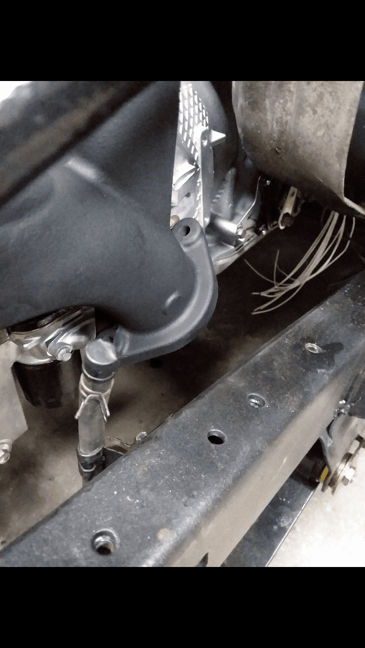

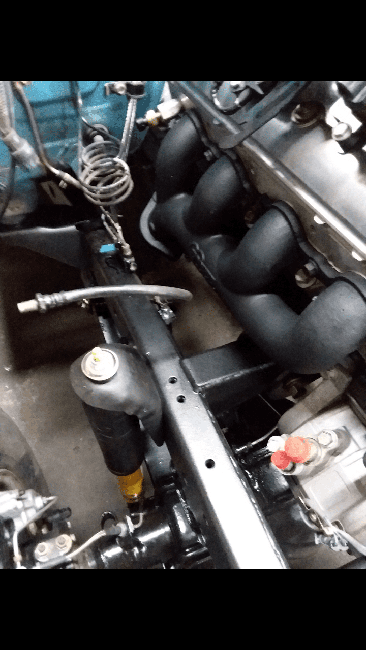

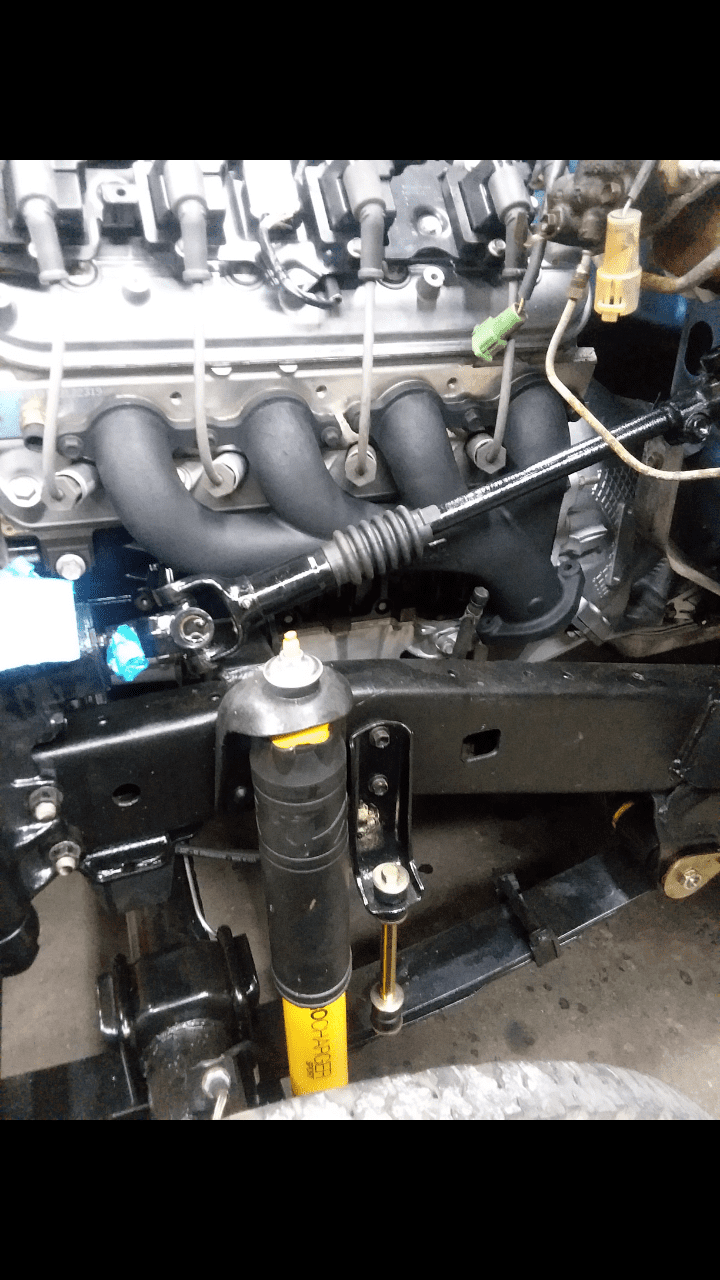

After taking forever to get my act together and stacking parts it's time to start the engine swap on my truck. A 4.8l Chevy motor is getting swapped in. I've got two months to get it finished.
When mocking up the headers and engine mounts I was able to get the mounts to clear by moving them forward slightly. Any insight on whether this is will cause any issues? The mount is forward maybe 2", the diameter of a header tube.

Also, I have similar headers, I will most likely be redoing mine with OEM manifolds. I keep burning the same spark plug wire every few weeks or so. Just something to look out for, make sure they clear the wires before building your whole exhaust.

No, I’ve had no luck with insulating sleeves. Or several insulating sleeves on top of each other even.

I used hooker manifolds from summit on my last swap mocked it all up with rear dump camaro manifolds then switched to the hooker manifolds they still dump at the rear but don't kick out towards the frame witch is great for driver side clearance.
Also might want to check and see if your ac compressor will fit with you moving the motor mounts forward
