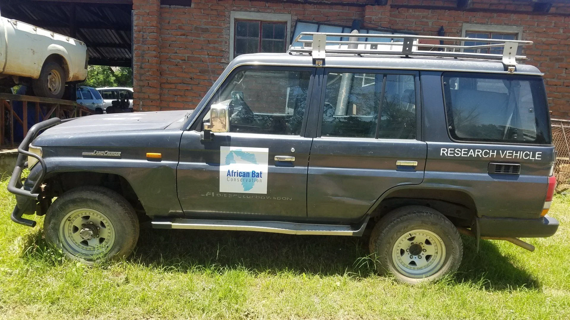

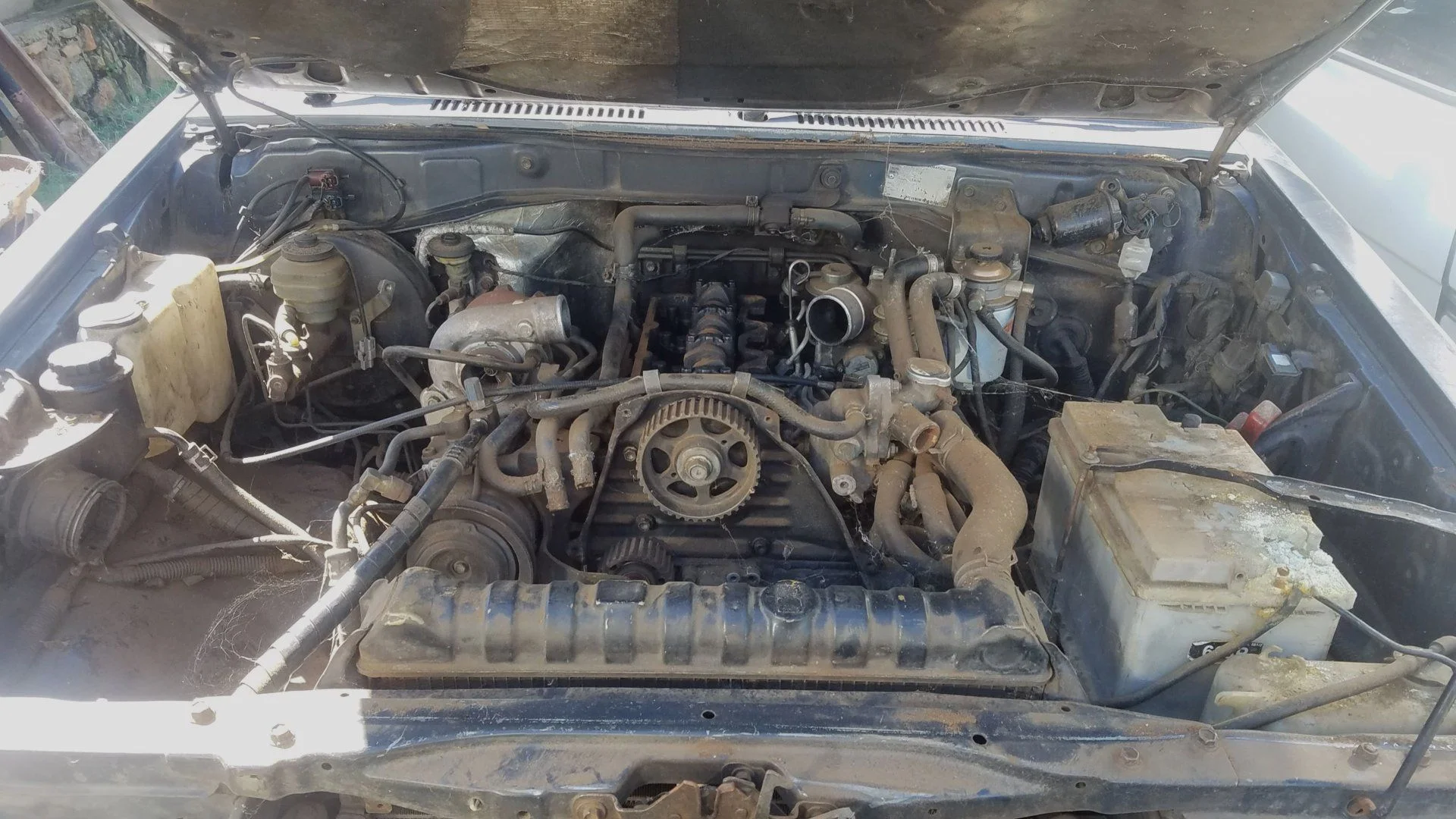

I'm new to the forum, joined hoping for a bit of help with a project I have. I work as a field biologist with an NGO in Malawi. I was recently assigned the responsibility of sourcing and overseeing the replacement of the engine in our LJ78.
First off, can someone just confirm that this is an LJ78, and the engine is a 2L-TE? For some reason it's registration paperwork says it's a 2003 3.0D. And due to some wonderful records mixups, that's all the information anyone has on it.

From the pictures, that does appear to be a 2LTE. Is it auto or manual transmission? If manual, swapping new motors in will be easier.
Your cheapest, easiest and most reliable swap option is a 3L (2.8l normally aspirated diesel). The downside is they're a little underpowered. But in Africa that probably doesn't matter. I'm pretty certain they ended up in your market via the early 90's Hilux pick-ups.
Probably the best option for making more power is the 1KZ-T or 1KZTE. These are a 3.0l turbo diesel. Will be more expensive though. And you'll have to change engine mounts. The electronic version will be more involved with wiring changes.
Another option is to find another 2LTE or 2LT-II. The turbo adds a lot of heat to these little motors and can cause less reliability.
