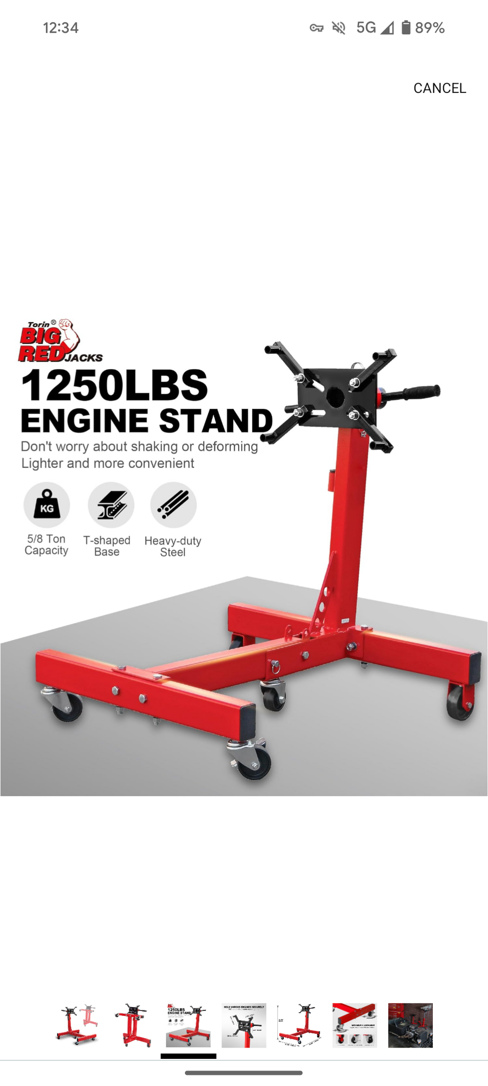

It's time to get the new short block out of the box and on a stand.
1250lb rated, should be good right? I have heard unhappy stored of floppy engine stands.
Amazon has it on sale for $109
Thanks
That's the one I own. My only complaint is it can be hard to rotate the engine without a helper.
Ahh. Thanks, I was reading to replace the rotator bar with a much longer one for that issue.
Other than that your happy with the engine stand?

This is what my other 1FZ is currently on. As stated above, it is kinda hard to rotate but doable.

The 1 ton harbor freight are really stout but the design makes it difficult to mount the engine from a hoist. I have 5-6 of the 1k HF stands and they work fine with a completely dressed engine. They are bouncy and can be braced easily if you wanted to upgrade/modify. I have 3 or 4 long blocks on right now and have zero issues. A long block weighs just shy of 600lbs, short block weighs 320lbs.
You see the black part that the engine bolts to? Grease that tube up good before you slide it into the red engine stand and the thing turns easy as can be. And I'm 78 years old with bad hands and arthritic shoulders and even I could do it. I need help pulling spark plug boots off, but I can rotate the engine slick as could be
