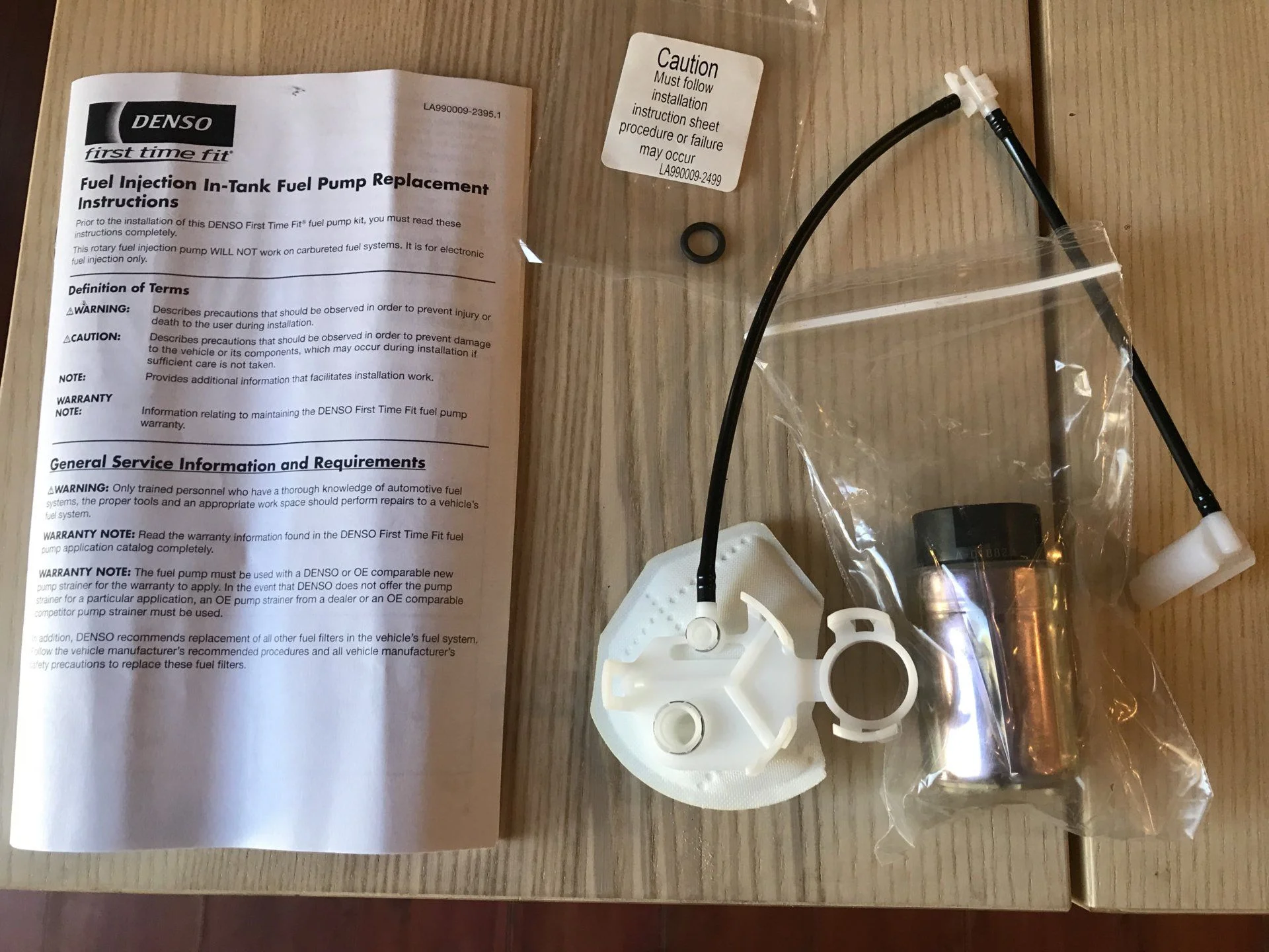

This denso, 950-0210 is the sequoia pump with the sequoia filter. I did not find the 'just the pump' number which would make it even cheaper, but still it's only $97, so way better than $300. If I would have found this out a long time ago I wouldn't have had this mess. But anyway.
If you have your black cage and lower black rubber bushing and filter if you just replace the pump portion of it you're good. Look on amazon for a filter that would fit- might fit. I bet most stock originals are fine on here, maybe.

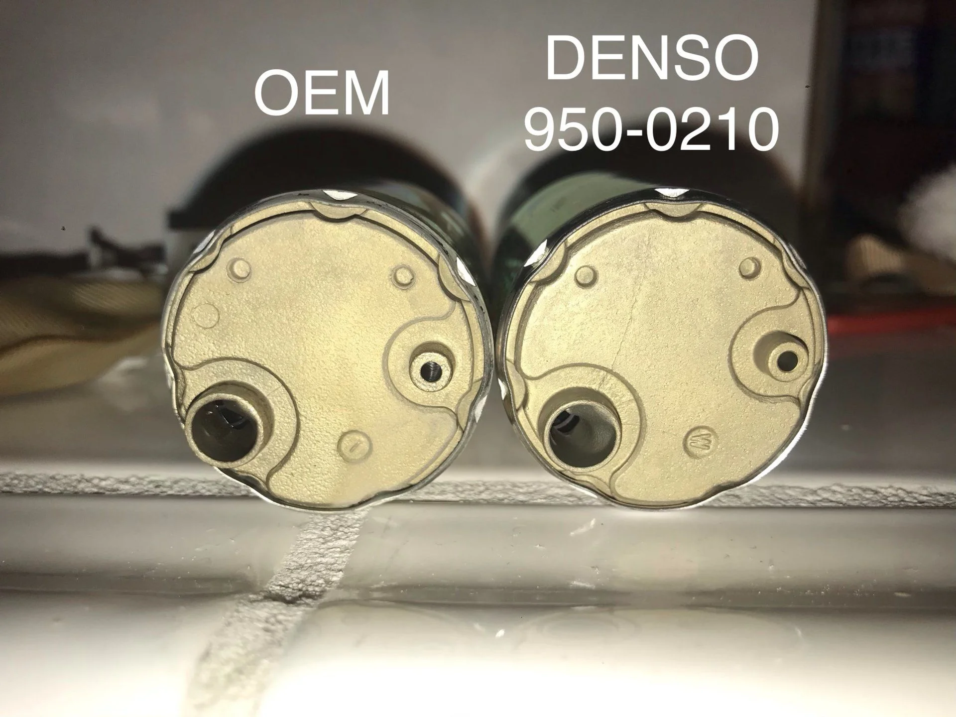

The lower pick up on that pump and the corresponding hole are offset around 7 and 10 on the clock face.
this pump is unique in the way the black removable housing holds the non return valve and associated stem oring. Also in the fact that the filter on the bottom covers the pick up hole and another small hole. I don't know what that is for. Maybe reference pressure compared to the overpressure valve in the small hole on top. idk.
The LC pump harness # is 777850-C020 , hard to find this, I ordered three before I found it for 6$ Only needed if you have cut yours before and don't like splices.
the yellow fuel line clips are 7724160320 Not needed if you haven't taken your out 20 times or so.
the sub assembly is toyota # 7702460180, that's the white part all together.
There isn't a part # for the toyota filter that I can find, I bet amazon has some that would work. maybe.

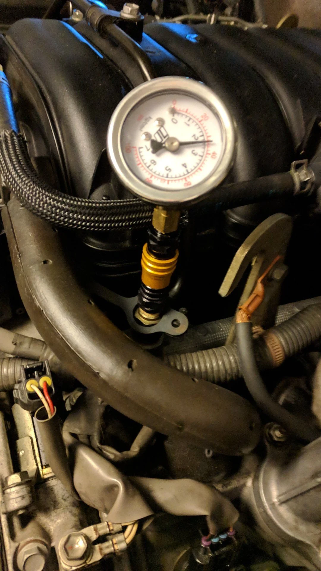

the pic is 70 minutes @ 34 psig
lastnight, one hot fuel timed, one cold this morning.

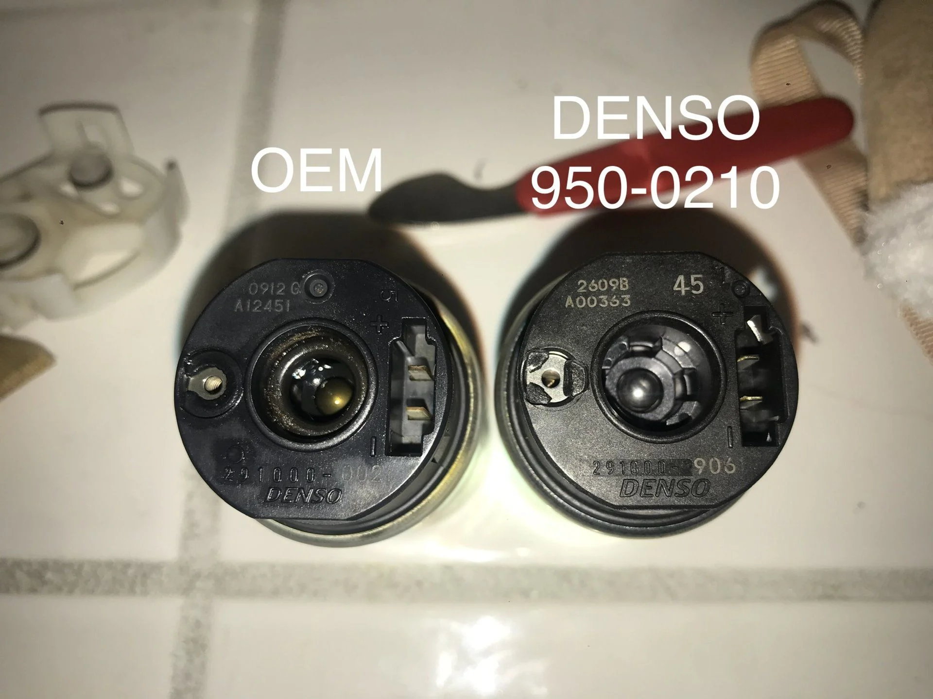

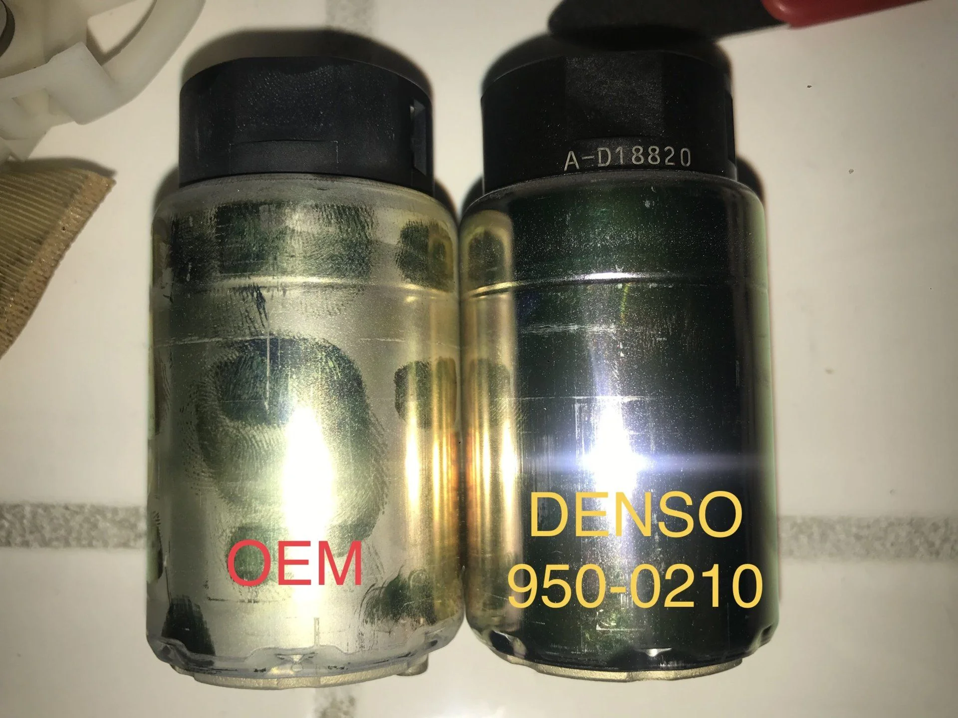

Is the first image the denso pump compared to the original disassembled pump (i.e. out of the cage)?
yes.
edit, I should add that hot psi fades faster. I don't think most people would notice. But three hours hot adds a second or two to crank times at <20 psig. I can get obsessive sometimes.
toyota says they are all in spec @ 21 or above psig after 5 minutes. They all do that without problems. It just annoys me how fast the rest backfeeds downline. Denso is definitely superior.

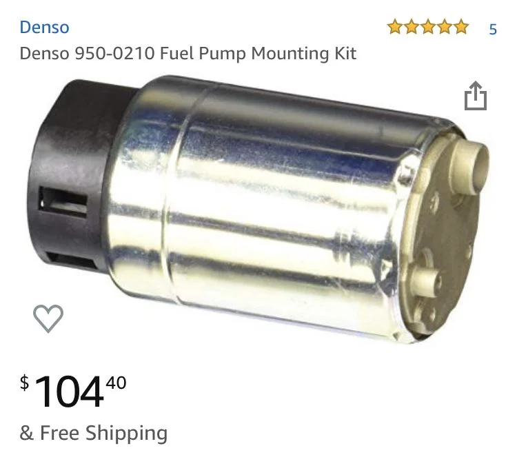

@jerryb to clarify the correct part number for an 06LX470 is 950-0210?
Amazon has one already, but just wanted to be sure I get the right one for my 2006 LX470.

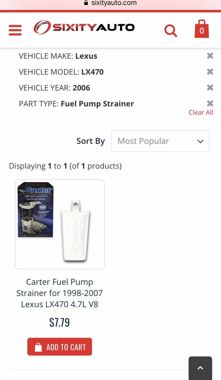

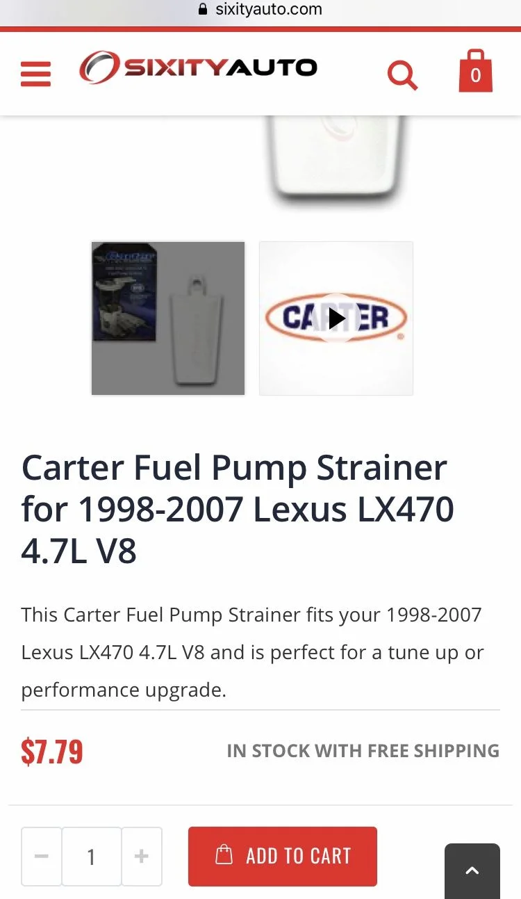

Can’t find the strainer part though
Found a strainer, has anyone tried this brand?
Yes that's the right #.
I got mine from Amazon, I was wrong in that other thread about getting it from denso.

I've a used 05 fuel pump on the bench. It's an Aisin, but PN# indicates it will not work. Wondering if it will.
This came in yesterday. On the amazon description it didn’t say the strainer is included, this one has a strainer with the pump
Ya that filter won't work. it works with Sequoia if I remember right. It's been a while.
One thing I noticed is that when I was dismantling the assembly, the plastic securing notches of the strainer assembly easily popped right out of the pump after removing the two metal hose clips. But when I was putting it back together, now with the new fuel pump and new rubber O-ring going into the strainer assembly, it was really tight and had to push hard so that the plastic securing notches would lock into the plastic cage.
