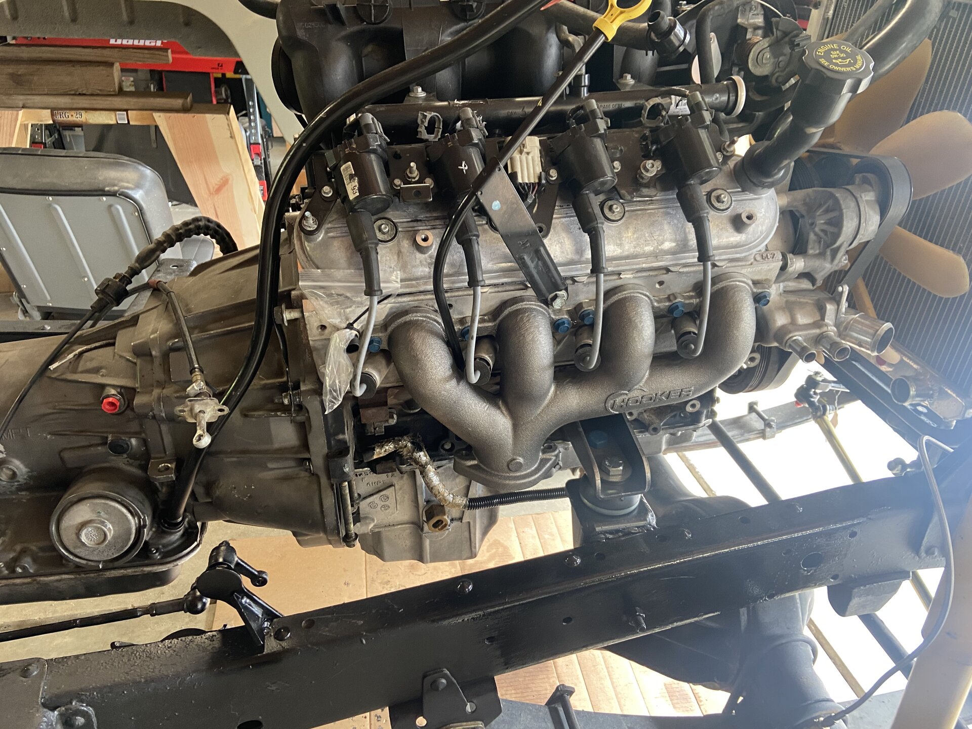

I bought a 5.3L LM7 from BD Turnkey engines and have been very happy with that motor (now going on 11 years). My current combo is:
5.3L LS / SM420 Trans / 3spd Tcase.
I'd like to go to a NV4500 or H55F / Splitcase for some more useable gears for highway and city driving (I live in San Diego) but this combo is a decent balance. If I was trying to keep it semi-original, I would get a COP motor from Mosely motors and mate it to a H55F
