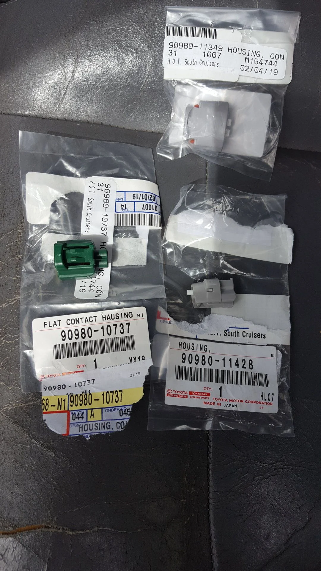

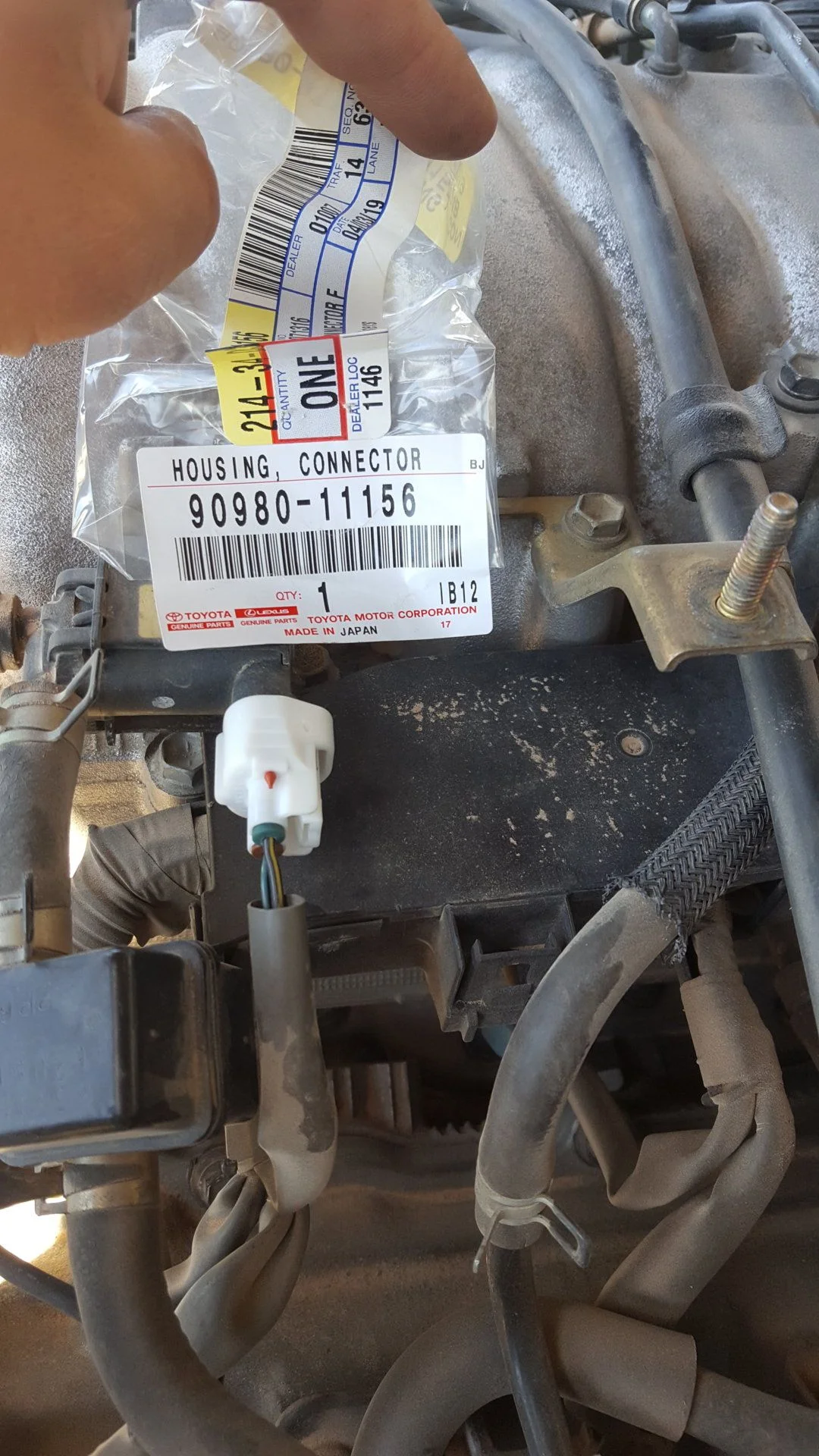

Threw the arb and sliders on that I shipped out from back home and replaced some crunchy connectors this week. They were brittle and had cracked when I had done the engine swap. Two coolant temp ones and the alternator plug.

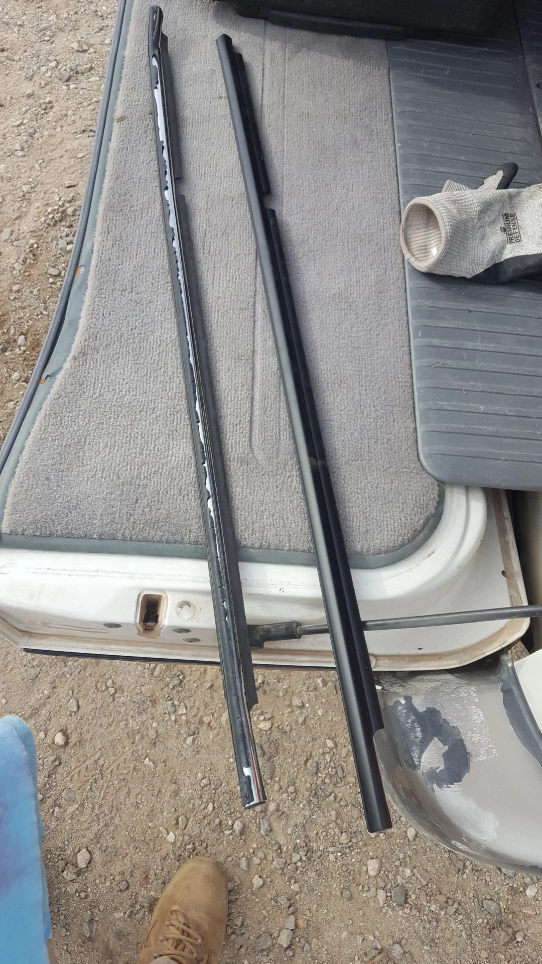

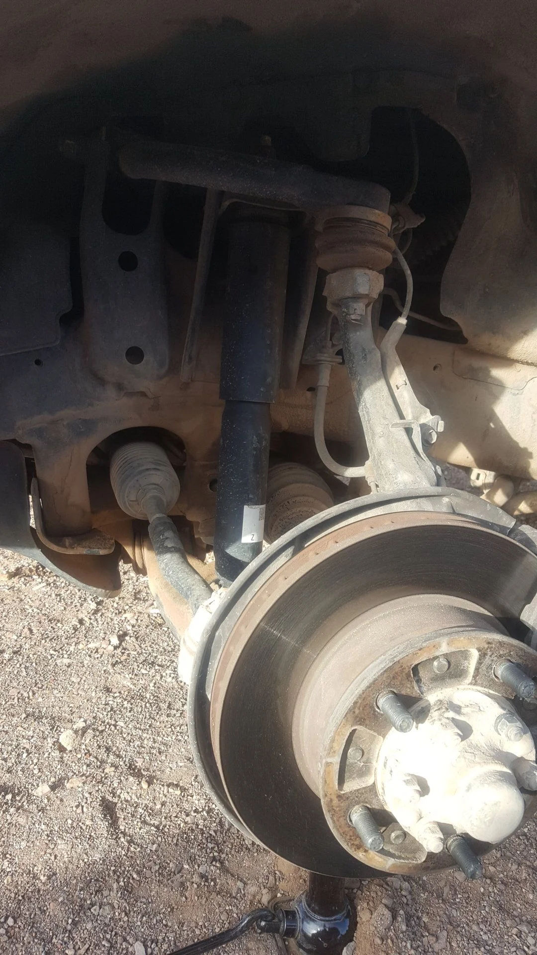

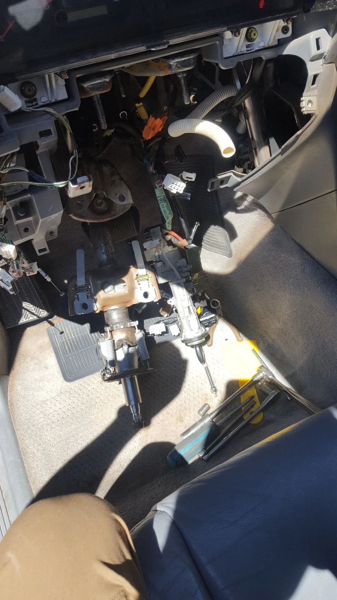

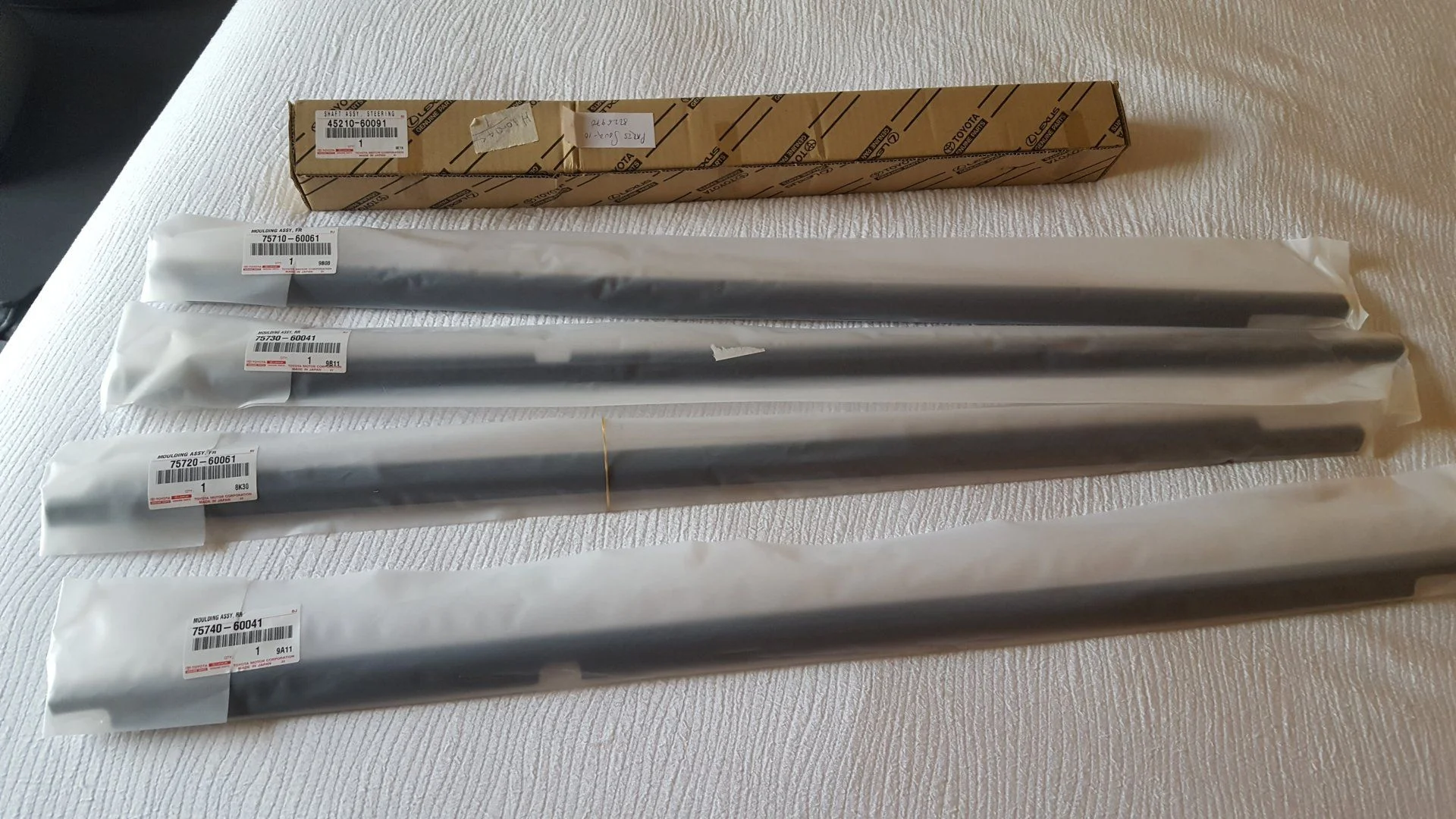

Also got a load of parts from Japan. New window moldings and steering column. When I replaced the engine I also replaced the steering rack and both outer tie rods but the steering still had a slight notch or tiny bit of slop that was driving me nuts. On rough roads the steering wheel has what’s almost like a rattle. I inspected all the linkages and the slop is actually in the column between the steering wheel and the rag/u-joint at the firewall. I can hold the u joint by the pedals and still feel the notch when I wiggle the wheel. After some research turns out the collapsible columns actually wear and cause the slop. So I ordered this new shaft and will try to throw it in tomorrow.

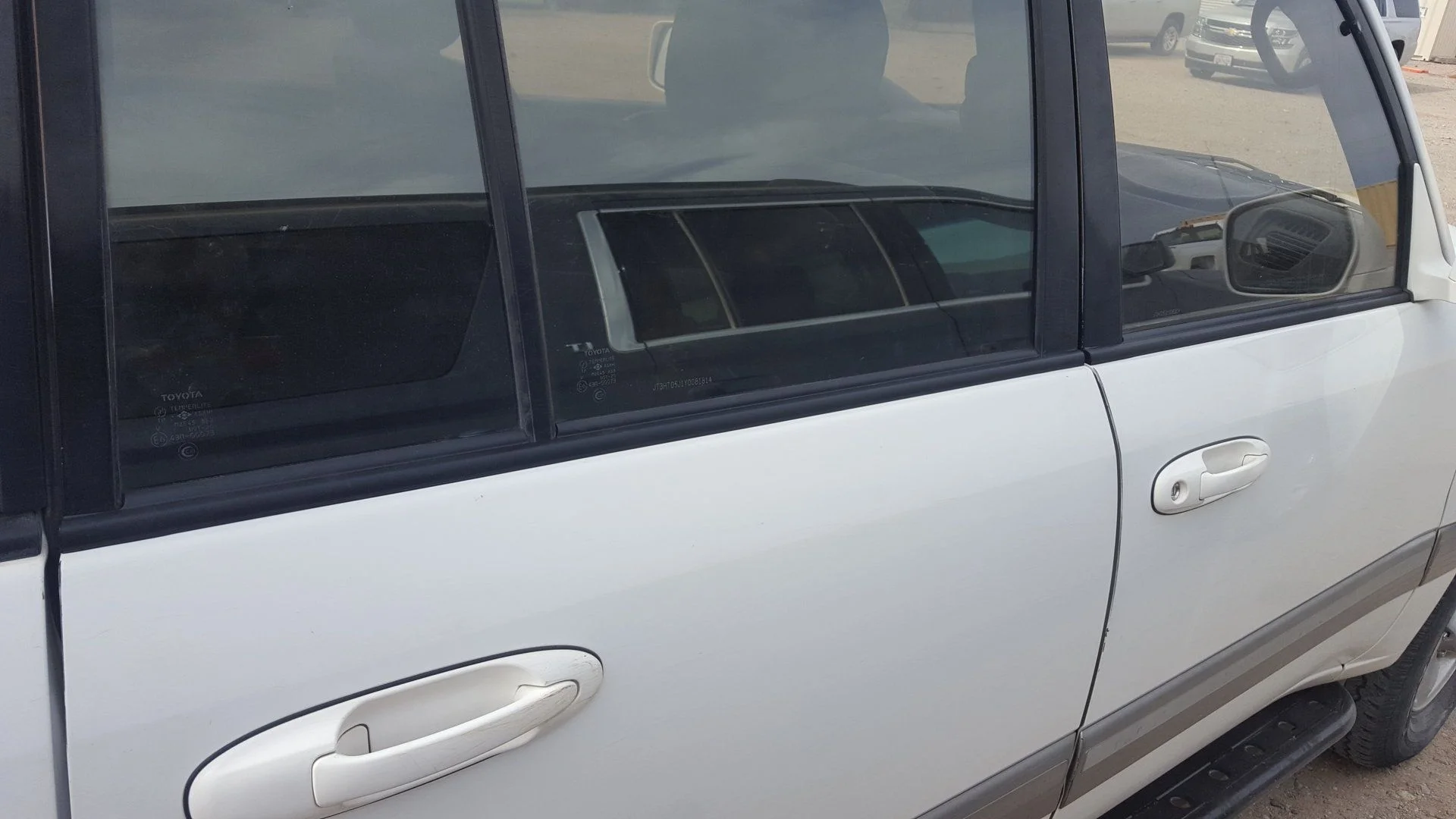

I did replace all four moldings today and man does it look better. Also contradictory to what I read the interior door panels do not need to come off. This is an easy 30 minute job.
New steering shaft went in without a hitch. It took about an hour and a half but if I had to do it again would only be a 45 min job. That fixed the rattle/notch in the steering. Drives like a dream now. I also installed some SPC upper control arms in the hotel parking lot early Saturday morning before the sun came up. A little more caster and set the camber to about a half degree in. Can't tell too much of a difference driving but it seems to track a bit better at speed. The steering wheel stays centered on it's own a bit more which is an affect of the added caster.
Carnage of the steering shaft replacement.
You amaze me with your parking lot jobs and speed!

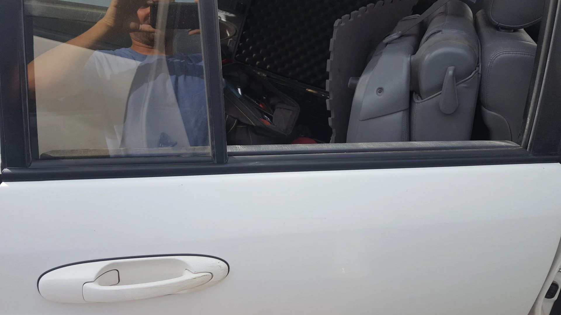

I was out at YPG end of last month and saw your truck (which looks a lot like our 04) on my way back to the hotel after a workout—I need to confess to peeking in your windows—I recall seeing some ARB component boxes in there and thinking, “kindred spirit!”
Still had the stock front bumper on it at that time, iirc.
Great work!!! May she serve you well.
Right on! That’s cool. Usually full of pelican cases for my tools. I park it on post when I’m back home, it’s cheaper than storage and I figure safe enough since you need credentials and have to go through an armed guard.

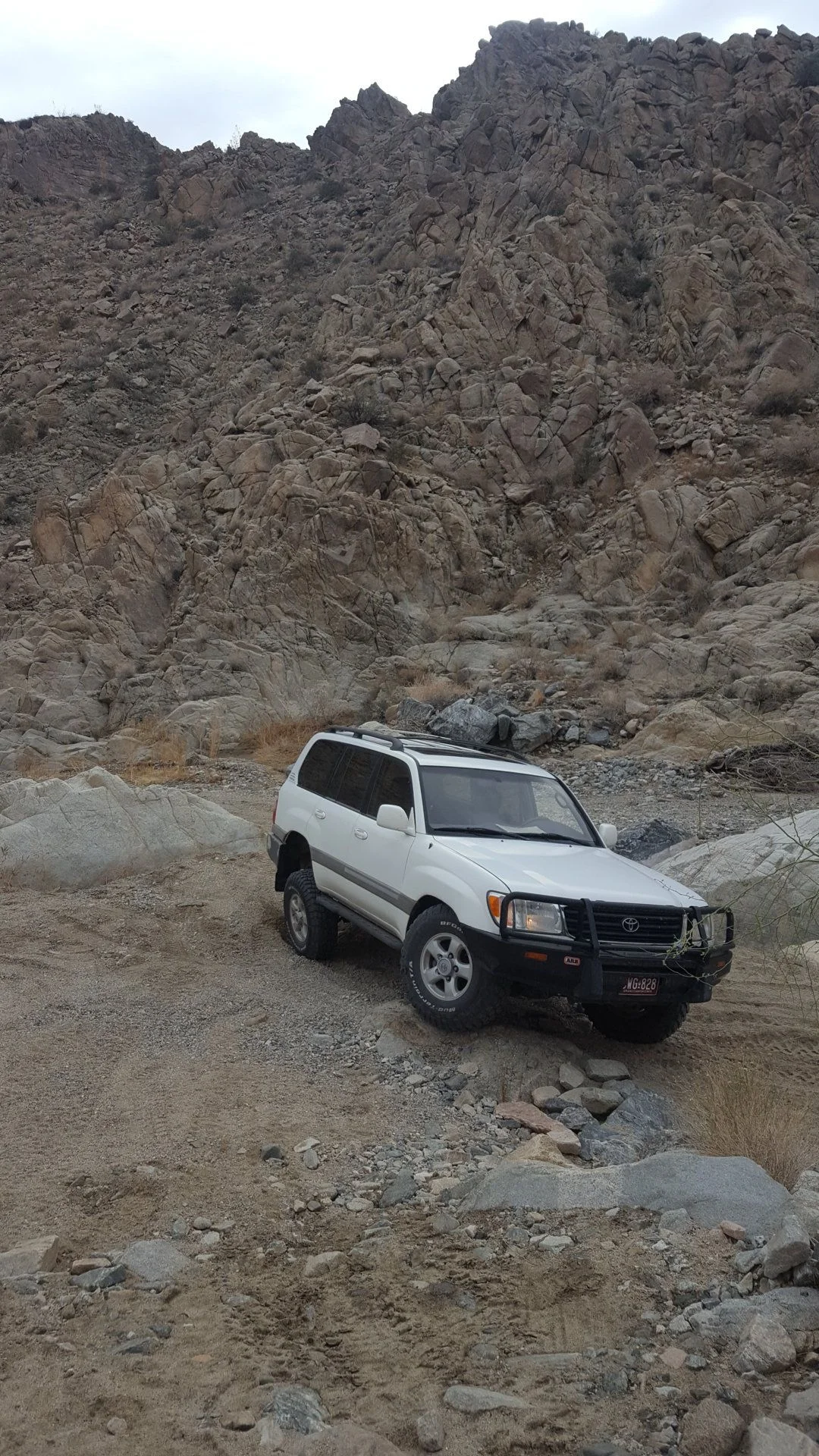

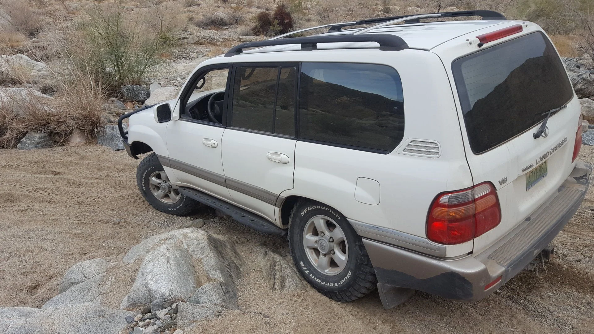

I haven't updated this thread in a while but my ocd is flaring up and I need to get this thread up to date with everything I've done to the truck. Took a quick trip out to Joshua tree at the beginning of December. Nothing difficult but some remote trails.

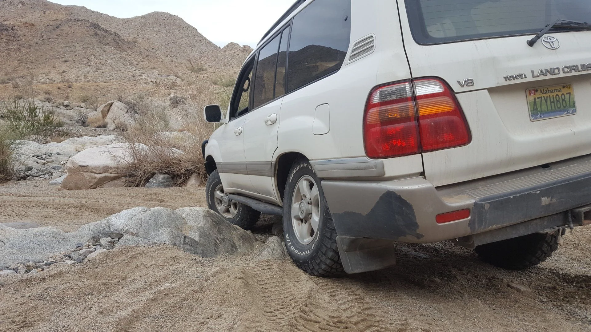

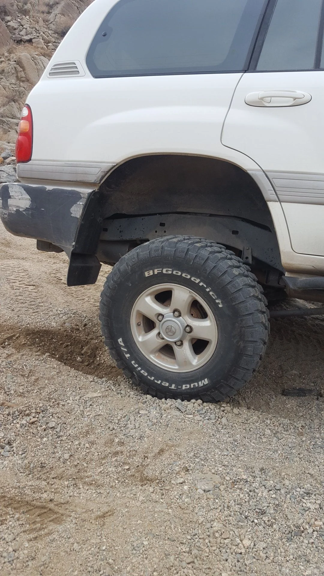

This part wasn't exactly technical but it was fun to flex out the suspension. Amazing how much the rear flexes on these things.

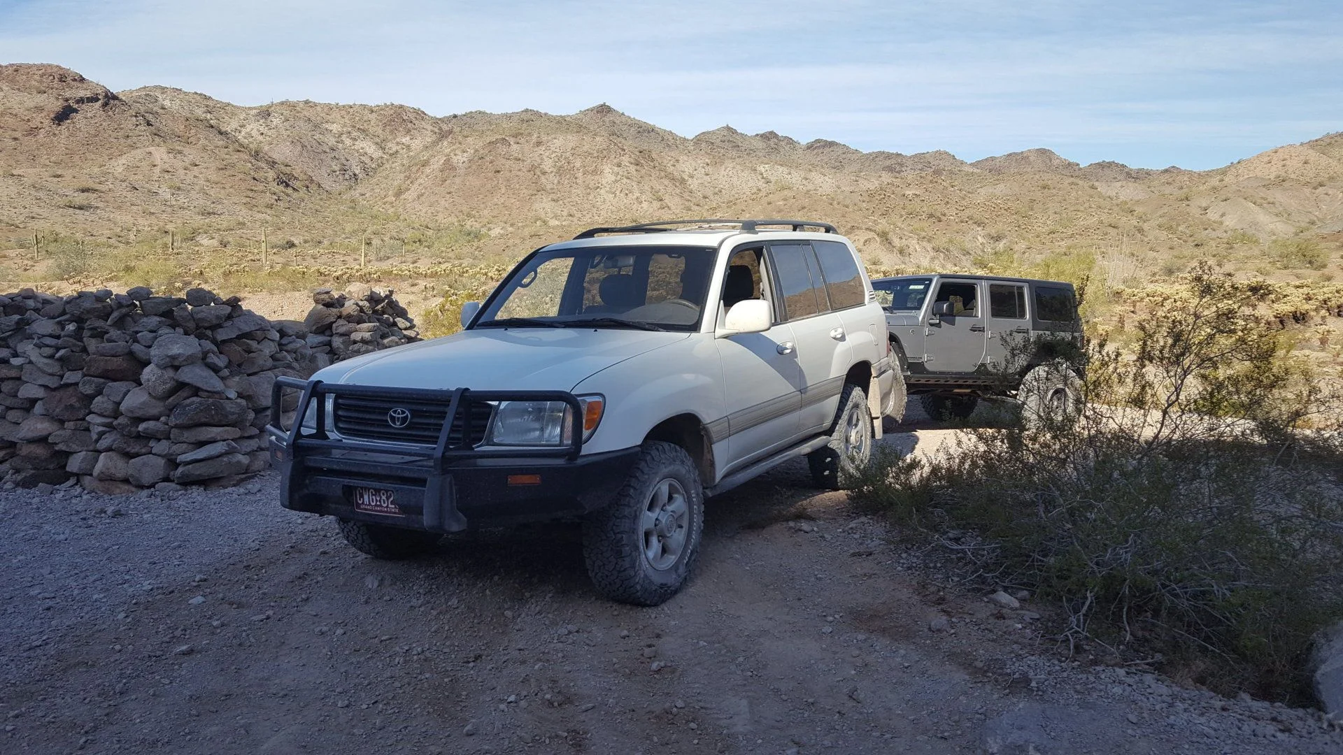

Another mid December camping trip with some friends in the north Kofa's. Two jk jeeps with 38s and 40s, an early bronco on 39s, two razors, and my stock cruiser lol. I was slow but they were all impressed with all the obstacles it went over. At one point it was three wheeling with the back wheel a couple foot of the ground.
