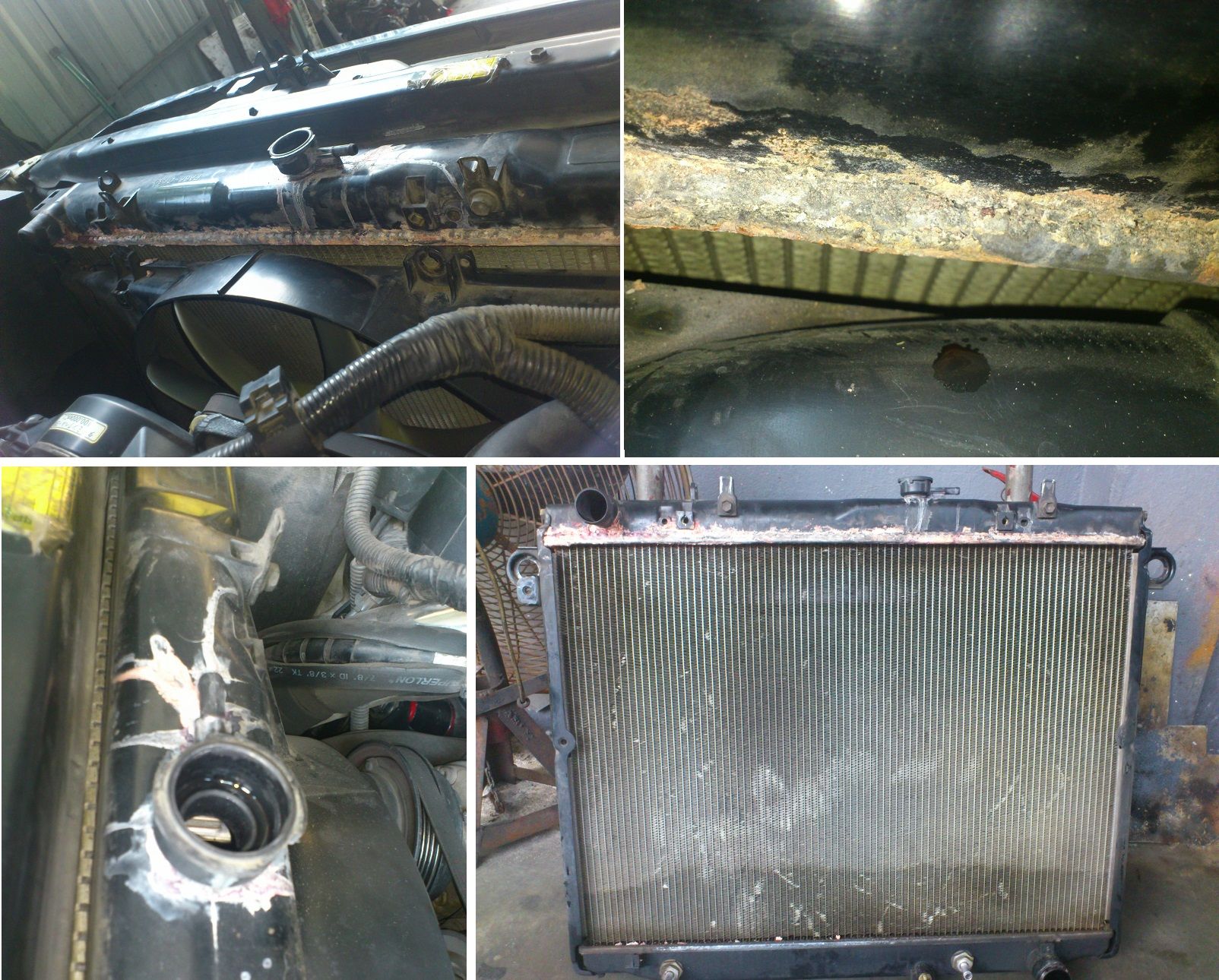

When driving faster that 110kph / 70mph, climbing hills, driving in reverse for a long time or offroading (sand, slow driving through vegetation, etc.) the LC100 with 4 speed and 1HD-FTE got hot. Turning up the heater solved this problem. I first suspected fan clutch, thermostat etc. The radiator looked clean from the front but my radiator was a bit dirty from the inside from driving through deep muddy water (bow wave over the hood). I haven't had it since I spend some time cleaning the radiator thoroughly (but do not damage the fins).
I would suggest to clean your radiator, make sure to get everything out of the fins.

Replace the radiator, if it is old about 6 years. Flush the cooling system without the thermostat, then install the radiator oem or denso. You probably have a clogged radiator. Hope to have a working fan clutch, oem or aisin.

Just curious your location. When I drove my 4runner/hilux surf in northern California over Sierra Nevada mountains with its 13 year old radiator, engine started to heat up. I saw that on the temp gauge so nothing bad happened. Replaced the fan clutch anf no luck. Radiator seems to be good but went ahead and replaced one with a denso. Problem solved. I found 31 out of 43 coolant drains were 100% clogged. I now replace radiators every 5 to 7 years.

Buy a brand new radiator core and soler it to the top and bottom tank which I think are copper. Dont use a used radiator from Japan or Dubai. You never know its conditon. If you plan to buy a compete radiator, make sure the top and bottom water inlet and outlet are not on the same side of the radiator.
