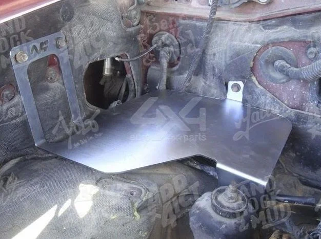

Hey guys. I searched a bit but came up empty. Does anyone know of a good product/idea for an engine bay accessory mount/tray?
I have a remote winch controller that I need to mount, and due to wires coming out both sides it limits my options.
I saw this online, which is the area that I am targeting. Has anyone else seen something similar/better for this area of the engine bay?

If you are going to put a dual battery set up in sometime in the future, then that's where the washer bottle typically gets moved to. Slee makes a nice bracket for that spot. Also, your cruise control actuator lives over there.

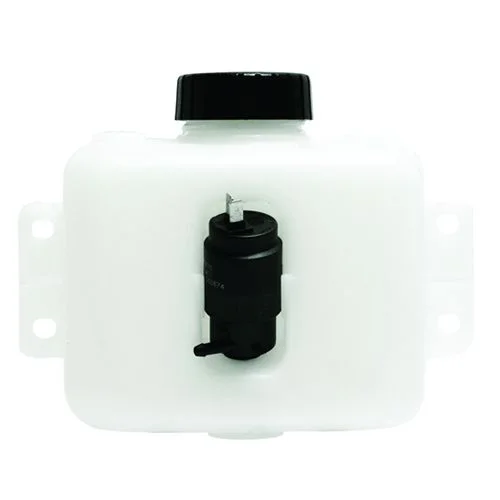

Yeah thanks. I might do a dual battery thus why I am not using that space up by the radiator. I would probably go with a real small washer bottle that I could stuff somewhere else or that might even sit on/around this tray. Dorman makes a bottle that I like that is what I will most likely use...

Totally possible but the bumper looks totally clean and sleek so I am favoring hiding it. I could possibly use the slee double compressor mount to put it up front by the second battery location but am thinking back by the cowl will have more space and also allow me to use up the 6’ of wiring.
Just wanted to see what interesting creations were out there before I fab a mount similar to the earlier post #3.
