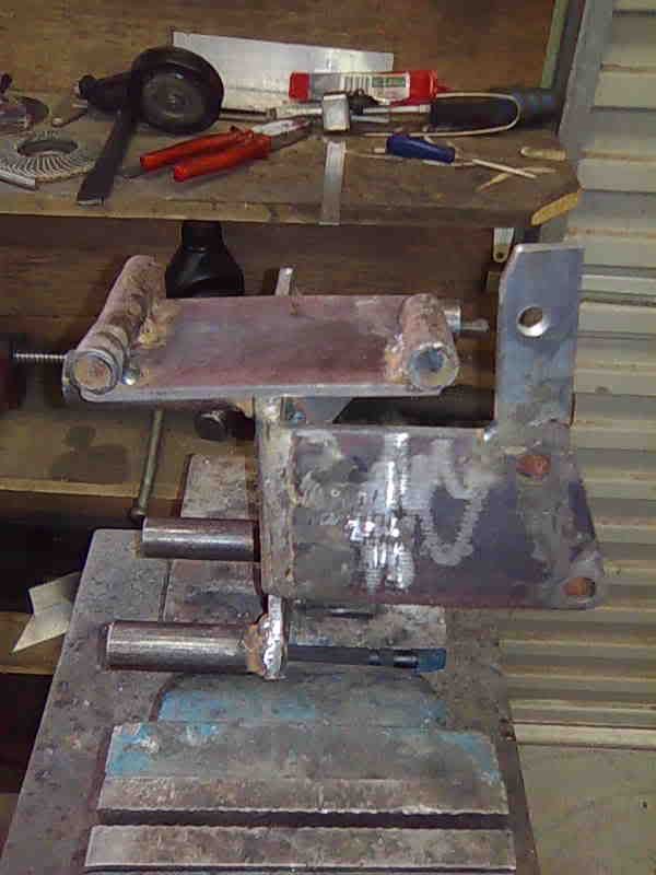

Any photos of the bracket??? I have my 1HD-T out of my truck right now, and a spare rotary A/C compressor sitting in the shop. Just trying to wrap my head around the strongest way to mount a proper bracket!

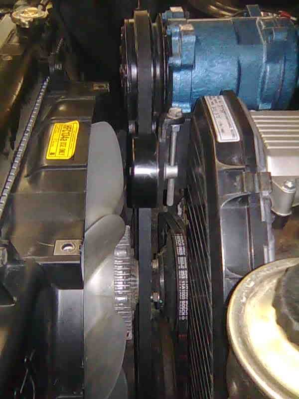

Semi finished bracket.

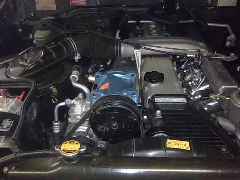

Air mounted
Air mounted again
The bracket mounts to the original A/C mounts and also bolts to the holes for the original belt tensioner. The A/c compressor is moved out towards the air box (I never undid the hoses so no need for regas etc) and the belt tensioner is now acting on the back of the fan belt with a larger diameter idler pulley to get enough tension on the belt to stop the belt from slipping when the A/C is running. It's quite sensitive to belt size and took a few attempts to get right, to be honest, but it's been on for a year or two now with no problems.

PPS. The bracket is sandwiched between the engine block and the A/C compressor using longer bolts in the original bolt holes for the A/C compressor.
The A/C compressor needs to be moved out so the air compressor can sit low enough to clear the bonnet. I had to cut a small hole in the bonnet sound pad for clearance. It's all very tight.
On the up side, it works a treat and walks all over my brother's fancy new ARB compressor. I can pump up twice the number of tires in the same time and run air tools, all at little more than idle speed.
