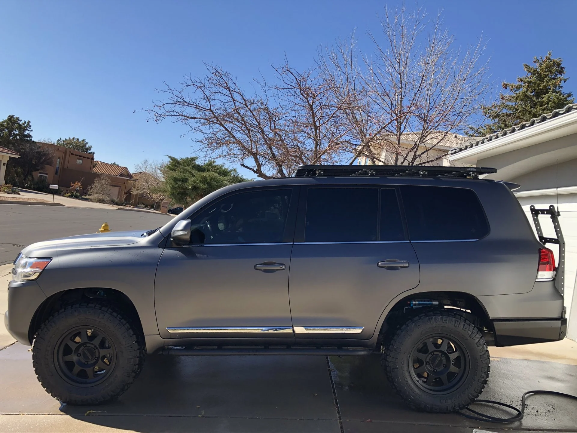

Current configuration with Toyo AT3 LT285/70r17.

I started with Method Racing MR701- 17 x 8.5, 0mm/4.75” and Toyo R/T LT285/70r17. I found this setup to be very harsh in daily driving conditions. Normal road imperfections seemed abnormally harsh. I ran tire pressures as low as 30psi, and softened up the compression dampers on the Kings. It still always come off as excessively jarring. The sensations manifested itself as a reverberation through the steering wheel, as if the tires and wheels were acting against the suspension. I ruled out shock settings, reservoir pressures, lug nut torque and tire pressures. The wild speculation I arrived at had to be the offset.
Around that time, Method Racing released the 18” version of the MR701 with 25mm offset. I paid my money, and took my chances. I wrapped them with Ridge Grapplers in LT295/70r18 as a gamble. Based on some extrapolation from the Wheels and Tires Database, I knew it was going to be close. I had rubbing on the KDSS at full lock to the right. I added ¼” plates to the front hubs, and it barely rubbed. The problem was, I started rubbing on the rocker cover on the passenger side where is wraps into the wheel well. Already assuming I have suspension gremlins I’m working though, I opted to go down to the LT285/70r18. I did not remove the ¼” spacers, and everything is perfect. My truck finally feels like the front is working in concert with the suspension, and not against it. I am very pleased with this set up.
5/28/21- Switched to the Rock Warriors and Toyo AT3. Handling feels better, ride quality is smoother.
3/27/23- Switched to BFG KO2 in LT285/75r17. This was largely precipitated by cracking starting to show on the Toyo AT3s between the shoulder lugs and middled of the contact patch.
12/5/23- More room. More meat. 35x12.5x17LT in BFG KO2. 34psi
Other issues:
Slee’s rear bumper and tire carrier is legit, but word of the wise, a 0mm offset LT285 setup will leave you with a long lever problem. The tire mount is adjustable, but it will not collapse all the way to allow tension on the tire. I realized this was an issue the first time I started to get up to speed on a concrete section of interstate. The tire oscillating up and down was pretty bad, and the rotational interia the tire was gaining was alarming.
My solution was to cut about an inch and a half off, and weld it. Permanent solution for what ultimately was a temporary problem. With the wheel and tire combo changes, I have been using hub spacers for “adjustability.”

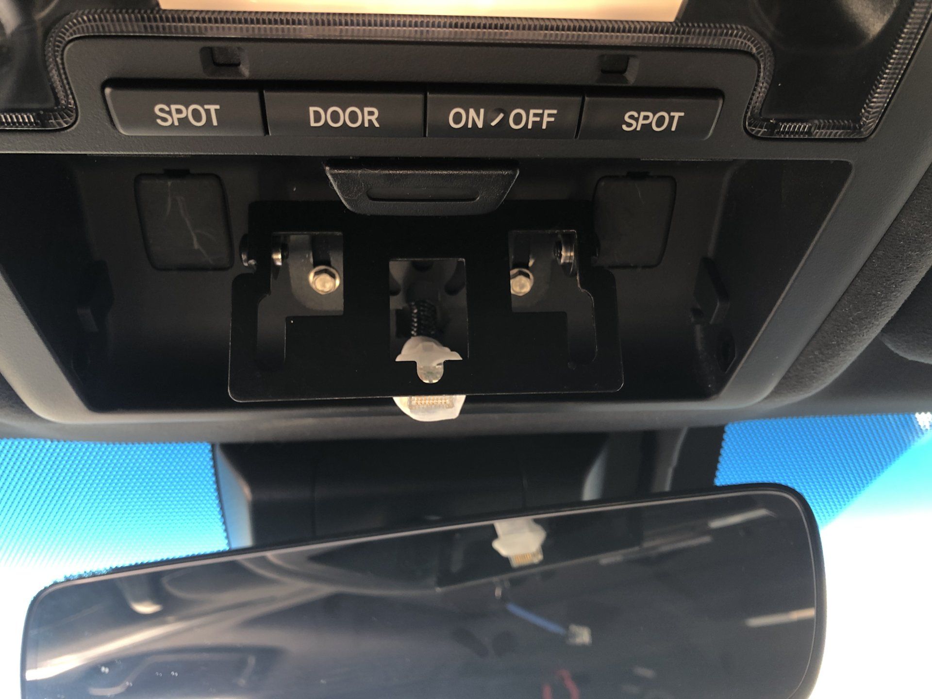

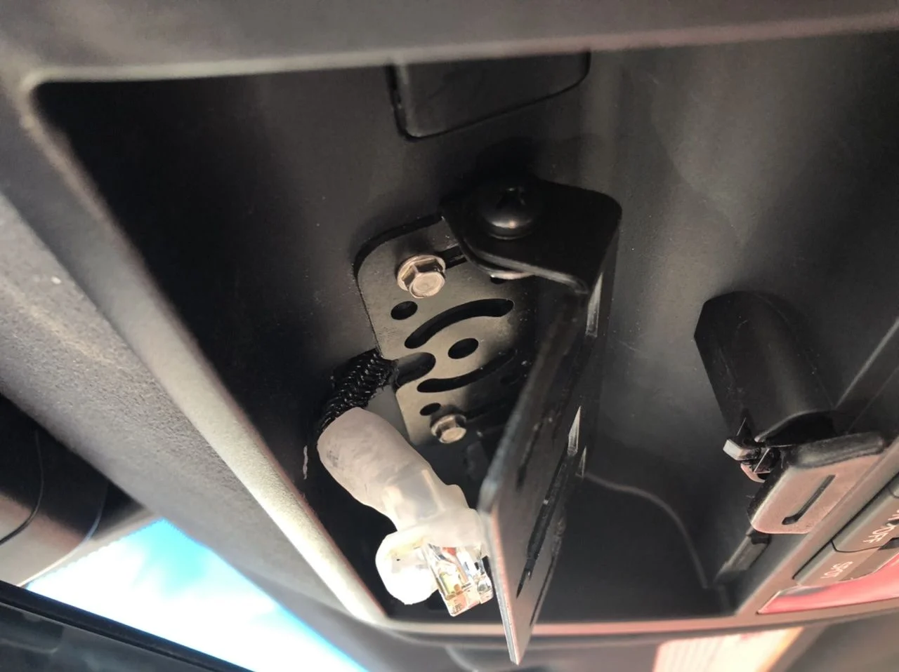

For the sPOD touch panel, I dropped the overhead console, and removed the sunglasses holder. The panel fits nicely in there, and doesn’t interfere with the rear-view mirror.

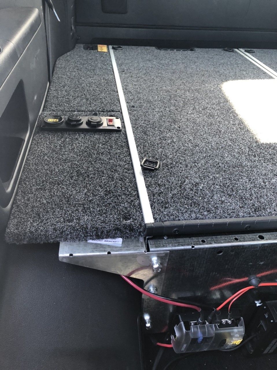

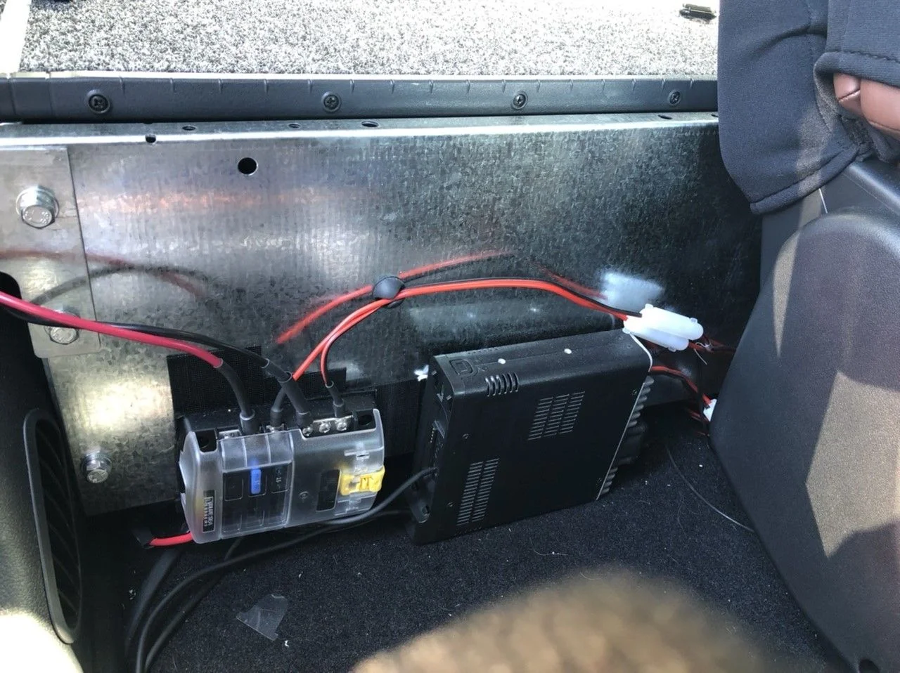

The Blue Seas System Fuse Block is hook and looped to my ARB drawers behind the 2nd row passenger seat, so I can have easy access to add/subtract as necessary. It is connected straight to battery power.
I have the accessory panel mounted on the surface of the ARB Passenger Side Fit Kit.
As for the Icom, the radio itself is hook and loop fastened next to the BSS fuse block. I have hook and looped the radio faceplate to the overhead console using the magnetic mounting plate. I do not keep the faceplate out when not in use, so I’m not terrible concerned about the lack of permanence with this solution.
The communications cabling for the mic and faceplate was routed in the passenger side door sill. The faceplate cable was ran up the B-pillar, and over the side curtain airbag so as not to interfere with deployment. Once you get over the airbag, the headliner opens up substantially. I routed the cable around the moon roof and under overhead c. The mic cable was run under dash, radio head, back under the center console next to the driver seat belt receiver. This was never meant to be a permanent solution, but it is 1) out of sight, 2) out of mind, and 3) it works.

I installed the Slee accessory tray on the passenger side, and I didn’t like how close it was to a major wiring harness. Having already been down the wire diagnostics path once before, I decided to remove it.

I’m surprised the 295/70/17 didn’t fit well. Did you mean size 18” wheel as mentioned under picture you provided? I have ko2 35/12.5/18 with a slight rub at full turn. I am considering on going to 295/70/18 at some point, would prefer a true 34” with a 11.8 width. You have to do a little metal cutting behind front tires near rockers.
That was a typo. I ran LT295/70r18 for a little over a month. One number makes a big difference! I’m sure with the KDSS relocation bracket, it would not have been an issue. Since I was still hunting for a suspension gremlin, I didn’t want to add another factor to the equation when switching set-ups.
That is was a typo. I ran LT295/70r18 for a little over a month. One number makes a big difference! I’m sure with the KDSS relocation bracket, it would not have been an issue. Since I was still hunting for a suspension gremlin, I didn’t want to add another factor to the equation when switching set-ups.

Brief update: It appears to be the sPOD. After a quick troubleshoot and a chat with tech support, it is not working the way is should be. It'll be shipped back to sPOD for evaluation. This is the second time I have called sPOD for support over the years, and they are a very responsive and supportive. Good customer service makes a huge difference!
Depicted below is how I’ve mounted my sPOD controller in the overhead console. It was a fairly straightforward process once I made my mind in on where to put it.
Here’s the rear electronics, as well as the head of the Icom 4100.
