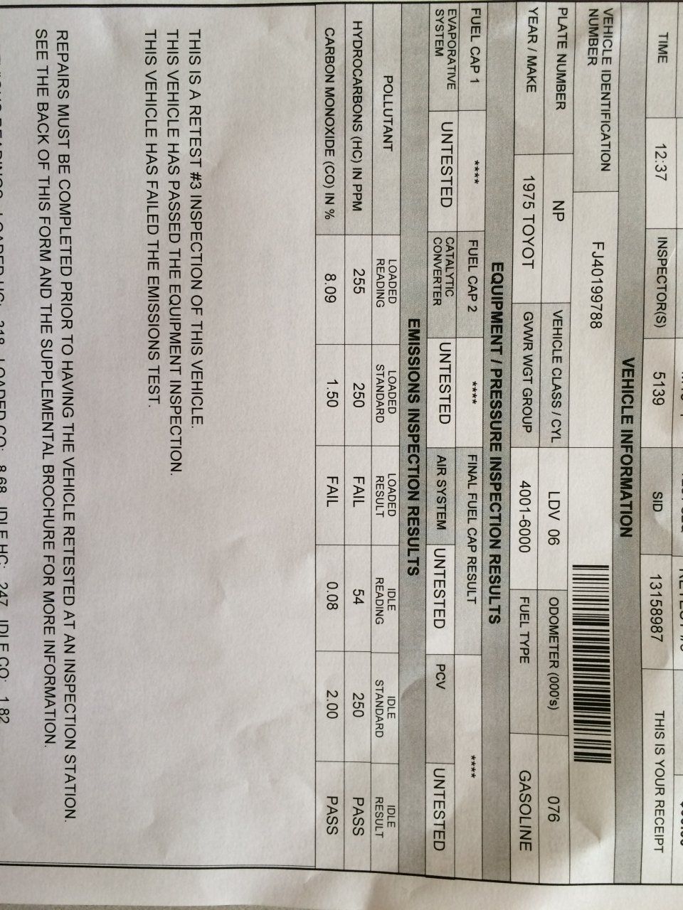

morning,
Failed first for elevated Hydro Carbons ( over 400 at idle and load) and CO ( 11-12% at idle and load).
Brought it home and times, adjusted valves, and idle, 2nd test similar results.
I knew it was running rich, so pulled the carb for rebuild. Found one throttle chamber badly rusted, such that the throttle valve would not close at all ( me thinks I found the problem). Cleaned up so it closes properly and set idle etc.
Last test results:
At Idle HC247 / pass CO 1.82 / pass
At load HC 318 / fail CO 8.68 / fail
I dont know if it is still too rich? Or am I not getting air to the air rail?

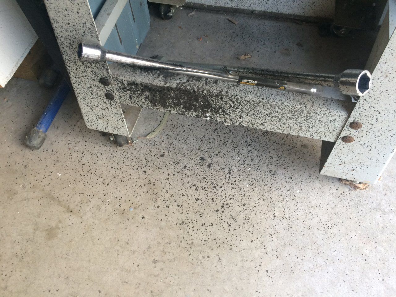

Here is some of the evidence of the rich condition. Exhaust splatter before I rebuild the carb.

View attachment 1178735 Here is some of the evidence of the rich condition. Exhaust splatter before I rebuild the carb.

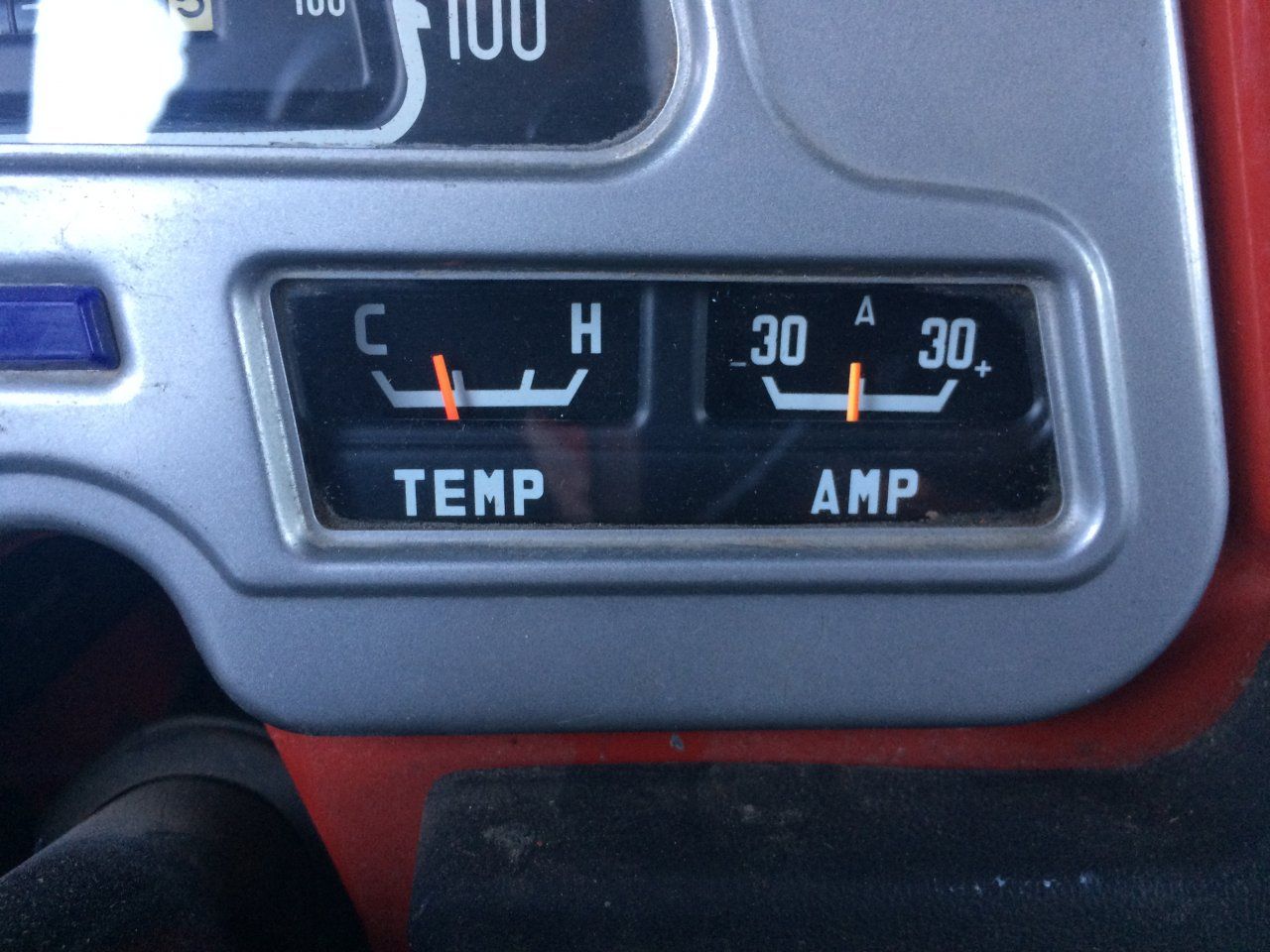

where does your temp gauge peg when you bring it into the station ?
I usually take 45 minutes, and that's in July/August
The gauge never goes above the left most market.
With my infer red meter oil pan peaks at 110f, the head never exceed 125f
The exhaust header reaches 450-500 by the cat its down to 250
Check your thermostat and maybe replace it with a hotter one. Also be sure the gasket on the top is in place. Over heating problems could be in many areas but usually not getting warm is in the thermostat. It's not cold enough here that you shouldn't be able to get it up to running temperature. I would also check the timing. I know when my timing was retarded to far my engine in the my 68 ran hot. To far advance if it's run cooler I don't know? Maybe I have this backwards as this was probably over thirty years ago I had the over heating and timing issue.
