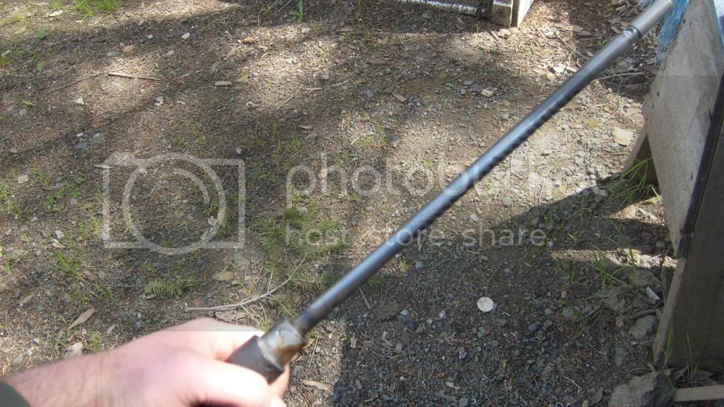

The shaft is identical to the current e-brake shaft in The Mule, it's the same diameter and length, and the increments are identical on either one as well. This is good, because I really don't feel like trying to work the slider assembly over to fit my older truck. This will be a simple 1-2 punch: disconnect cable, extract shaft, insert shaft, reconnect cable.

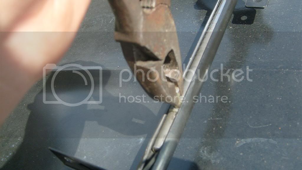

I first tried to remove the parking brake light-trigger tab with my lineman's pliers, but nothing came of it.

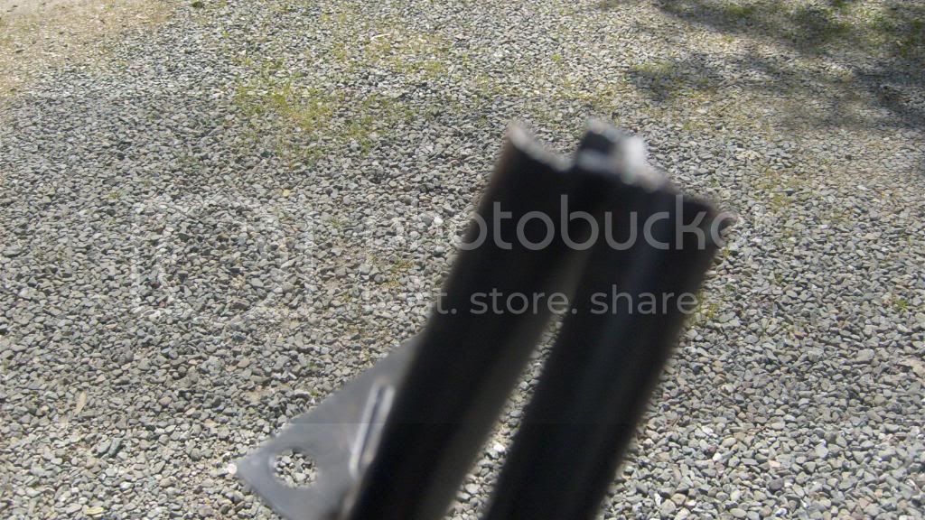

Deciding I needed a better angle to drive it out from behind, I cut the slide assembly in half with a hacksaw.
It turned out useless, as I still broke the tab, just like last time, so I drilled out the hole with the intent of finding a similar piece, or, as I did before, instering a machine screw in there.
The Machine screw worked for a last-minute fix, but the head makes it a little specific for the switch, and it's a bit hoak, so I'll see what my hardware store has to offer.
From there, I sprayed the shaft down with carb cleaner to free up the gunk, then hit it with steel-wool, and a polish coat of chainsaw chain oil on a shop rag.
here it is clean, and smoother than glass:

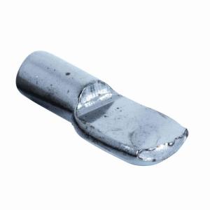

any chance you could use one of these for the switch?
It's just a common cabinet shelf support peg, available at most hardware or big box home improvement stores. If the round diameter is too small you could probably get away with roughing it up and using some JBWeld to glue it in place
