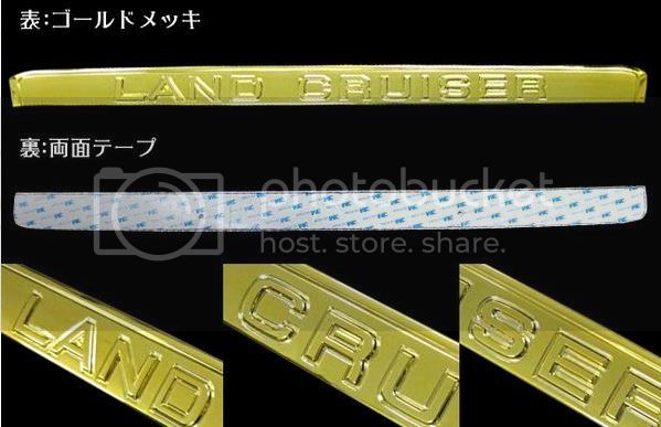

You could also just use the trim piece off of an early lx470 and go gold. Here is a pic for reference.
I really like it clean with nothing. You can use some 3m clear vinyl to protect the push point. Put The sombrero on and call it a day.
I do like the clean look.
Interesting idea on the LX470 piece. I bought a chrome one out of Dubai for $60, but have yet to see a gold one.
