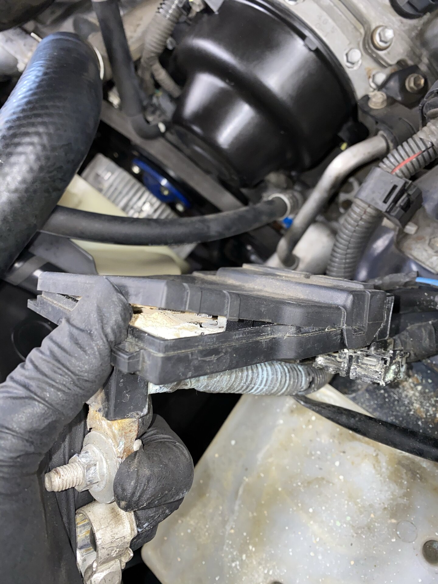

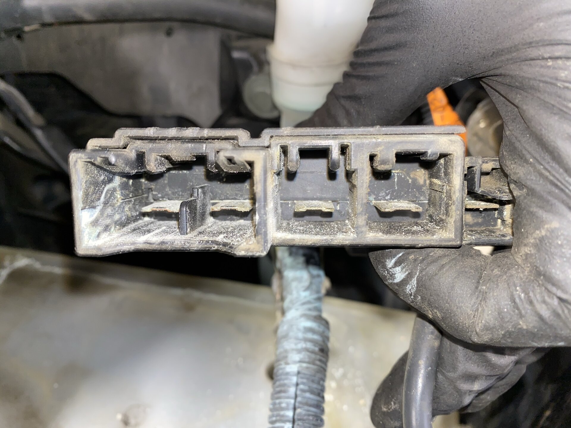

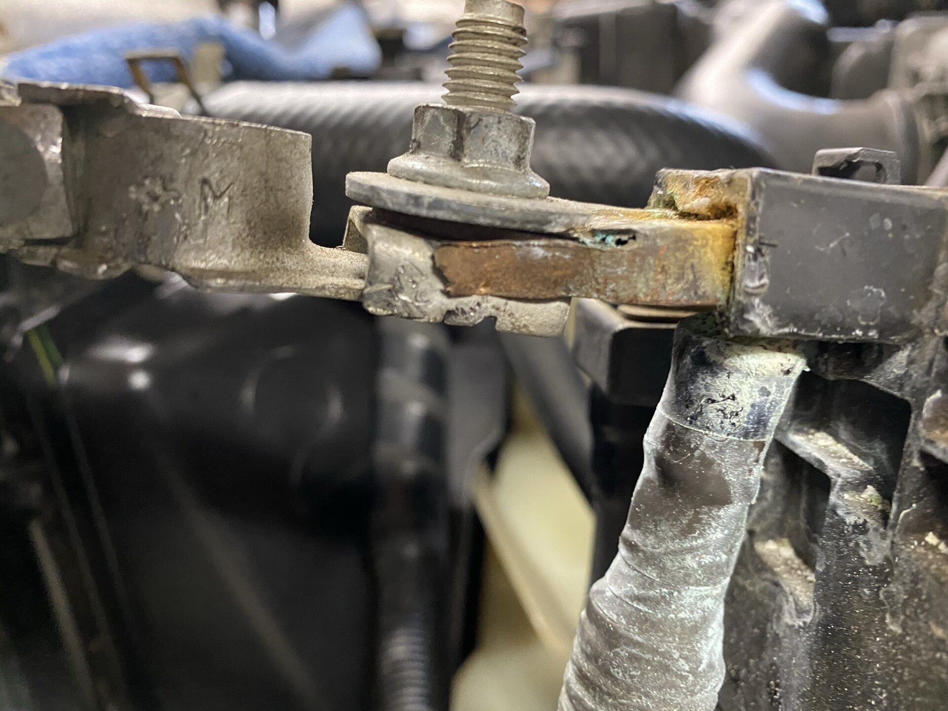

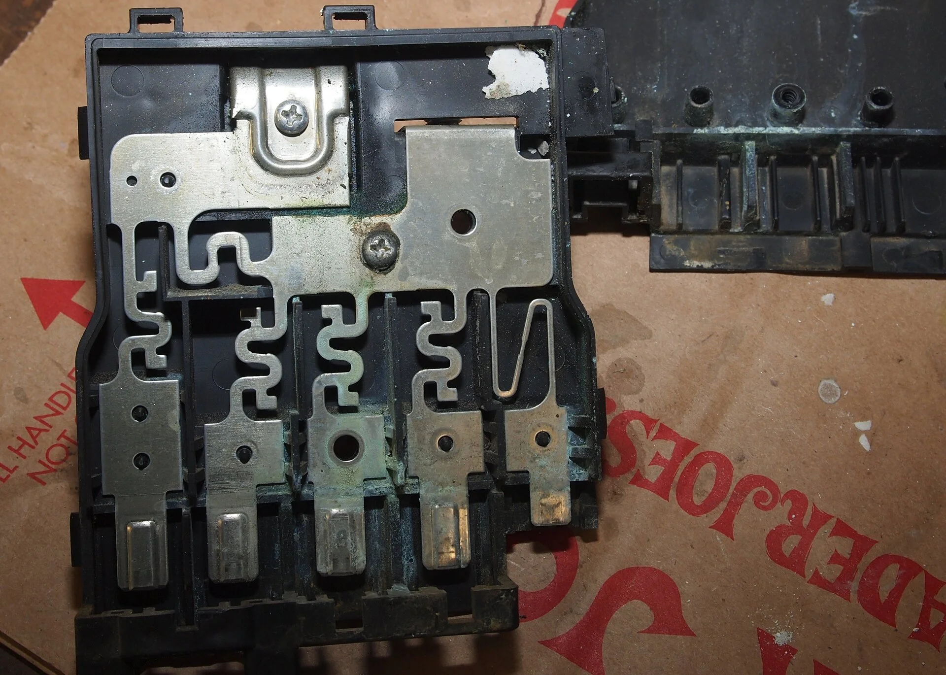

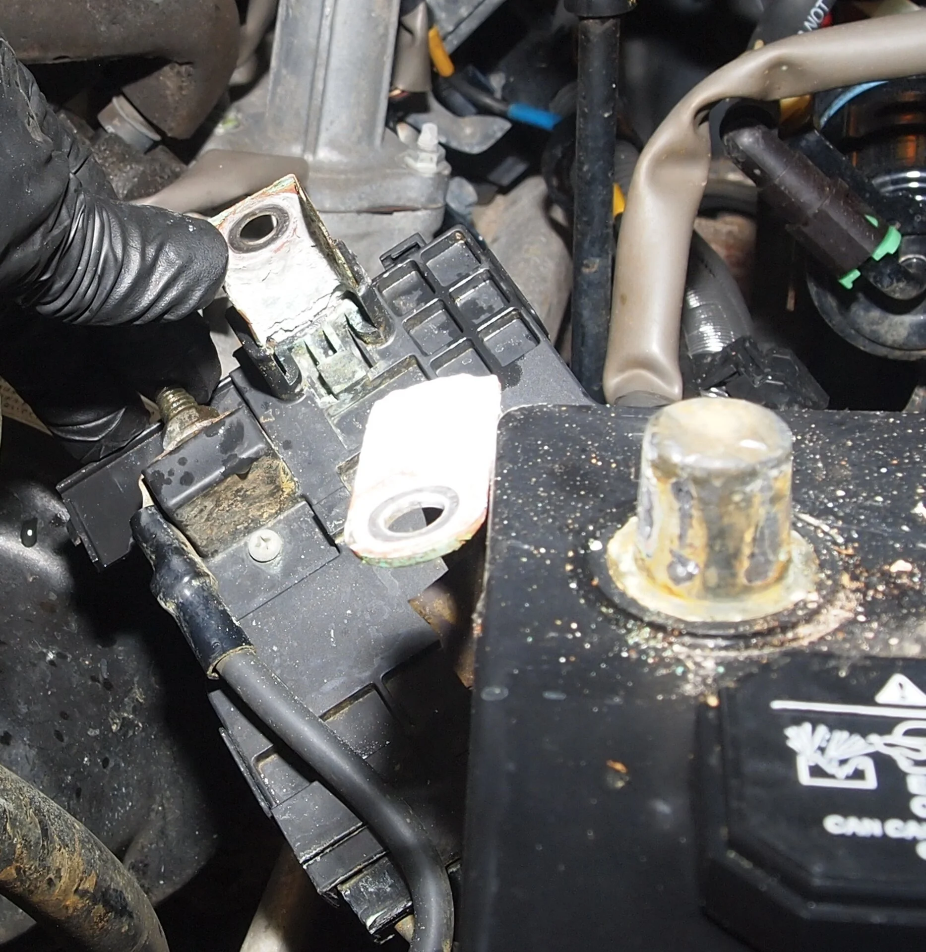

If you have to charge the battery to keep it running it is most likely the alternator . Especially if you didn’t replace w OEM. I just dealt w this in mine. I tried to save money and got an eBay alt. and It was bad right out of the box. I bit the bullet and got the Toyota reman at the dealer. I’d also inspect and clean the junction block connected to the positive battery post and make sure none of the fuses are blown. You can remove the little black covers and see if the connection there is rusty. That is an area known to cause high resistance.

Keep in mind. The voltage read directly on/from battery post, should be the same on clamps at all times or any point check from. If a voltage drop, clean post and clamps. Do not use that red CRC battery junk. It, like oxidation and some types of grease. Will inhibit the connects between clamp & post, which results in under charge.
Make sure the fuse block, that hangs on battery positive clamp, all good. Vary by year, this is 07.

You need a volt meter and test the alternator output at the battery. You should have about 12.2 volts at the battery before starting and if the alternator is working you should have 13.2-14.4 volts roughly if it’s charging. If not you need an alternator. I’d also check that you don’t have any loose connections at the battery. I’d also make sure your junction block there at the battery isn’t corroded like the post above that has the pics of it.
