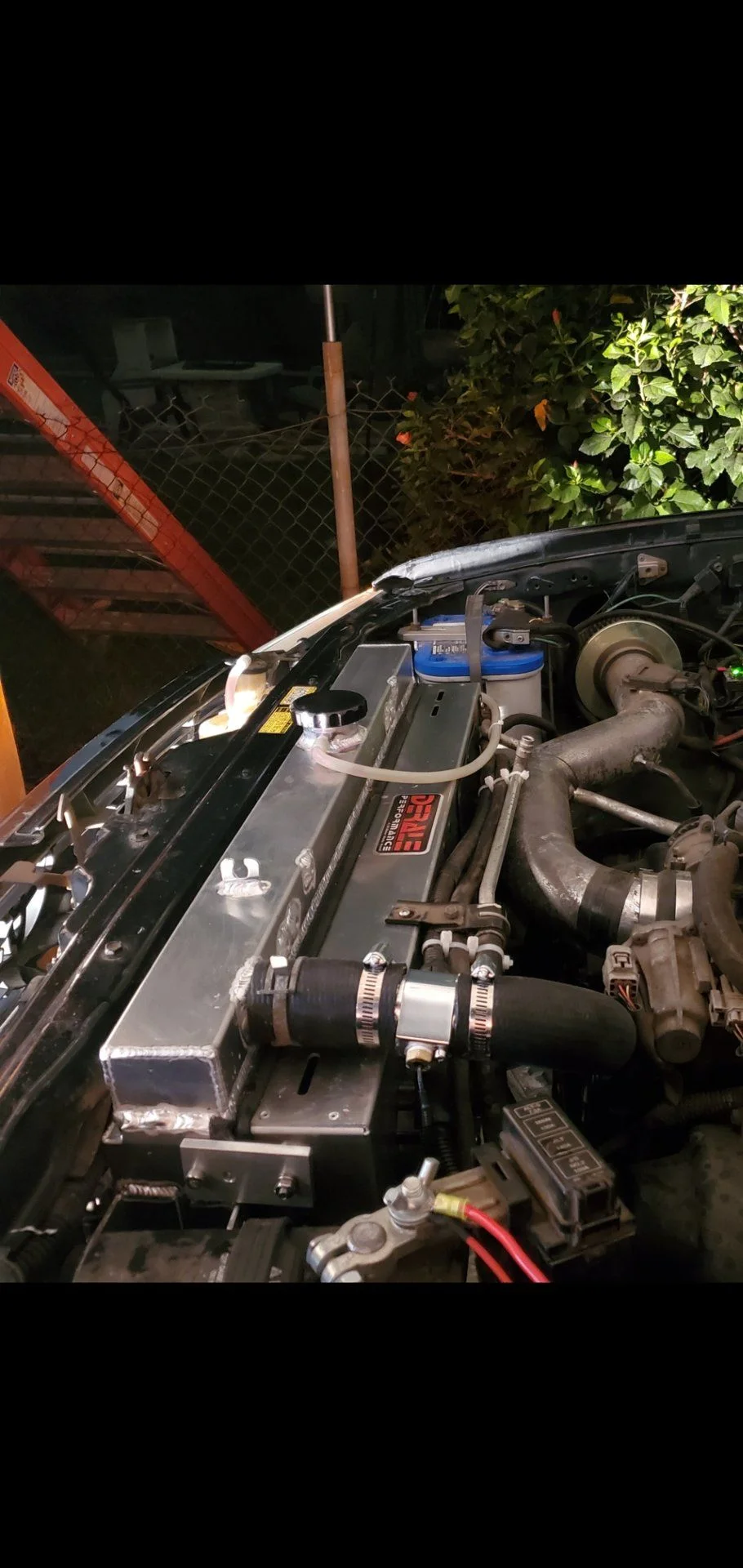

J1000, thanks for all the information. I just replaced my original radiator with an all aluminum Amazon one and did the electrical fan conversion. The radiator is a little thicker, longer, but not as wide. I used Derale part #16838, flex-a-lite controller 33055, flex-a-lite 1/4 NPT thermocouple, Amazon alum hose coupler with sensor hole, generic SPDT switch (Amazon :)).
