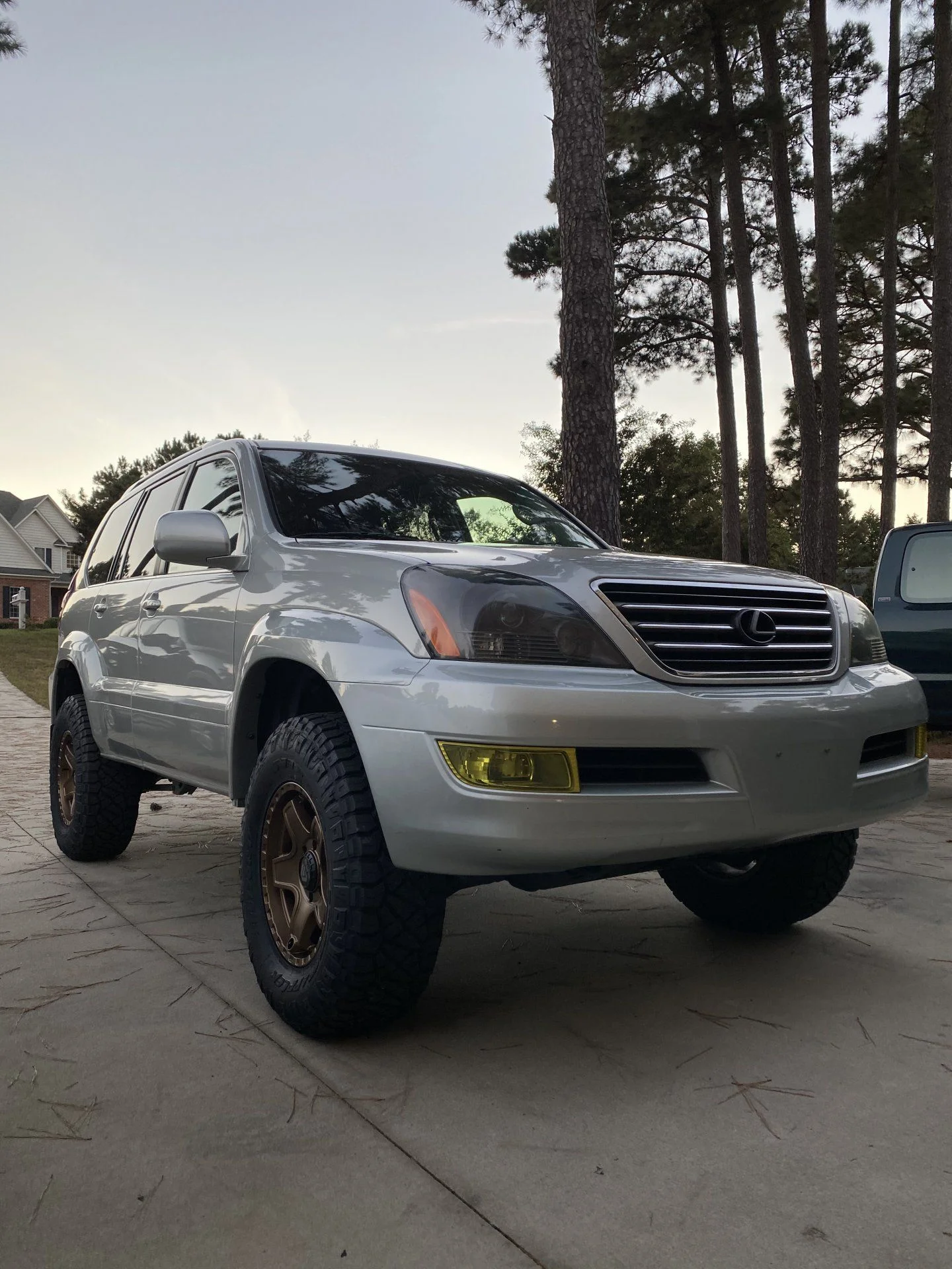

Thought I'd chime in with my experience here- I installed the kit on my 470 a month or two ago. This kit rides really well, on fire roads and bumpy mountain roads it feels just like the stock suspension which is amazing.

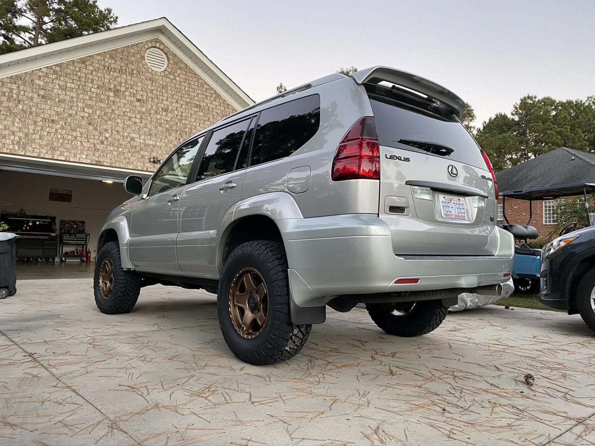

However, I measured before and after heights and only gained about 1-1.5" in the rear (noticeably lower than the "high" setting from the old airbag height control). It's installed on an otherwise stock vehicle, and heights were measured on level ground with half a tank and an empty vehicle. Poking around the GXOR page, it seems there's a few people who have also installed this lift and saw little to no difference in ride height. I'd love to hear your input on this Tanner, the rear springs are not quite what I expected.
Another thing to note is that the kit doesn't increase droop travel over the stock configuration. The limiting factor is still the sway bar end link. I plan to switch to a set of 2nd gen 4Runner end links to see if I can get to the end of the shock travel in droop. I did not measure how much longer the new shocks are compared to the stockers, but I'm curious to see if they offer more droop.
That photo looks like the rear is at least as high as the "high" setting with the AHC, no? Your tires look bigger too so the lift will look like less as that tire takes up more space.

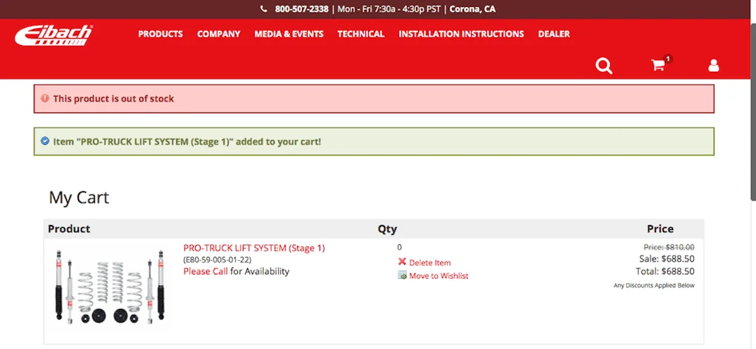

These kits are one sale currently for $688, which is pretty tempting. I would also need to purchase the rear air to coil conversion kit also, will the stage 1 without the cone shaped isolators work with this setup? Thanks
Yotamafia and Peak Suspension claim to still have it in stock as of last night.
The coil conversion are included with this kit.
Went ahead and got one as well, wasn’t planning on lifting so soon, only had the truck a few weeks now, but the price is hard to beat

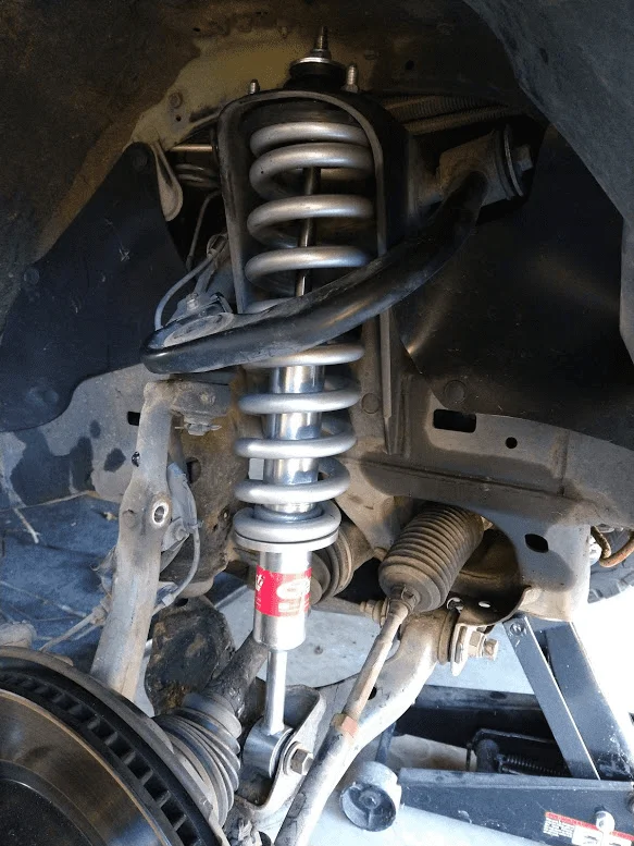

Installed this on my V8 4Runner this weekend, haven't done much driving on it yet but expect to be very happy with this over time:

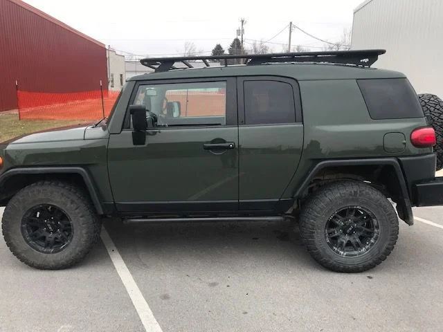

Nice! I have sag in front end of FJ I have heavy bumper and steel skids and heavy wench. I do not see on Eibach site where you can get different springs?

Do you have a heavy spring one for the sag I have on FJ??
