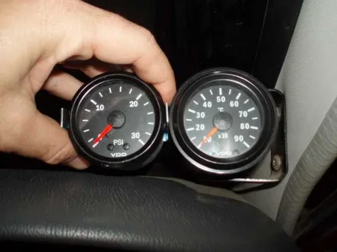

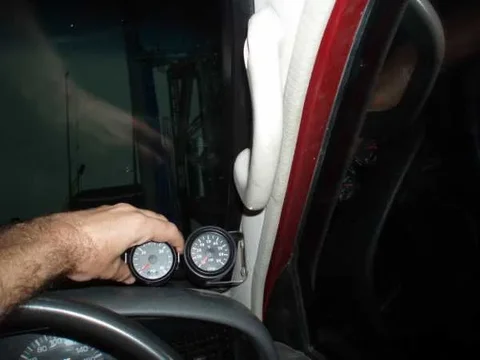

Here's some of mine.
1st close up of pyro and where I'll mount the boost gauge
2nd hand rail to mount GPS from above the turbo gauges

You guys really have me seriously considering installing these guages. Nick, you said your truck gets down to 375 "pretty fast". How long, roughly, would that be?
Don't know how hot 375*F is but mine comes back down to 150*C within maybe 30-40 secs. It will then drop down to 100*C in another 30-40 secs. If left idling longer it will drop down to nothing on the gauge. I usually leave the turbo timer set at 1min for normal driving around town and bump the time up higher for shut down after towing duties.
