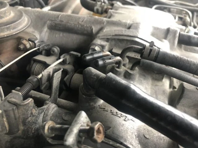

I have rerouted my vacuum hoses and installed the plug and the has been the extent of what I needed other have removed the EGR valve and blocked it. I can send you pics of my setup if you would like.
Let me know
I would be interested to see a set up of what I'm gonna be getting into. Thanks
Here they are. I did this to defeat P0401 code
The ports for these were blocked off I didn’t remove the temp sensor even though LC4life included the Allen plug. Let me know if you have questions I’ll answer as best I can
The ports for these were blocked off I didn’t remove the temp sensor even though LC4life included the Allen plug. Let me know if you have questions I’ll answer as best I canView attachment 2128056View attachment 2128057View attachment 2128058View attachment 2128059
Cracks like this cause leaks, that's no good. Id fix that. It looks like the wrong size cap.
