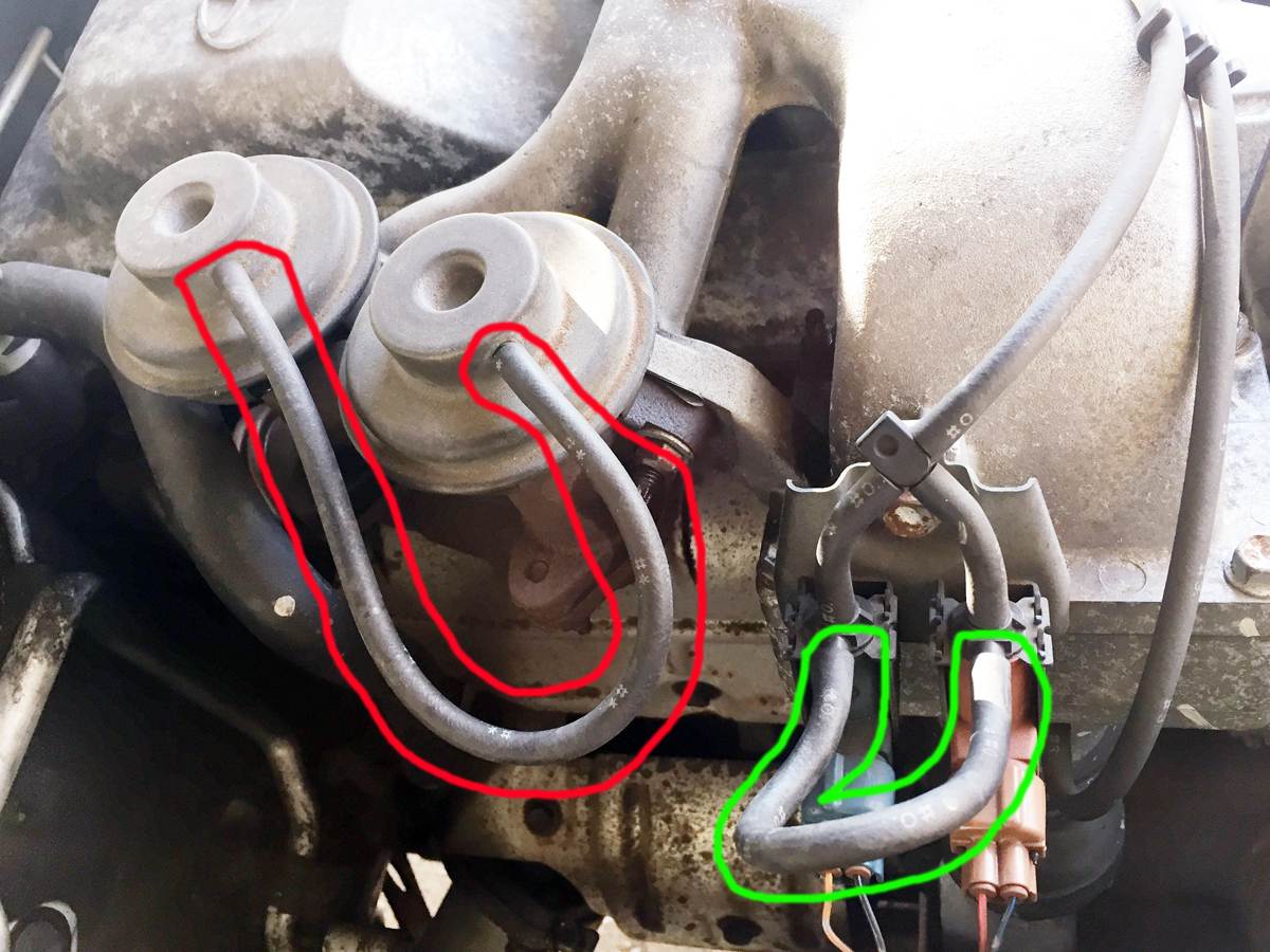

There are a few ways to do this. You can just re-arrange the vacuum hoses on the valves as in the photo below. Doing so will keep the EGR valves from opening when the VSV "tells" them to (because they won't be getting vacuum). The emissions computer will still "think" everything's OK, but nothing will actually be happening. That's assuming, of course, that your EGR valve(s) aren't stuck open (which may be the cause of your problem).

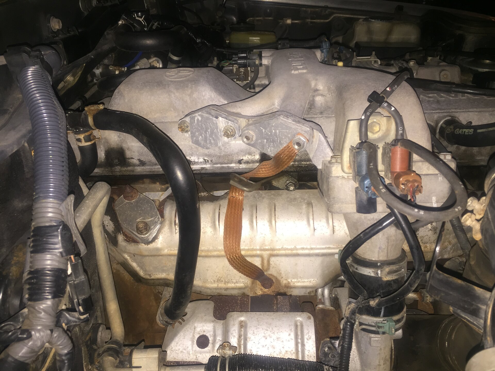

If your EGR valve(s) are stuck open, you can remove them and install plates such as in the photo below. You can fabricate them from aluminum or buy some from various online vendors. If you do this, you'll need to add a ground strap (as in the photo) for the pre-heater to operate normally.
Either of the above options shouldn't confuse the emissions computer, since all the wiring and VSV's will still be in place. If you want to remove the whole system, that's a little more involved. It's kind of like a cancer that's entangled with other, more useful cells.

Thanks a ton for this writeup! I followed this and it was a piece of cake on my truck. CAD'd up the blockoff plates and had them made. I made sure they were thick because my exhaust manifold studs are decently chewed up on the lower threads and the crossover pipe's studs aren't threaded for that long. Then I bolted them on, added the ground strap, and re-routed that one vaccum hose. This'll work for a nice long time; then I think maybe I will look at trying to de-entangle more of the system when I get around to cleaning the carbon deposits out of my intake manifold.

Switch over the vacuum hoses as @gilmorneau describes in his post; so no vaccum hoses are connected to the EGR valves.
Step 2: Remove the EGR valves by removing the two nuts on the exhaust manifold's studs; and the four nuts on the crossover pipe (green circles). Hopefully they aren't too rusted for you; highly recommend the PB Blaster spa treatment.

Step 3: Install the 3x blockoff plates on the exhaust manifold and crossover pipe with the gaskets.
Step 4: Remove one of the mounting bolts on the exhaust manifold heatshield (blue circle), and install the ground strap for the pre-heater between that heatshield bolt and an EGR mount stud on the crossover pipe.
