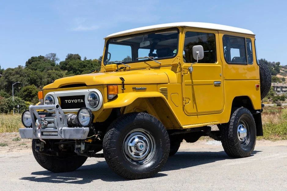

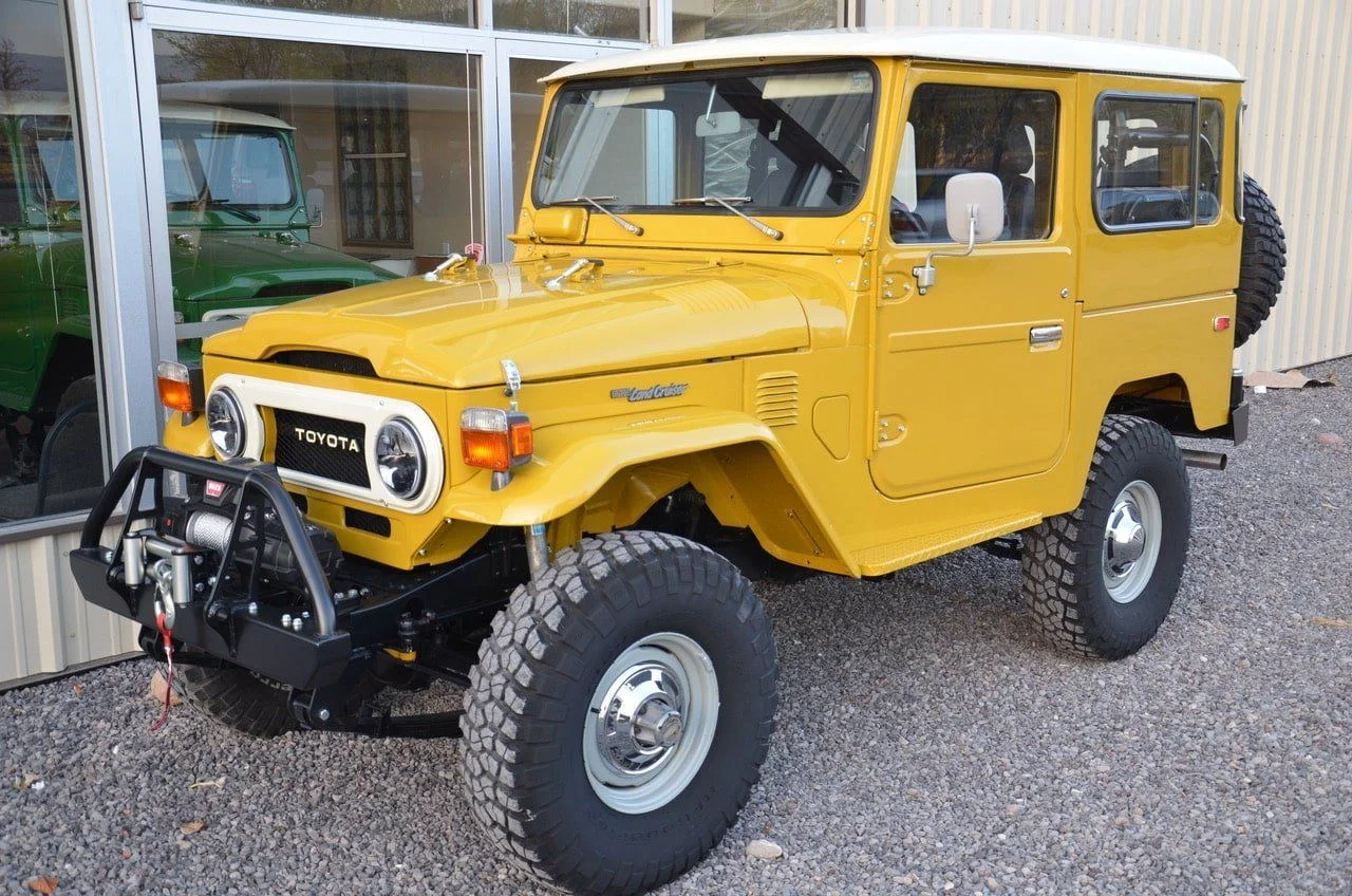

I'm not sure what you mean about not matching the original. They look pretty close to me if done well. One of these is a aqualu tub, one isn't. I guess if your doing a nut n bolt all original restoration it makes a difference. But if you just want a solid cruiser a aqualu works great.

I'm not sure what you mean about not matching the original. They look pretty close to me if done well. One of these is a aqualu tub, one isn't. I guess if your doing a nut n bolt all original restoration it makes a difference. But if you just want a solid cruiser a aqualu works great.View attachment 2170994View attachment 2170996
