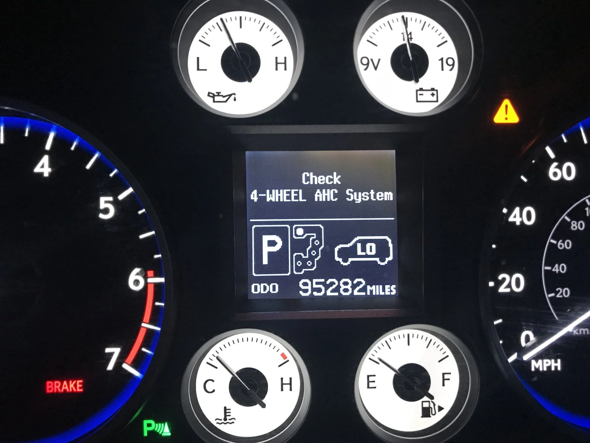

Yes, and no.
This is (my understanding) of what took place:
1. Brought in a fully functioning vehicle.
2. AHC fluid was exchanged. I don't know the details of how it was done this (first time), and suspect it was done improperly. They may have gotten contaminants into the tank/pump/lines/etc.
3. They determined my (original) AHC pump was producing some pressure, but not enough pressure to lift the LX. Again, I want to re-iterate that this worked 100% before I brought it in.
4. They installed a new AHC pump, to no avail.
5. They determined that the new AHC pump was defective.
6. They installed another new AHC pump, and everything started working.
So the final solution was installation of a new (working!) AHC pump. But it is not definitively known what happened in step #2 to cause my original AHC pump to fail.

I'm no pro, but I've learned way more about AHC than I ever planned to. I would bet $5 on this chain of events:
1) When they "flushed" the first time, they did it improperly and took out too much without starting the rig to let the ahc pump refill the accumulators. this set off a "low pressure" error. Either they cleared the error and called it a day, or you set off the error when you cycled those first few times.
2) The tech notes indicate the same error. "c1763". Here's a thread where someone cleared that error and the ECU eventually told the ahc pump to start. one could also go into techstream and perform a ACH pump check to force the pump to start.
3) Maybe they didn't know these tricks, and assumed the pump was bad. When they put the new pump in, the ecu still wouldn't fire up the pump until it was satisfied about that c1763 code.
4) Same goes when they put your original pump back in the second (or 3rd time)?
5) Maybe they finally figured out the issue and got one of the 3 pumps working.
here's what I would check:
1) Take a sample of your ahc fluid from driver front accumulator. If it's not rosey pink, wow. After all those pumps, there better not be a hint of black fluid. Try to get 6oz for a good sample.
2) Check all 5 bleeders to make sure the rubber caps on still there, if they are there, make sure they look like they have been removed.
3) Make sure the filter screen is in the reservoir tube. There's no massive "debris" in the system that could ever break lose and kill a pump, but that screen is there to filter the fluid when you lower and it makes it's way back to the reservoir.
Here's a link on how you can use techstream to add height to your low corner, or you can physically move the sensor. If you decide to move the sensor, you can go "trial and error" or you can do it while the rig is on (doors closed) and have someone hold a tape measure while you slowly move the bracket.
About your rears being 1" apart, if you move the brackets, I've noticed that both sides may move so check them both after you adjust.
Also, why in the world did they disconnect your rear seatbelt??
Let me know if you need any help or have any questions.
