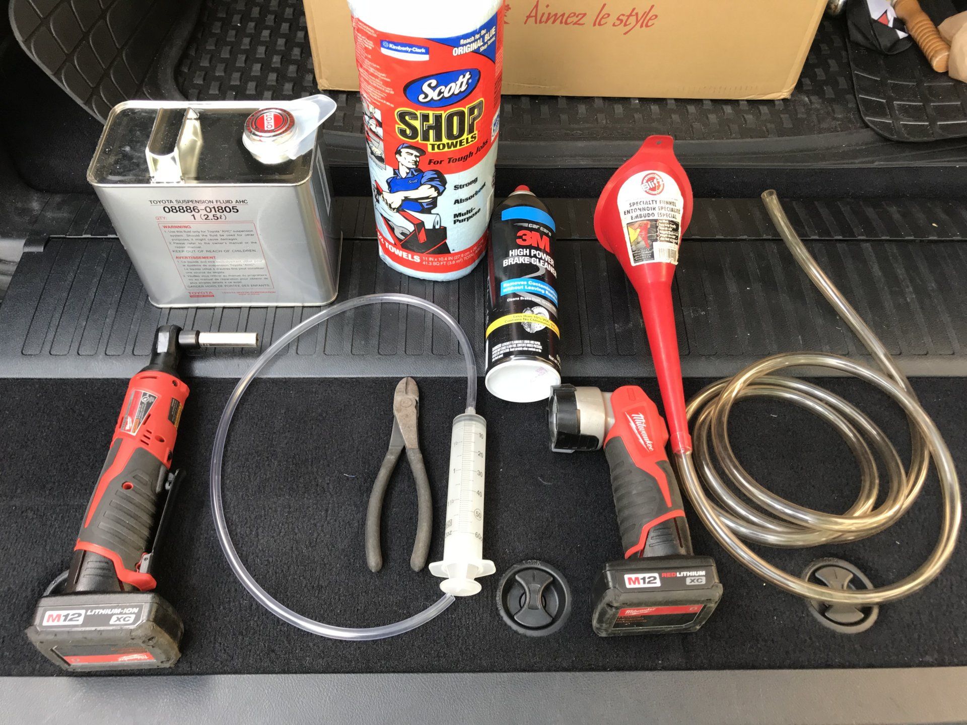

So my LX is currently stucked in Low position. It is actually working in great condition, so I started out by bleeding the system. Follow the bleeding procedure with vehicle set in N position. Then sucked out all the old fluid from the reservoir, refill with new fluid. Bleed the front left accumulator, then front right, rear left and finally rear right accumulator. Start the truck and it is doing nothing, flip the switch to L, to N still nothing, just blinking as if it is in the process of lifting. Pump is not running like it does normally. Shut off vehicle, restart again, get this message in the speedo center "Check 4-Wheel AHC System" with the indicator in Lo.

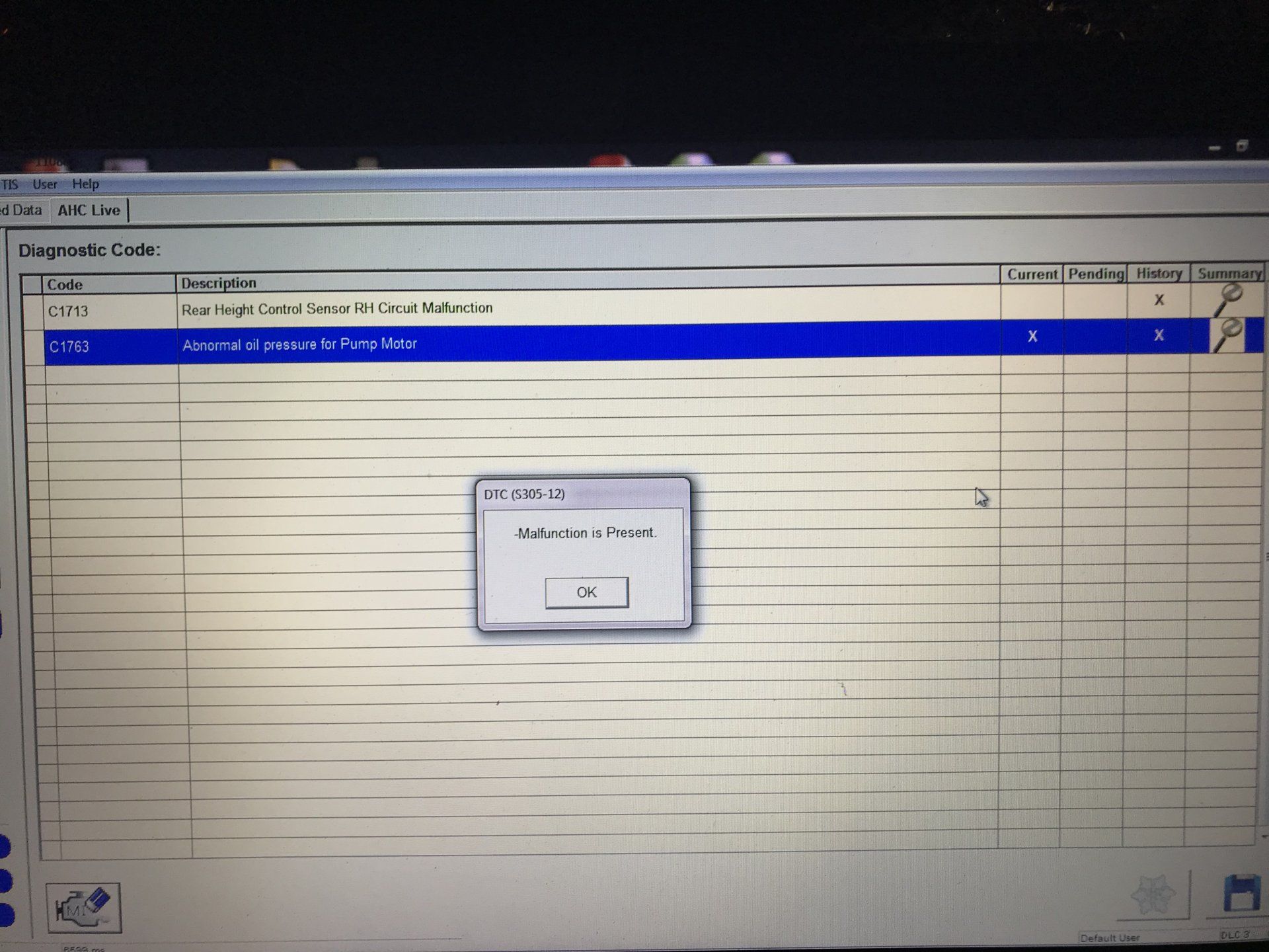

Do you have Techstream or access to a manual?
Yup just hook up with techstream.
I had the C1763 code when I bled the system and removed a little too much fluid from one corner. Use the active test part of Techstream to raise the vehicle back up to the neutral position and that fixed it for me. Looks like you also have a bad height sensor though.
Thanks for the info, will try that. Finger cross ;). It probably a bad height sensor in the pass before I bought it. Currently it is good, that was the stored history data in the system.
So it turns out to be an easy fix. Hooked up Techstream again last evening after work. Navigate to AHC screen and simply clear the code. And I can hear the pump working right away. Thanks to PADDO suggestion, it is all good now. After 2.5 Liter AHC fluid replacement, ride smoother. Used fluid is way overdue!

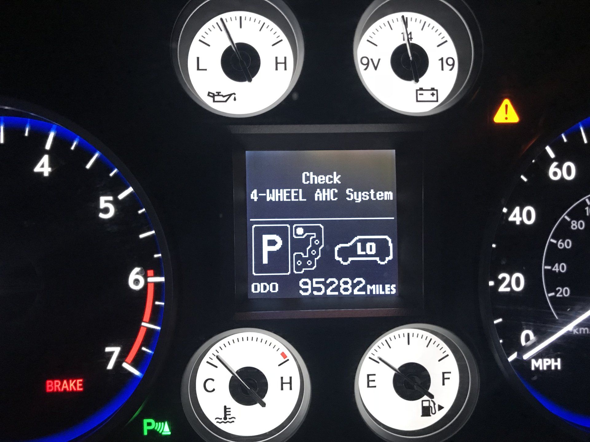

The engine won't turn over and I'm getting the "Check 4-Wheel AHC System" with the indicator in Lo (2013 LX 570). I was looking forward to writing my first post on ih8mud with photos for removing the 3rd row seats. As soon as I did though is when a series of weird issues started immediately. Just ordered the TechStream cable, fingers crossed.

Upon connecting battery back up and trying to start then I noticed the MIL "Check 4 wheel AHC system". It was parked in Lo using Park Assist. Multiple times testing disconnecting battery to reset and removing AHC fuse but won't turn over. Battery is ok with power seats, lights, and rear power door all operating fully.
