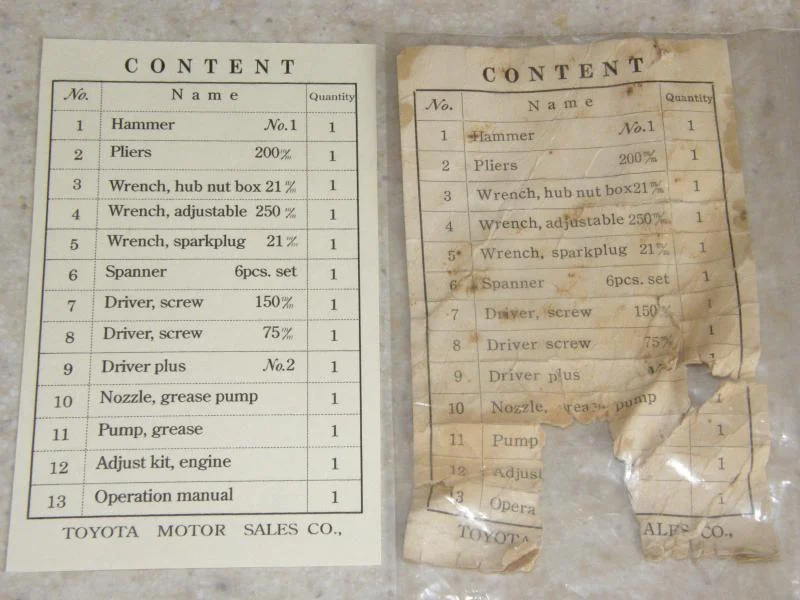

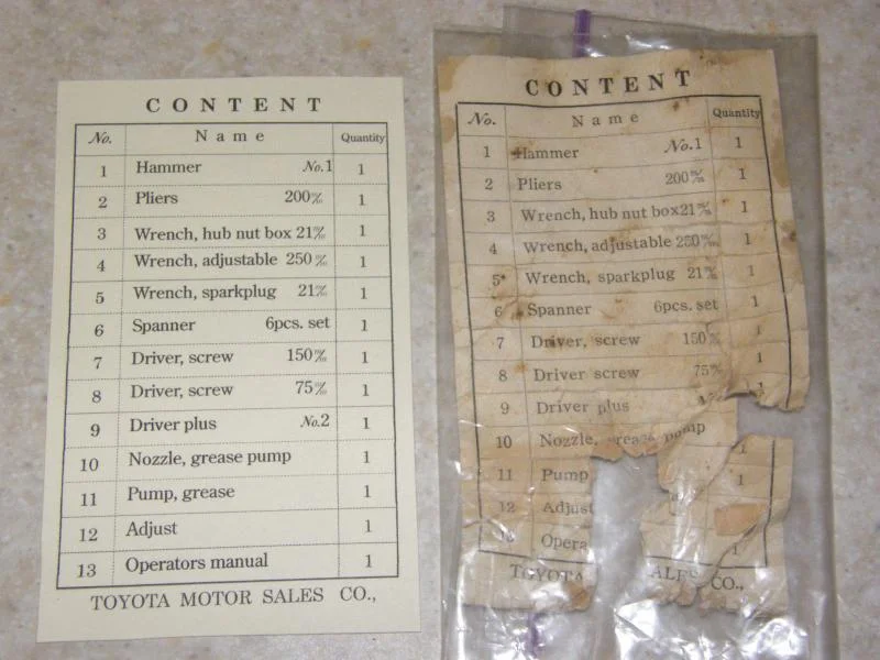

OK so i just got the tool roll and now waiting for materials to start reproduction. While waiting im replicating the parts list. the original parts list i got with the roll was rubbed through at the bottom thee items on the list. does anyone here know what the last three items on this list are?

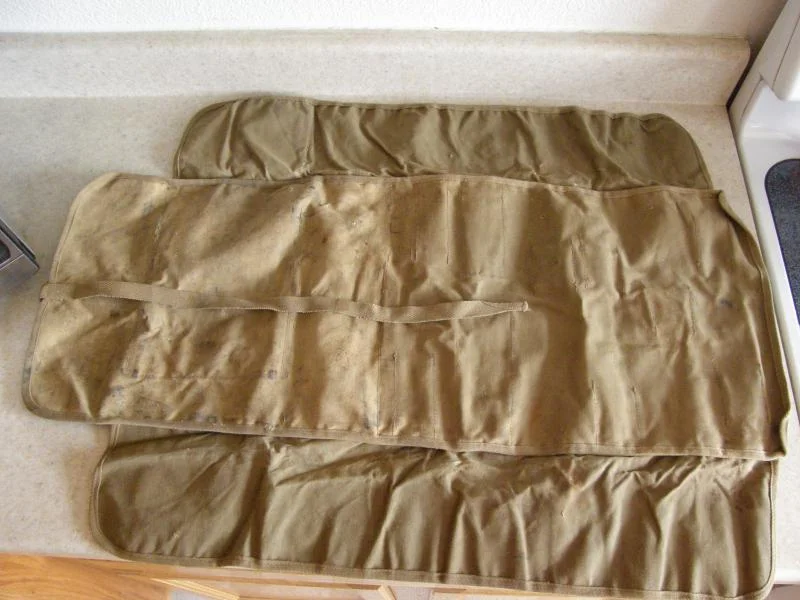

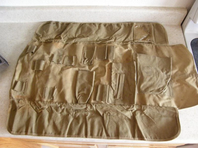

here are pics of the roll and the list im working on. List still needs a little fine tuning...
Also were these rolls two tone? this one looks to be khaki with light green pockets and flaps. anyone know exact material for this one?

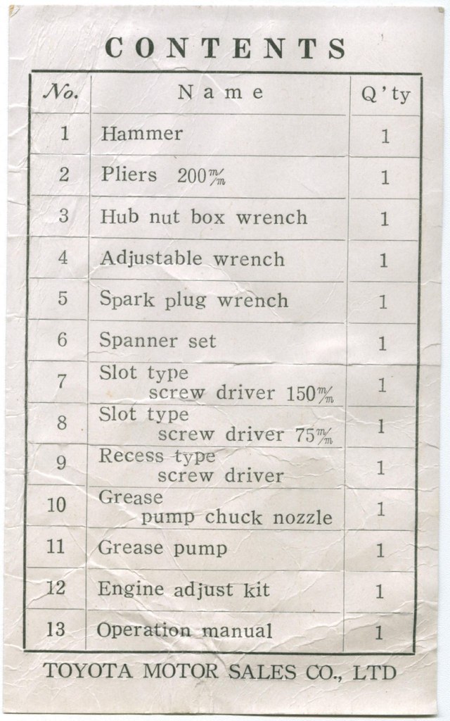

From my 1968 toolkit - #10, Nozzle, grease pump. #11, Pump, grease. #12, Adjust kit, engine. #13, operation manual. Nice product, let me know when you have got the content list down - I'll be in the market for one.
Carry on!

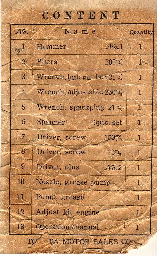

Just for reference, this is the earlier card with 23 mm hub nut wrench and some other differences.
I believe they were one color and material, however they've all aged differently. Not 100% on that though. :hhmm:
