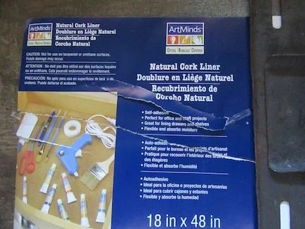

I bought some self-adhesive cork liner to replace the cork padding for the mirror.
