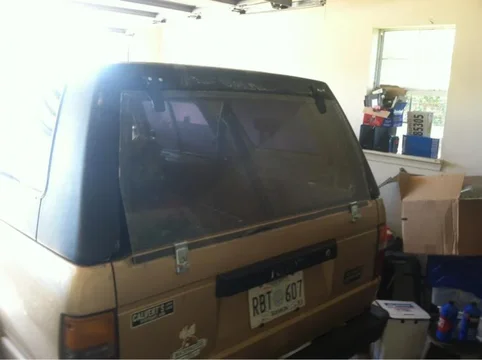

New project in the works.
Phase one complete
Now to apply tinting , tighten the weather seals and install lift struts.
Home brewed lift gate. I pulled the old glass from the tailgate. I plan to trim the new (plexiglass) so it fits snug in the inset of the removable top.
use you plexiglass as a test fit then make one out of lexan .
plex won`t stand up to the weather or the stress of operation.
been there don that on my trailblazer .
thanks. I was never planning to make the plexglass permanent. Just needed something to experiment with. What is a good source for Lexan?

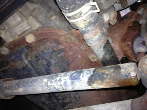

I got a little me time today and removed skid plate to do some rust removal ipor15 treatment on 4runner and discovered more rust. Looks like oil pan and an engine mount are pretty far along in rusting. What say cotton lands experts on what needs to be done?
You obviously need a few oil leaks to keep the rust at bay...
