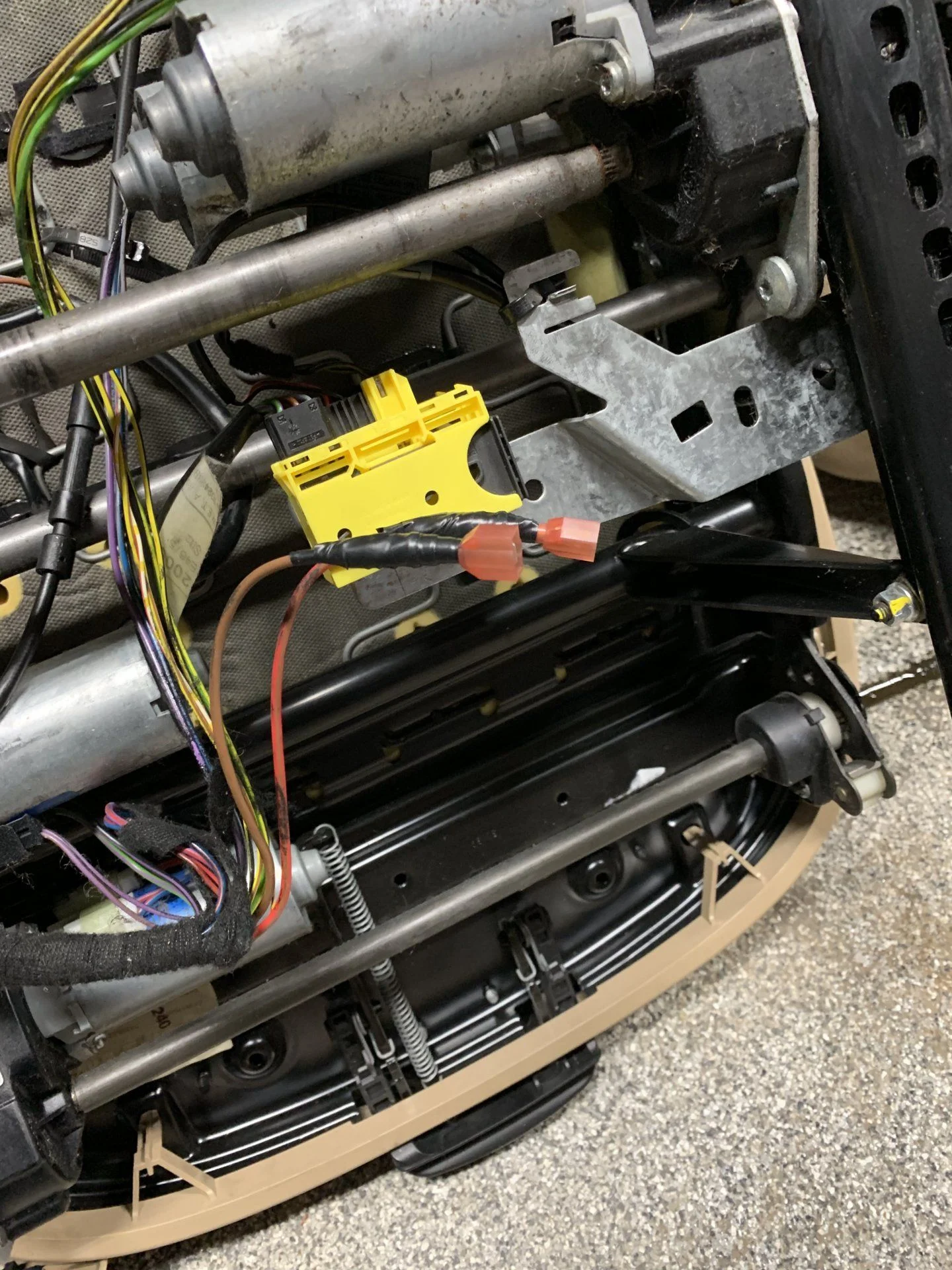

I am embarking on one of my first seat swaps. Grabbed some E46 coupe (I know they are harder) BMW 3 series seats for $100 locally.
Now I’m staring at the bottom of the seat wondering where the hell this red (12v power) wire and brown (grounding) wire are that everyone talks about. This seat is powered, and includes the Lumbar support adjustment.

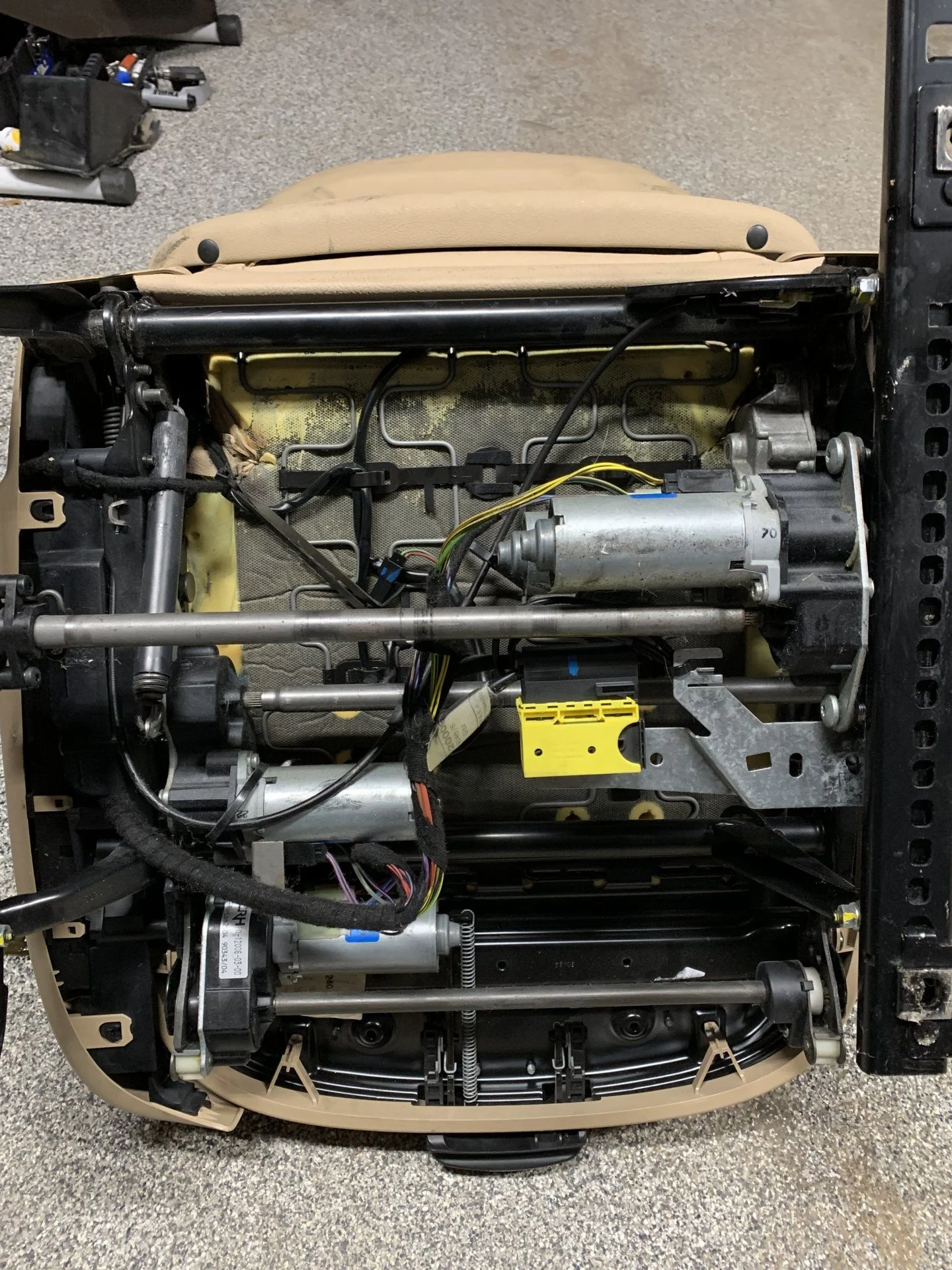

Pic of bottom of driver’s seat. I wanted the coupe seats so I could fold out a bed forward over the rear seats to make it super long (I’m 6’ 2”).
Thanks
Alright so after some googling I figured out the red & brown is power (12v) and brown is ground.
I’ve connected a male disconnect to each in prep to make the final connection this weekend to the wire I’ve run to the cabin from the battery. I’ll report back on my findings.

I went down this road two months ago. The E46 seat may be a little easier than the E90. If that is the driver seat in your photo, I don't see the same electronics...which account for the power out timer you've heard about. That's less headache for you as it looks like you won't have that.
The breakout of the various cables is a handful and not always intuitive. To make matters worse, some of it changed after March 2007. Knowing what year your seat was new could be helpful. One thing that surprised me is that the red cable is power for all functions, BUT...there are two brown ground cables. One is for the lumbar only, while the other is for all the other seat functions. Do you know your manufacture date?

Mine is 2003, I do not have the same timeout power cable (as far as I can tell).
The only other cable I found on my Driver side was a white, green and yellow wire - which I believe to be the memory functions.

Does yours have airbags? If so, isolate those wires first and terminate them so you can't detonate those by accident!
I think for pre-March 2007, the primary wire color differences were for lumbar, but don't hold me to that until I can dig up my info again. Memory on the E90 works with just the red seat power connected; no other wires necessary. Frankly, there are wires for which I didn't find functions. Since you don't have the disconnect pigtail, it's a bit more difficult for you to work on this.
EDIT: The airbag wires on mine are blue and brown. They come off pins 18 and 19.
For yours, the only difference I see are for the lumbar. Pre-March 2007 uses pin 9 for lumbar positive with a red/purple wire.
I have no need for heated seats connections, so I can't help you there.

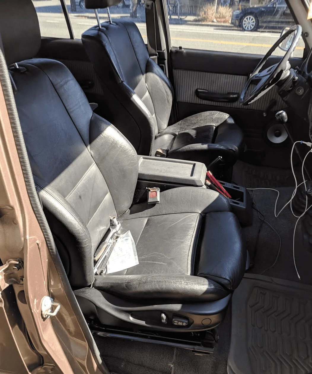

Alrighty! Grabbed a BMW battery for next to nothing on CL today during lunch. Created a test bench out of the battery, jumper cables, and alligator clips. Connected it to the male disconnects - and we have power seats!
Struggling to upload a video ... but it works!

Buy the brackets from TorFab - makes it incredibly easy. Highly recommend this mod. inexpensive until the reupholster.
Looking good! Feeling good?
Yes absolutely love them.

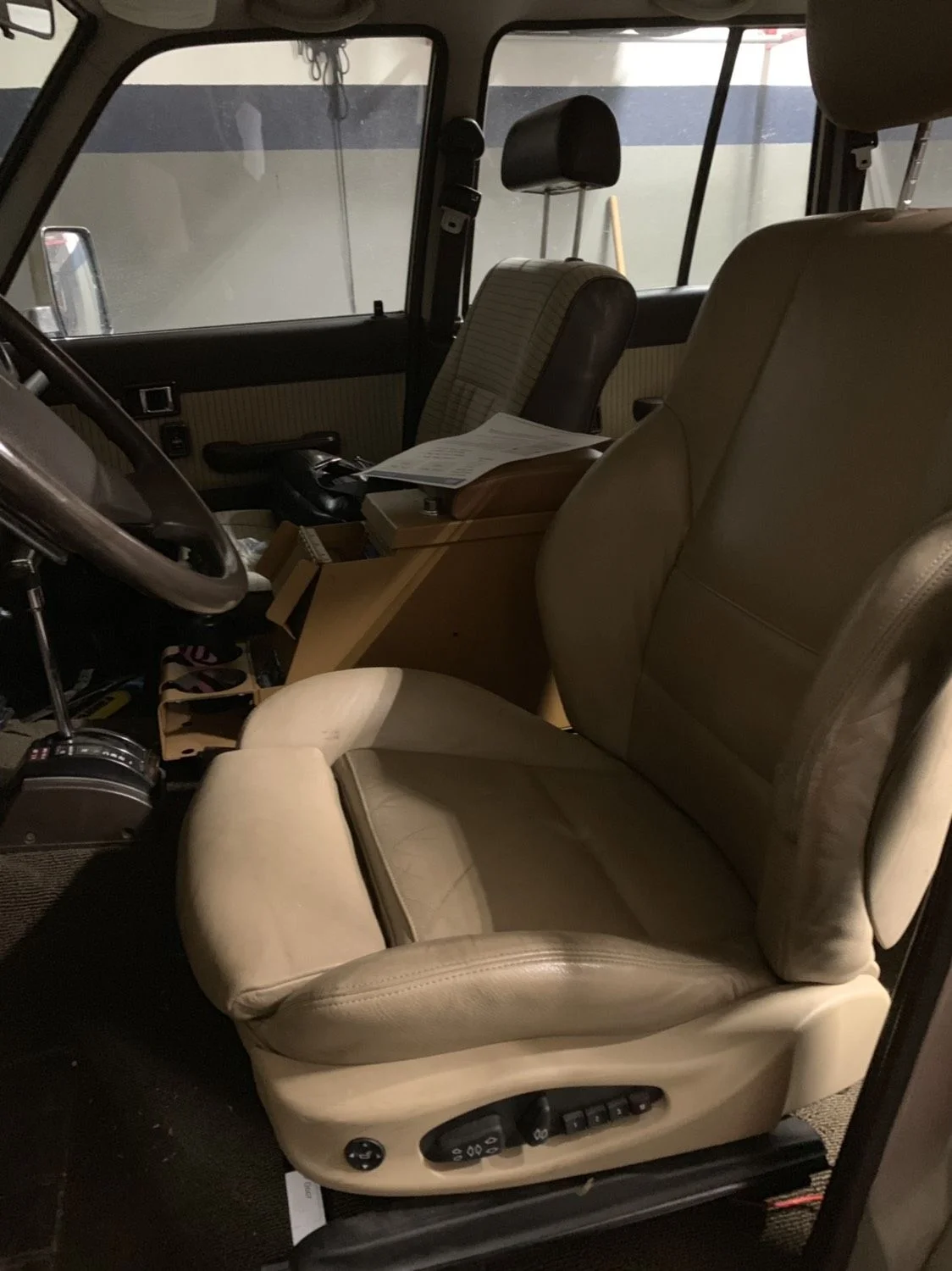

I ran a wire from the battery through the firewall, I’ll have both hooked up tomorrow and I’ll try to get a video uploaded.
Seats are in and power is working. Really great upgrade. Included a picture of the fabric I will be reupholstering the center with and the sample dark brown leather I will be putting on the outer edges of the seats.
I'll be putting this fabric and leather through out the truck, replacing the door cards, rear seats and of the cargo area.
