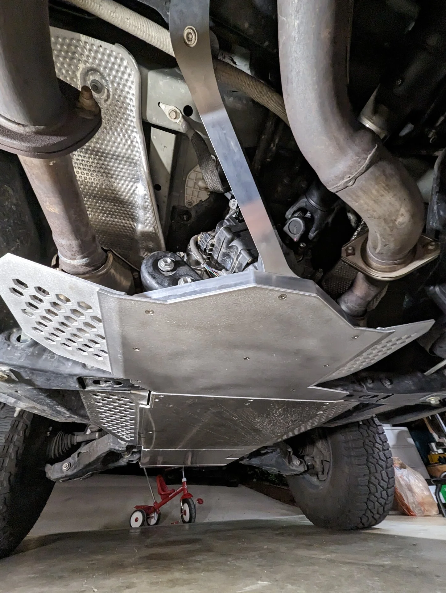

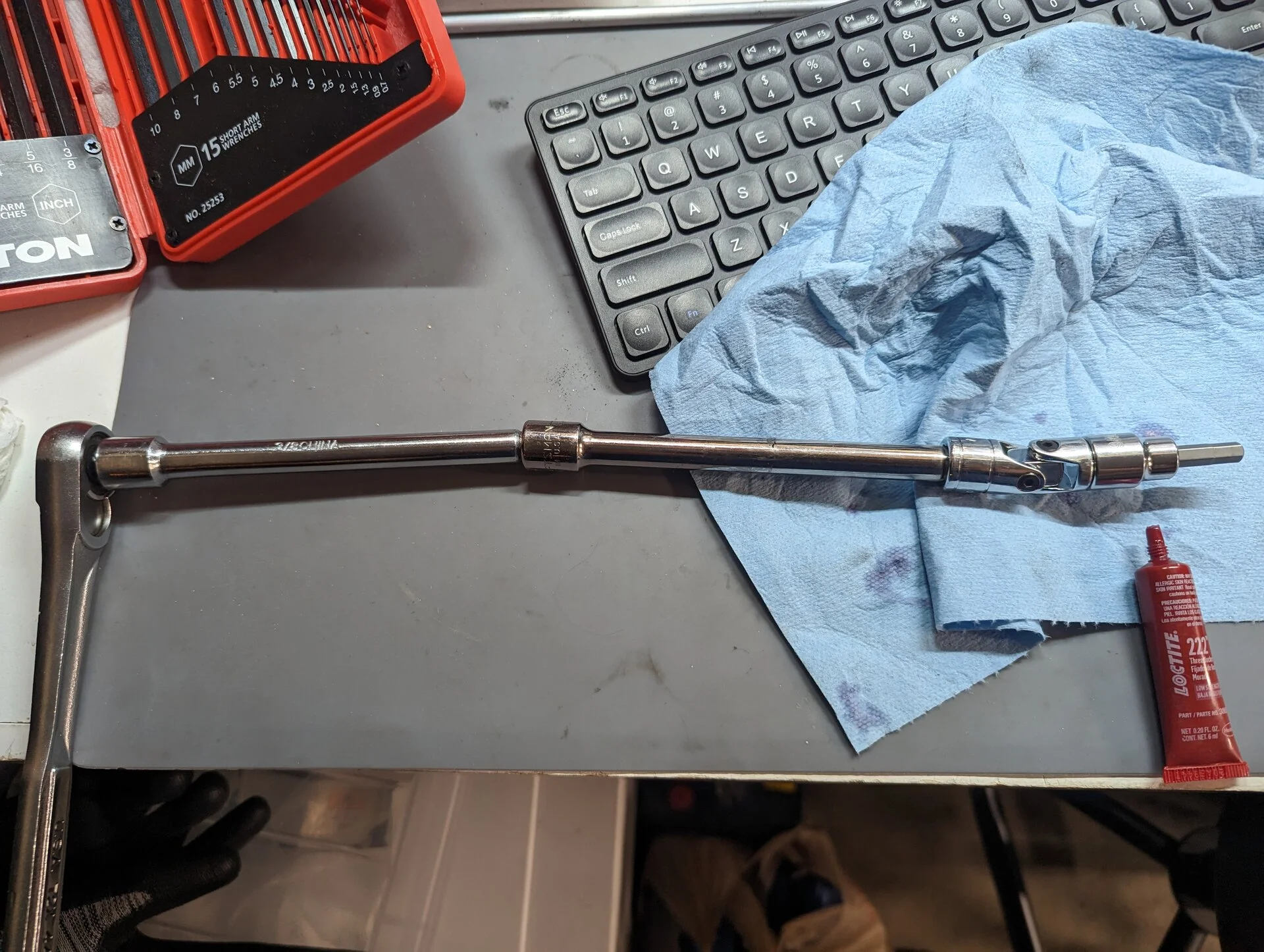

I also completed the TC skid install. I won't go into too much details since @Tex68w did a great write-up already! The TC frame bracket bolts weren't too bad once I got my extensions setup. I did the install in HIGH mode on the LX and for me it was easier to reach for these bolts with my feet facing the front while lying down on my back on a creeper.
Everything lined up great and the frame bracket and leg looks great and strong.

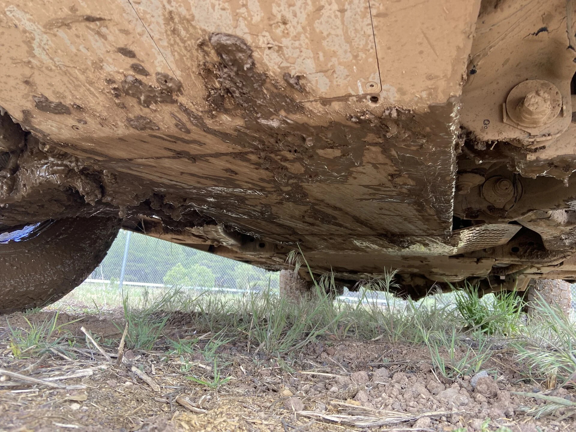

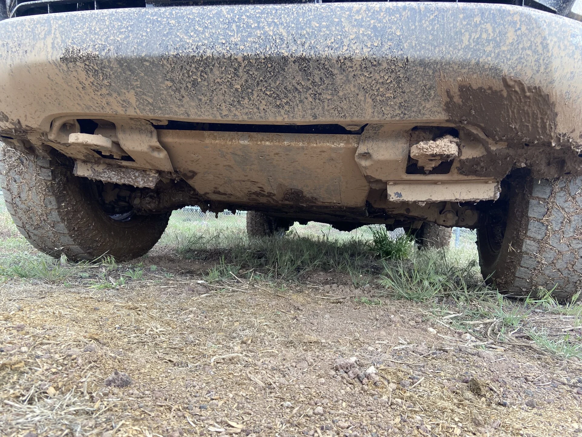

Got my skids muddy and used today at Overland Expo West training.
Nice! Already missing a couple screws I see.
I couldn't put them in after taking off the set once. Believe I may need to retap the screw holes.
No worries. I backed out one insert halfway on the trans skid when installing the transfer case skid. Didn't notice it until the next day because it was dark. Noticed after I took a pic and saw that it wasn't sitting flush in one spot. Because it's the first skid to go on, I had the pleasure of taking all of them back off to fix the insert. Then re- torque every skid screw again. That was fun and time well spent. I need to get a Makita battery powered ratchet to add to my tool set .
Gotta say it looks good though.
Nice to see them getting use!
Defiantly chase\retap M6x1.0 and use a new screw.
