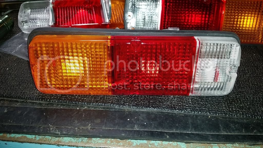

and yes it works, just went out and made the NLA 81550 60192 out of a 81560 60112, I got really confused as I had to many parts open at once, but I just turned the gasket around and used a new lens for the correct side. Oh heck.....I am not really sure what I did.......;)

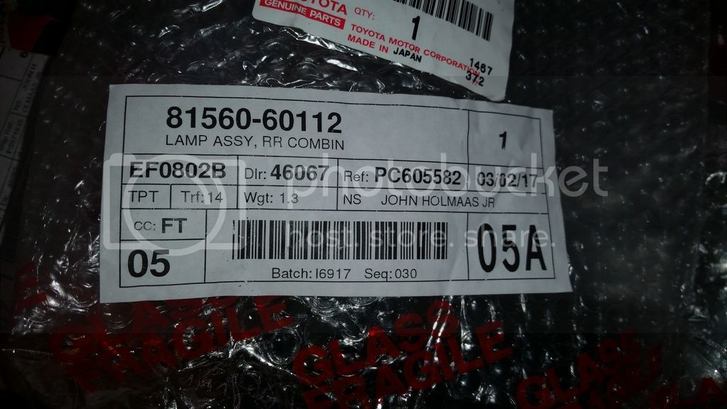

as I mentioned I bought the NLA right side from Roger, today was the 1st time I compared it to the one I got at my dealer(81560 60112, which oddly is marked on the bag from Toyota as Right rear(RR)
the shinny reflector is the one sourced from Toyota USA, the other which is not shinny is the one I got from Roger(81550-60232, which would be 81550 60192 if in US) it also has a built in deflector/reflector that the US part does not have, they both have the shields in the lens

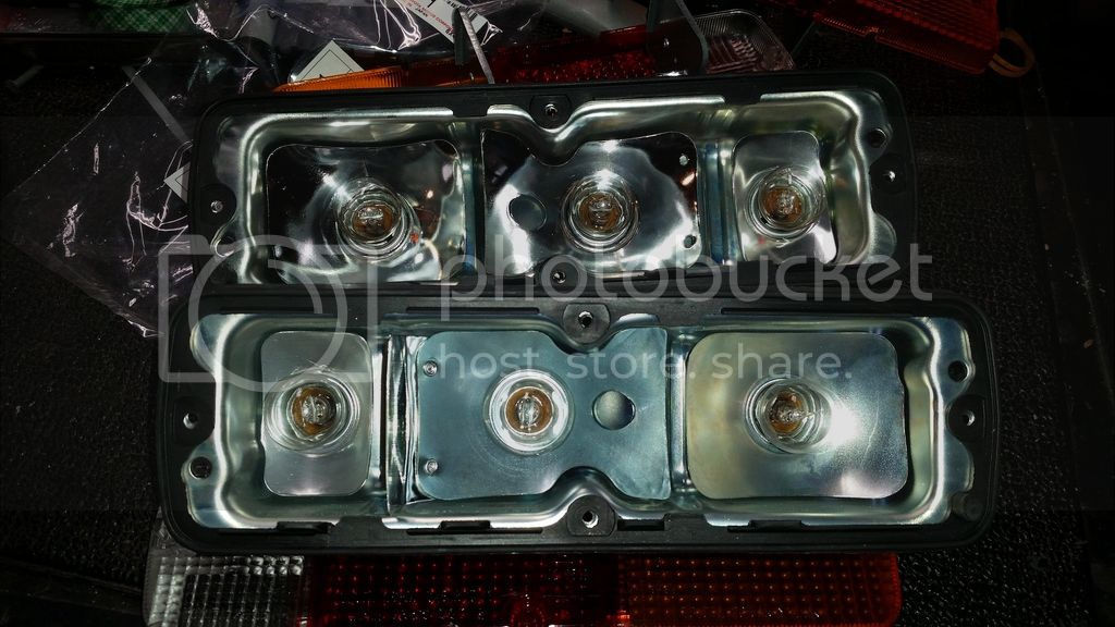

So bulb wattages are different between a 81550-60232 (21W & 21/5W) and say a US Spec 81550-60192 (23W & 23/8W). The lenses have a different OE number (81551-26040 & 81551-60180 respectively) however both supersede to the 81551-35061.
So, it really could have come down to USDOT standards on bulb brightness or similar.
This is the difference in lenses, the gasket is different as well.
