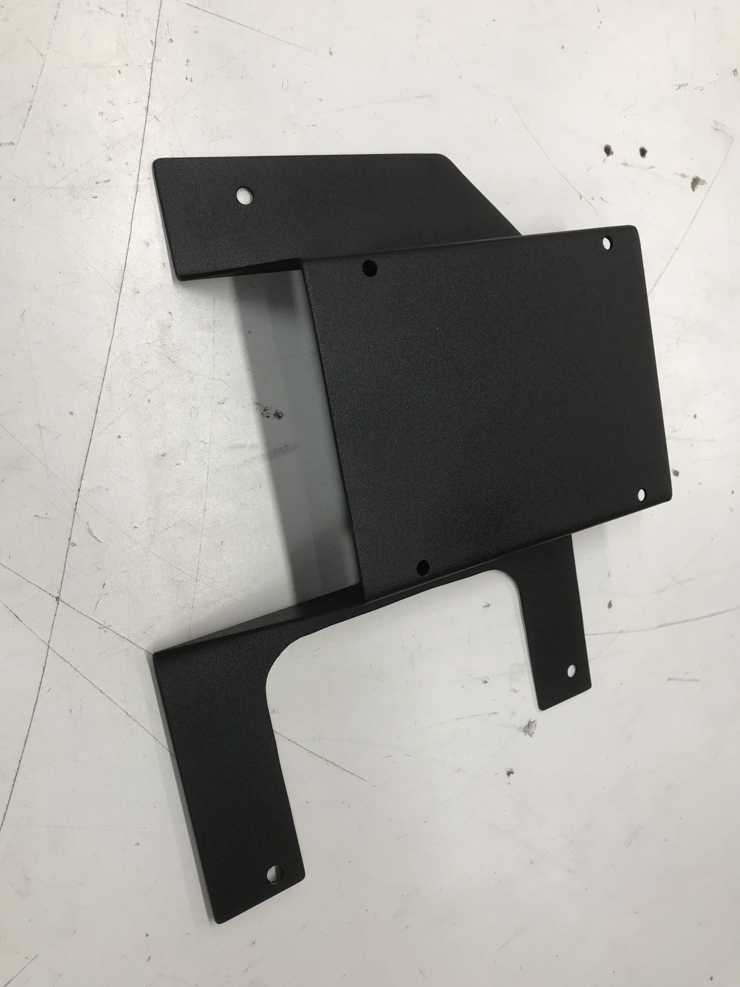

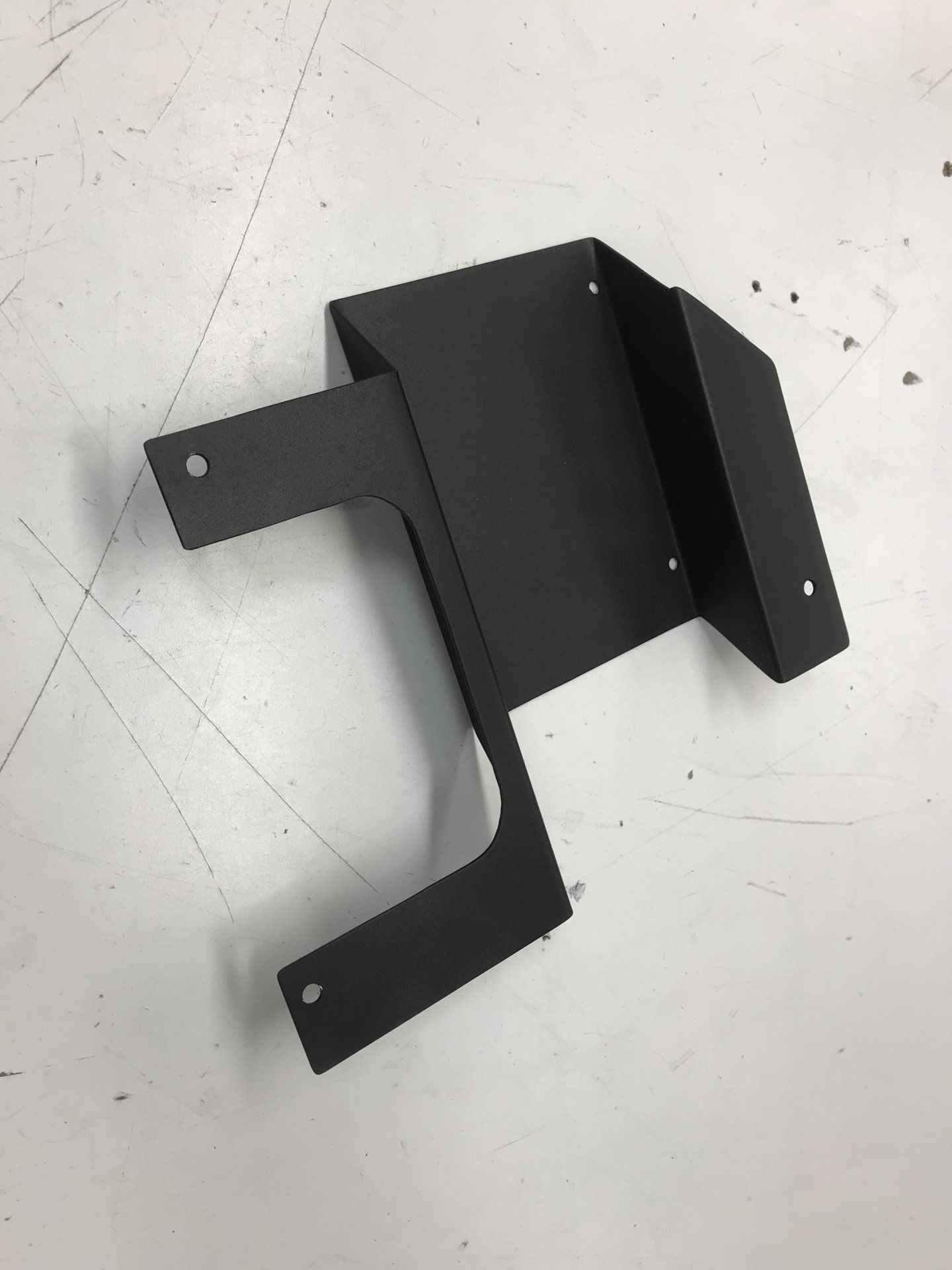

I’m not too worried about it blocking the radiator at this point, but I’m sure you could just as easily mount it sideways or endways if you wanted. There’s a lot of room forward of the radiator. Teaser pics:
View attachment 1889248 View attachment 1889249
Would really like to see that mounted, with the grille out of the way. I'm about to start on the same type of project, but with a dual NOCO battery charger. Plenty of room, but mounting is challenging.
